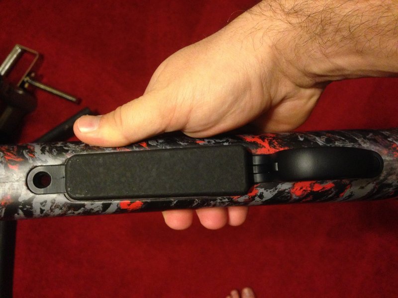

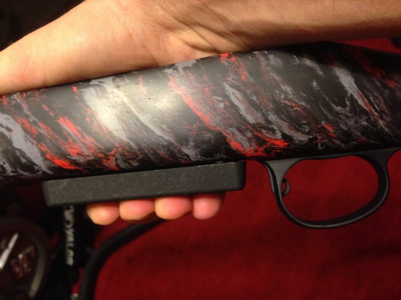

SouthTXBowhunter raises a good point of versatility. Despite having advocated for the BDL previously, I went DBM myself. In addition to Curtis you might look into https://www.stockysstocks.com/h-s-pr...-bdl-only.html
It is a direct replacement to the BDL without inletting, doesn't rattle around and the same bottom metal takes mags for most bolt faces. It would work with PRS and hunting applications due to their wide range of mags. Below is a 300WM 3 round mag on a 28 ounce Mcmillan Game Scout. I like that the release is inside the trigger guard making it less likely to fall out, though Curtis is designed similarly. If you notice on Curtis' website, both the Curtis and HS Precision are not flush mounts for the 300 mag. Both stick down about half an inch.
