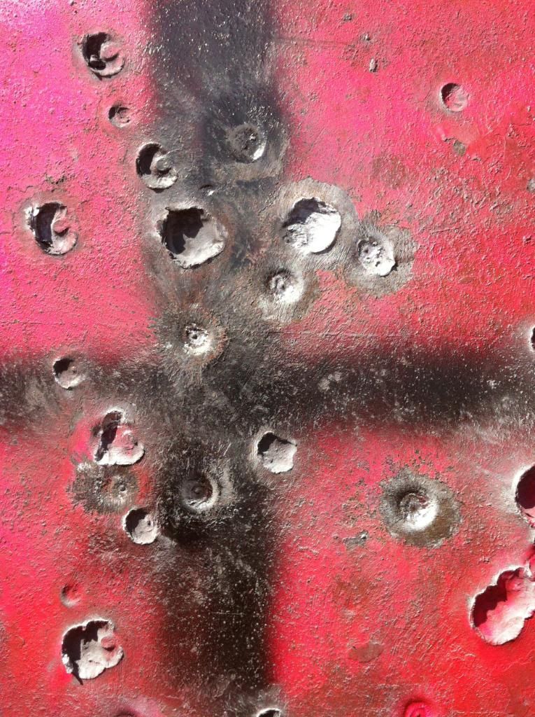

And shot some factory 168 gn Nosler Match rounds at 450 (this is the longest shot I have on my range). 9.0 MOA drop. 4 out of 5 shots were within 3”. .308 rounds are the small marks.
