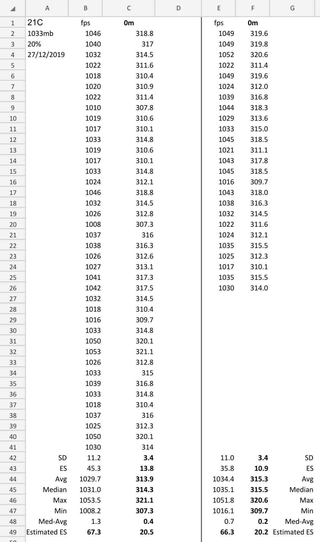

    Been shooting a new CCI SV lot that I bought for €3 ($3.4) a box for some time now and its chrono readings just amaze me. Compared to SK and Lapua lots which I have shot it seems very good.
    Chrono results, please note that without the 2 coldbore shots the first column is exeptionally good also.
    I have confirmed somewhat of a trend using SK ammo that 1st is high, second low fps.
    But it still is, CCI after all.

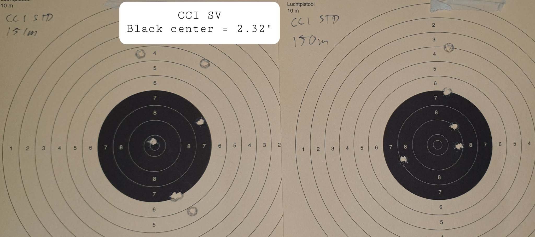

    I tested it at 50m which I do not enjoy so much anymore and it showed much better results than expected. Those moments I was able to focus, I could almost stack them. Few (hah) bad shots ruined the max spread.

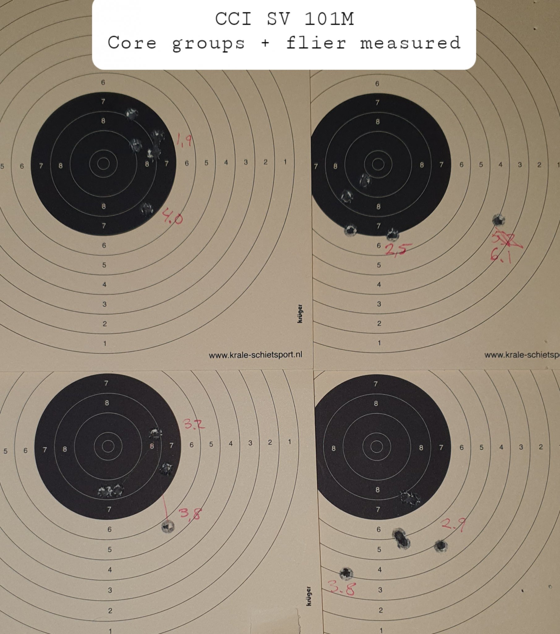

    At 101m: All groups are under 1moa if one shot is taken out. I know, it sounds stupid but it is CCI. I claim none of the fliers mine, which is maybe not completely true..
    At 151m:
    First paper (2moa) is me getting dope and the second is "the group" which is 1moa with 4 closest hits and 1.5moa in total.

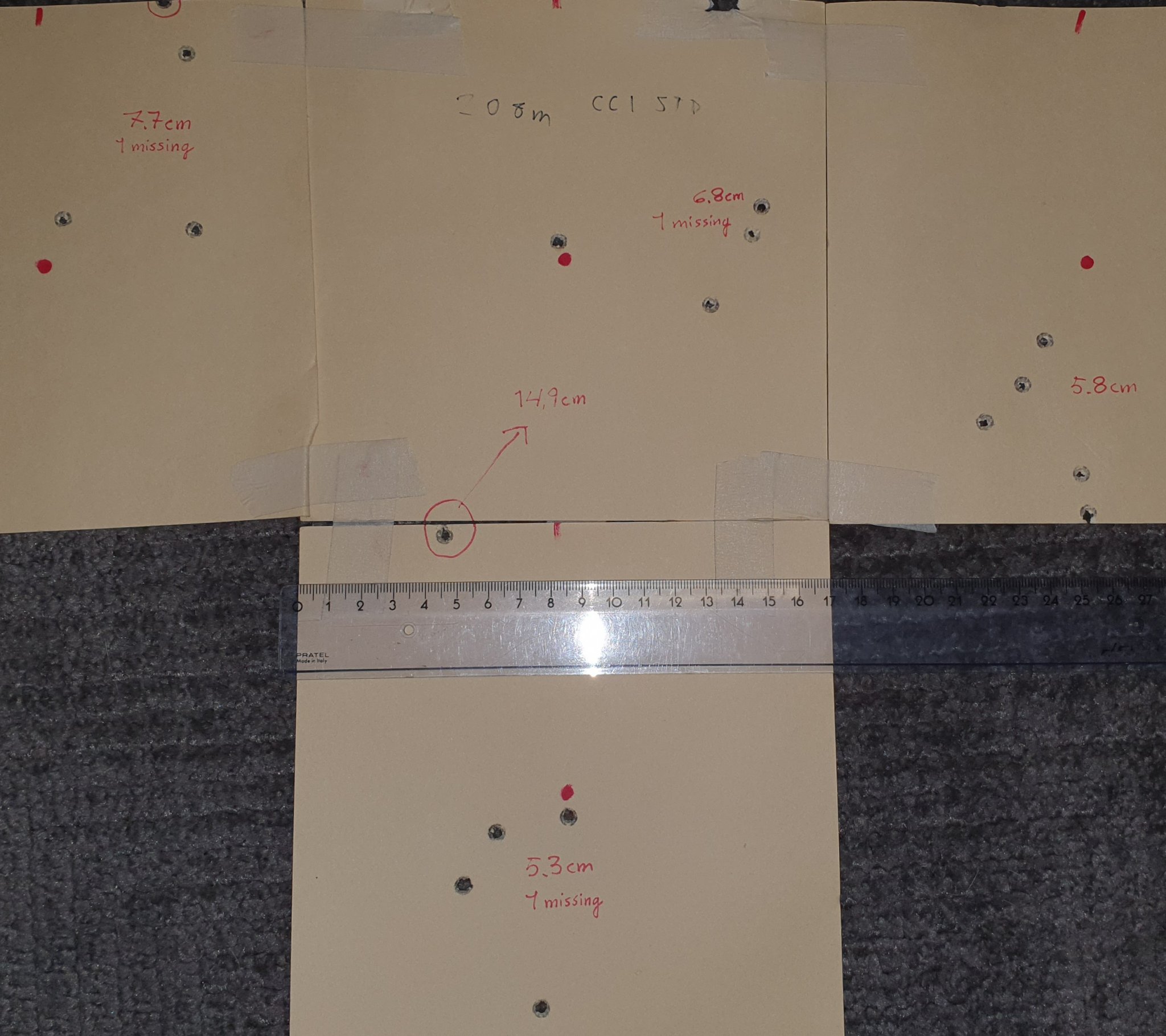

    208m, you know the trend by now..
    4 groups, 2 shots missing.
    The seen groups are
    -left 1.3moa (1 missing)
    -center 1.1moa inner / 2.5moa outer with 1 missing shot found
    -right 1moa
    -lowest is 1moa with one missing. (5,8cm, not 5,3 as written on the target)

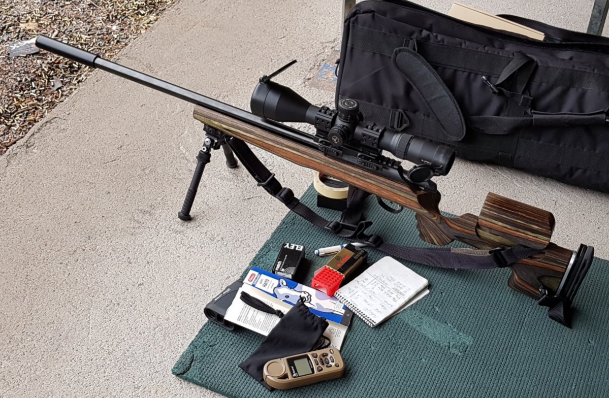

    Sako Quad, 22" factory barrel.
    I have finesanded the barrel inside with extra fine abrasives but not a lot was achieved. Just wanted to make it more shiny when borescoped. Well really I am upgrading the barrel soon probably and want to test different treatments.

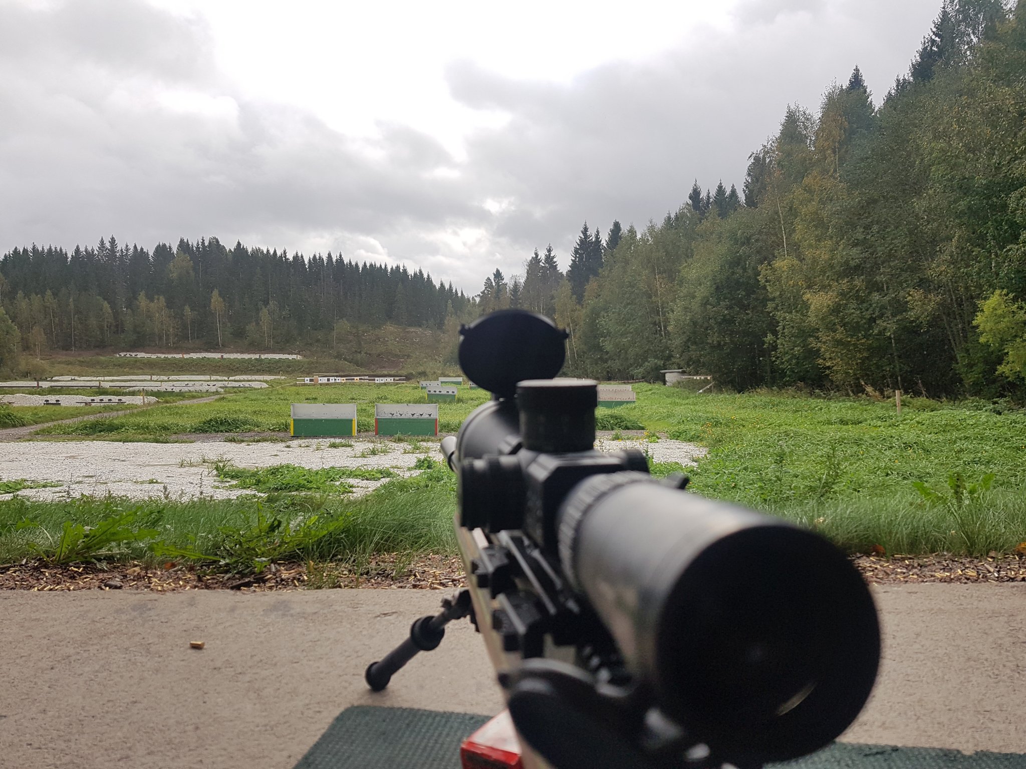

    Here is the range:

    Here is the range:
    Nice range but somebody is gonna have to cut that grass.
    Noo the one or two months in the whole year I get to really see green I do not mind it at all.

    It seems to be the gun that does that variable. It can be seen with other ammo too, like the Biathlon cartridges.
    Although Tenex runs at 1078 and even 1101..
    I have no clear explanation for it.
    Having the chrono tilted would make recorded velocity fall off but I keep it very straight and small changes do not even show up in the data since I shot both 150m and 208m with the same chrono position and same SD/ES still applies, even it is a larger sample.
