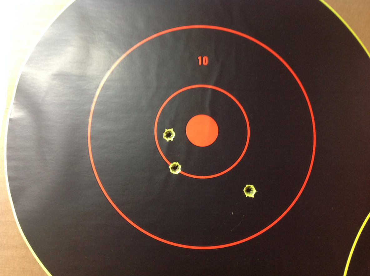

The Result:
I did an OCW test (per John McQuay 8541 Tactical) and ran from 40.0 up to 45 grains and had two good groupings at 41.7 and this one at 43.3.
Included a pic of the best of my 5 shot groups. (Shot prone with bi-pod and rear bag)
For a guy who hadn't fired a gun a year ago, I can't begin to tell you how awesome of a feeling this was.
I'm not sure how much more I can ask from an un-blueprinted 700?
And at 600.
Thanks for all the help gentlemen!
