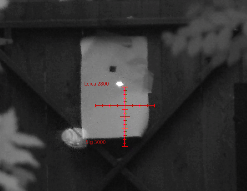

Posted from my early post in another thread:
Below is a screen capture using NV comparing a Leica 2800 to the Sig BDX. The red reticle is SFP on the NV so it is NOT to scale— see, yet another reason not to get SFP.
The black dot is 1.3mil or 1.17” the math worked like this:
1mil at 100y = 3.6”/ .1 = .36 / 1.3mil x .36” or 13x.36”= 4.68” // 4.68 divided by 4 (25yards) = 1.17”
Both units, reticles seemed lined up.
The Leica beam is about 1/2 as tall as it is wide so it helps to know when to turn the unit. Maybe .6 mils vertical
The Sig beam seems to be about 6x larger than the vertical beam of the Leica. And about 3+ times the 1.3mil square or close to 4mils. That’s close to 14 MOA.
We did laze through small loops handheld and in many cases, the Sig had trouble. Sean was better than I was at getting returns with the Sig, but it still was a struggle. I’ll go out in a lime and say that “if” you plan on using these to verify dope on small targets you need to use prudent care to range the foreground and background then the plate to make sure you have the proper return.
FWIW I have about 4250 we can range from my backyard, then a big jump to the mountains we you’d need a V21 type to get a read.
Edited to add: Sig is using some sort of IR receiving gate but the beam is way outside listed size. Interesting note that while it was not my intent to look towards the IR laser, I could easily see the red inside the binos with the naked eye, before quickly closing my eyes and saying something.
