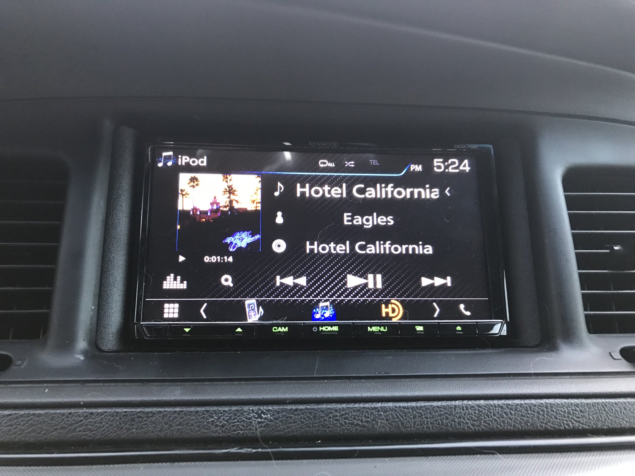

    It all started because I needed to put in a back-up camera in my truck because I can't turn my head so easily these days to see what's in my blind spots....and shit.
    So, I got a Kenwood Excelon DMX709S head unit and installed it, it's capable of running 3 separate camera inputs.

    I've installed a flush mounted USB port from the head unit so I don't have a dangling cord to either connect my cellphone to for Android Auto/Nav, or use for a jump drive filled with audio files.
    I updated the firmware and software in the head unit.

    I'm sorry - but your headunit is by no means " high powered " . No offense. No headunit is.
    Then you know nothing about the Kenwood Excelons.
    A very conservative 20 watts RMS (real RMS) amp section resides within with plenty of headroom, check spewtube or something, more real power than any other head unit I know of.
    It also has 3 sets of 5V outputs.
    It is not a WalMart model.

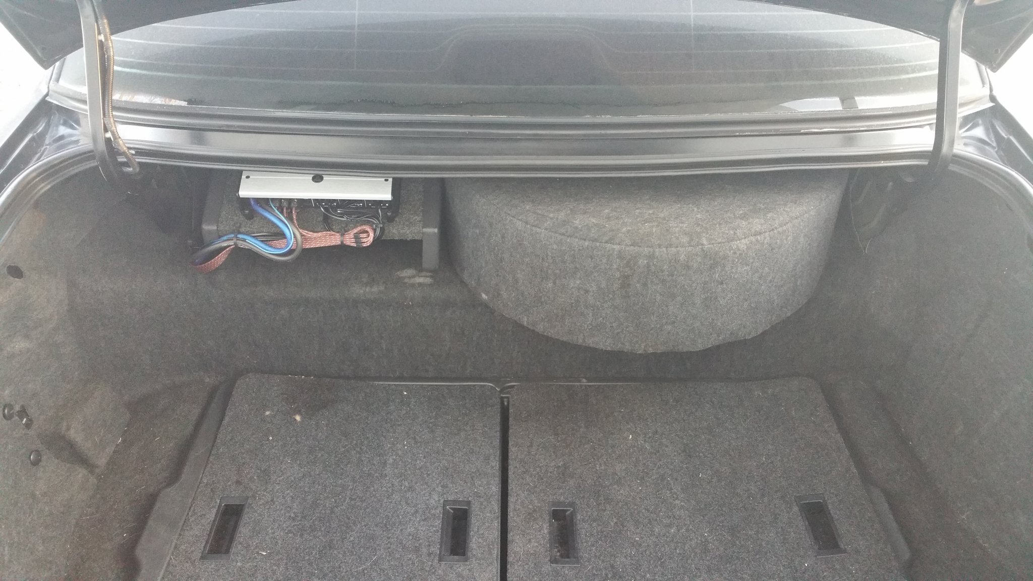

    I have an infinity 125x2 on a pair of audio frog 6.5s, and a JL500/1 on an infinity kappa 10".
    I consider that a "low powered" driving around system at a low cost.
    For wiring I ran 2ga welding cable from Napa. Slightly lower strand count than "car audio" cable, but actually measures true to size. Distribution blocks within 8" of each amp keep the voltage drop basically non-existant. Voltage never bounces like my last truck with a 4ga stereo shop kit.

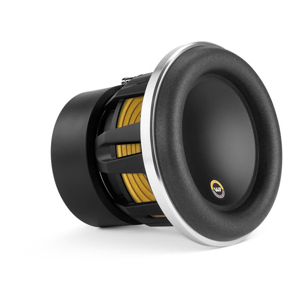

    I agree with you, and I know very little about home audio.
    However, In car audio one JL Audio 8W7 is gonna sound leaps and bounds better than a couple Dayton epique 7 that the op wants.
    30% more excursion, 250% more RMS power capacity.
    But yeah I’m a dual 12s kind of guy myself.
    Their 13w7 actually sounds awesome and smooth with sane power. With stupid power it will rattle your teeth loose.

    The JLw7 series sound phenomenal. Crisp snappy kick with the ability to grunt low and loud. Clarity is fantastic. The Sundown subs seem slightly louder but more muttled

    The thing is, I actually understand the "Thiele-Small" parameters and know how to utilize them.
    The "FS" (or frequency of resonance) on that sub is about 35 hz.....I want, and need something much lower, 28hz or less with a "VAS" of under 30 litres or so. QTS and QMS do not matter to me as they can be manipulated via cabinet design....you can't change the FS or the VAS by trickery.
    2 of those Epique 7" subs will hang with that JL on power all day long, and can use a smaller cabinet, dig ?

    Two 7in subs ain’t hanging with a properly powered JL 13 W 7. No fucking way.
    I didn't say that 2 x $125 subs could hang with a 13" $1800 sub did I ?
    I said 2 x $125 subs could hang with a 8" JL $500 sub....and they can, easily.
    The Morel Ultimo 12" CAN hang with the 13" JL W7.
    But, both take massive amounts of power, both take big bucks, and both take large cabinets to work.
    I would personally take the Peerless XLS 12" over any of them.
    It doesn't take the power levels, but will run flat to ~about~ 15hz in a tiny box....like .6 cu ft which is unheard of for a 12" sub.
    Only problem, they no longer make them.

    I'm currently doing a build on my 2011 Suburban. (OK, I'm currently driving around without a driver's side door panel waiting for the inspiration to get back to my install)
    Kenwood Excelon head unit, the 3 way Infinity Kappa Perfect separates in the front doors, and a 6.5" JL Audio sub in a small sealed enclosure for each rear door, all powered by a single JL Audio Amp. Should sound nice, and I'll keep 100% of all that factory cargo space.
    Did similar with my old Mercury Marauder, only doors, and deck were JL Audio C-3 separates, and the sub was a 10" JL... but again, in a small sealed down firing enclosure, AND in the same spot as the very weak factory sub.
    System hit pretty hard down low, and was very clear for mids & highs. I also kept 100% of the trunk space. I used my trunk for what it was... no opening it to fins some huge ported box taking up all the room.
    From the Marauder...
    Sub enclosure held in place with bolts I welded to the trunk shelf floor. (didn't want to risk drilling through the gas tank)
