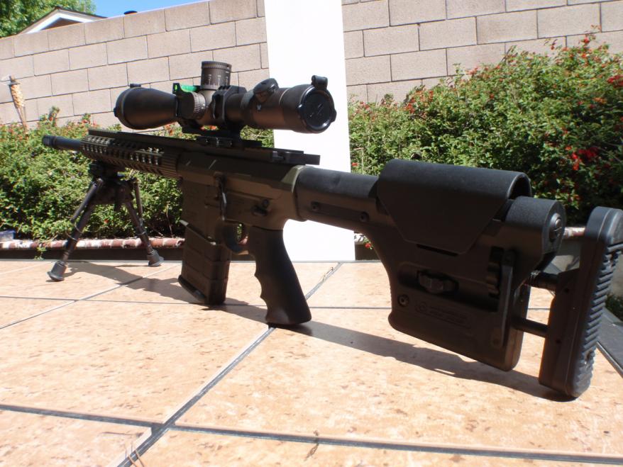

I installed a Vortex Razor on my .308 gas gun along with a ADM 20 MOA scope mount. Its really nice. Honestly, there is SOOOO much adjustment in the scopes erector that there is no need for 20 MOA. With my scope zeroed at 100 yards, I still have 26 MILS of UP adjustment. There is one small advantage of the canted scope mount and that is it raises the back of the scope up a little giving slightly more room to get to your charging handle. Anyways, Check out the ADM mounts, they are really nice.

First day out with my Razor/AADMount combo, liking it a lot so far. Very sturdy, same torx wrench for rings and mount - stows in grip, excellent height (1.45), 20MOA built in, bubble level is not very usable with BUIS installed but oh well - vortex includes the one pictured with the scope anyhow.
P.S. For those wondering why I set up the scope and mount the way I did - By moving the base back and the scope forward in the rings you can get decent eye relief on a .308 AR while preserving the option to move it onto a standard AR. I spent a good deal of time playing with the assembly on my SR-25 and MK12SPR side by side to come up with the perfect arrangement. On the MK12 the combo mounts all the way forward on the receiver.
