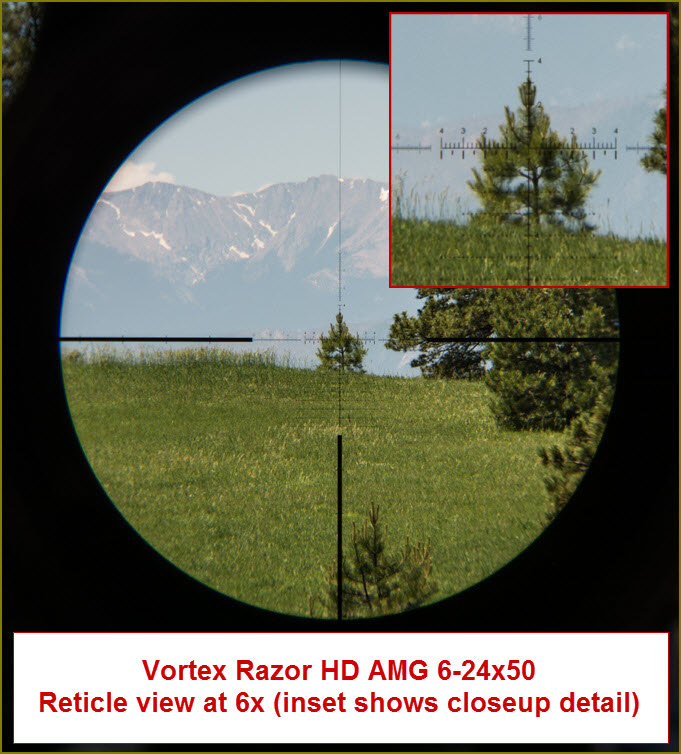

    The main issue with FFP scopes is reticle thickness. Manufacturers shouldn’t be worried about making a reticle too thick for hunting. It would be nearly impossible within reason. Make a .06 or .07 mil thick reticle. There is no need for fancy reticles. They just need to be thicker and I would be all in.

    What do you plan on shooting at 6x that you don't think you'll see with the EBR-7 reticle? Even in this dark tree I was able to see the center cross pretty easily at 6x. Illumination does help but I don't feel with the AMG is necessary, the AMG and EBR-7 is one of the better reticles for FFP at low magnification.
    Are you talking about that single tree in bright daylight? ? The smaller pic to the side is not comparable to what is seen with the eye as it is enhanced by being blown up in the photo.
    You can’t argue with me on the facts such as that reticle on that scope at 6x is considerably thinner and smaller than traditional hunting scopes which make the reticle harder to see and slower to be picked up in good light and worse yet in bad lighing (when and where most people hunt ). This is not debatable as its truth.
    Now you can argue that it is good enough for you or that you like it better. That comes down to personal opinion and I would never say you are wrong there as people have differing opinions and needs. Everything is a compromise. Seems like we both know what we like and thats fine.
    Edited to add: i have used FFP scopes and hunted successfully as many others have. I have also done the same with SFP scopes and for my style, SFP is better for me when purely hunting. A thicker illuminated FFP scope is also serviceable for my needs. I apologize OP for throwing your thread off topic.
    That was just an image I took to provide an example, the reticle is actually more prominent to my eye than it is through the image. Scopes with much higher magnification erector typically fair much worse than the AMG, take for example the March 3-24x52 with the FML-1 and try and see the reticle center at 3x, this is where FFP reticles really struggle, not so much with the 4x erector and even many 5x erector scopes. Comparing FFP reticles to SFP reticles is apples to oranges, I didn't realize that is what you were thinking. If you are unable to use a FFP reticle at low mag than don't use it, but to tell others
    I think the AMG reticle would hold you back. Its thin and busy. A hunting reticle it is not. I’ve sold several and would never consider the scope for hunting use.
    is a bit presumptuous to think that just because you cannot use it means nobody else can (or should). Many shooters, and dare I say hunters, have come to "see the light" of FFP optics and while they may not have as thick of reticle for low mag shooting, it is rare that I hunt (or rather take the shot) at the lowest mag setting of a given scope - I typically spot with another optic, setup my rifle, start at low mag to gain visual awareness and then zoom in to an appropriate level based on conditions to take the shot, rarely do I find myself in situations where I am needing to take the shot at low mags, but in fairness my hunting is done for big game here in Colorado which may be very different from the type of hunting you or others do. SFP scopes really struggle with being able to hold for wind which is how I do most of my shooting, with SFP even with a mil/moa reticle you still have to be fixed at a certain magnification (usually the max) which I find even more constrictive than the size of the reticle, if your magnification is off from what is calibrated on the reticle then your shot will be off, with FFP your hold value will always be the same regardless of magnification. For a FFP scope, the AMG and EBR-7 series reticles actually perform very well through the mag range of the scope, even at 6x and present one of the better FFP scopes for hunters.

    If you are unable to use a FFP reticle at low mag than don't use it, but to tell others is a bit presumptuous to think that just because you cannot use it means nobody else can (or should).
    I never said that I couldn't use a FFP reticle at low mag. I said that it isn't ideal (opinion) and is tougher to see in low light conditions (fact). Everything is a compromise such in my examples and such as the examples you gave. I also didn't say that nobody else shouldn't use the scope for hunting purposes. In fact I said that it comes down to personal opinion as I understand that people have different needs and that I would never tell someone they are wrong when having differing opinions than me.
    It kind of seems like you are arguing with yourself since I neither said or insinuated anything that you accused me of and in fact stated the opposite. Good grief

    What you write above is different from what you wrote earlier, this is what you wrote earlier:
    That is what I'm basing my rebuttal on, I am not arguing with myself, I am disagreeing with your premise that the AMG "will hold you back" that the EBR-7 reticle is "thin and busy", that the EBR-7 "a hunting reticle it is not" or that the AMG is a scope that someone should "never consider for hunting use". We can agree to disagree, but you are trying to influence others to not use the AMG for hunting by your comments and I'm simply giving an alternative to that way of thinking.
