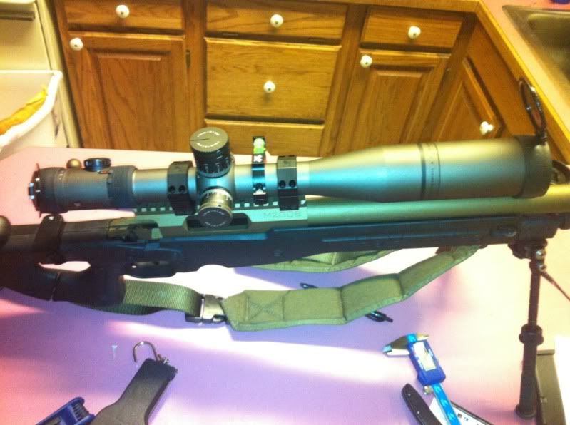

What sort of rail on the rifle? I am running Vortex precision rings which I beleive are made by Seekins on my badger M2008 with Vortex razor I am using the .96 low rings and they are as short as I could possibly go I have maybe a 1/16-1/8th" of clearance on the scope bell to my barrel but I have a very heavy tapor barrel and my rail is relatively high. Looking at your rifle it looks like the short scope mounting rails might require a slightly higher set of rings. You can find all he dimensions on the scope on vortex's site and then take some measurements on your gun to get the exact dimensions.
Here is a picture of my vortex mounted up using the vortex precision lower rings:
