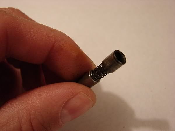

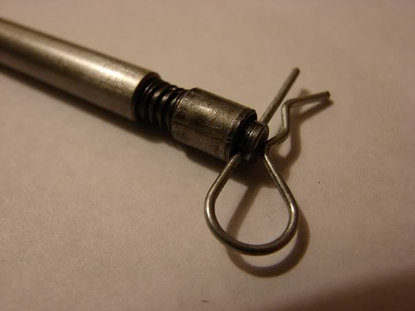

This is embarrassing, I can't figure out how to put the primer rod assembly together. The picture in the instructions sucks and I just can't figure it out. Can anyone put it into simple terms for me? Thanks
Re: RCBS bench mounted priming tool - need help
Hope this is what you are looking for!
<div class="ubbcode-block"><div class="ubbcode-header">Originally Posted By: suasponte</div><div class="ubbcode-body">
Terry </div></div>
Thank you, thank you, thank you!!
