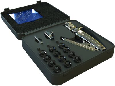

I've got the FA Perfect Seat set (see pic below) and it works just fine, but not as consistent as my 21st Century hand primer, and . . . it's not as easy on my old hand as the 21st Century. The leverage on the 21st Century is such that it's really easy on the hands when doing a lot of priming. So, though the FA has a trey to hold a number of primers for seating (trey saves a little time), it's just sitting on the shelf and I should just sell it since I just don't use it.
These days, I like to use my Lee ACP which works the best for me. I keep my 21st Century as a backup or for use whenever I'm not do the work at a bench. The ACP is hard to find now as Lee doesn't make it any more. Though Lee's APP press works very much the same way and can be easily modified for adjusting seating depths.
