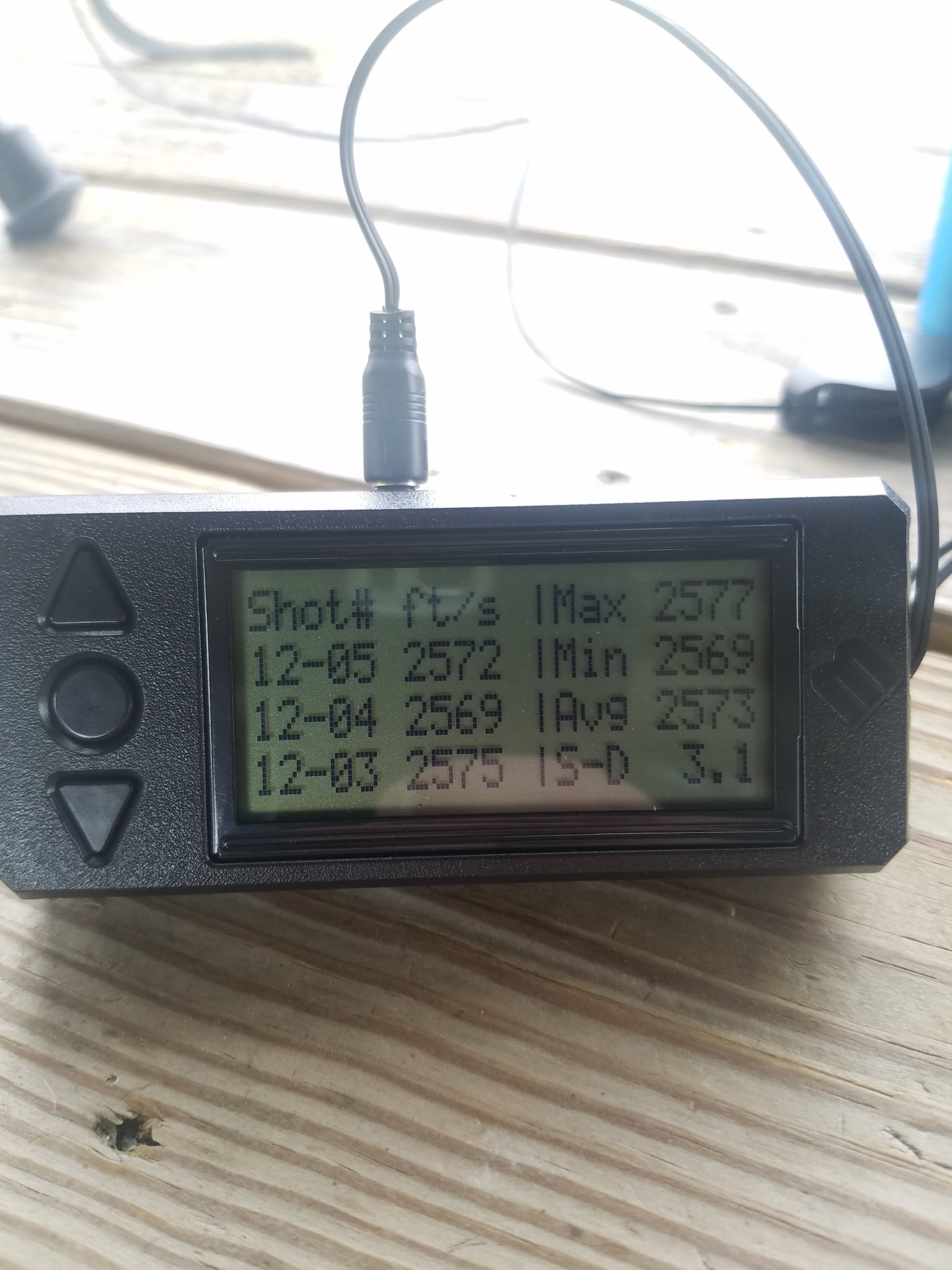

    I have both. I like them both. Doing a little more testing the Lite vs the CM1500. So far with a couple of loads I have compared to, the Lite will throw a little more accurate then the CM1500. Or at least on the Magnetospeed it shows. Right now it's about 3-4FPS difference in SD.
