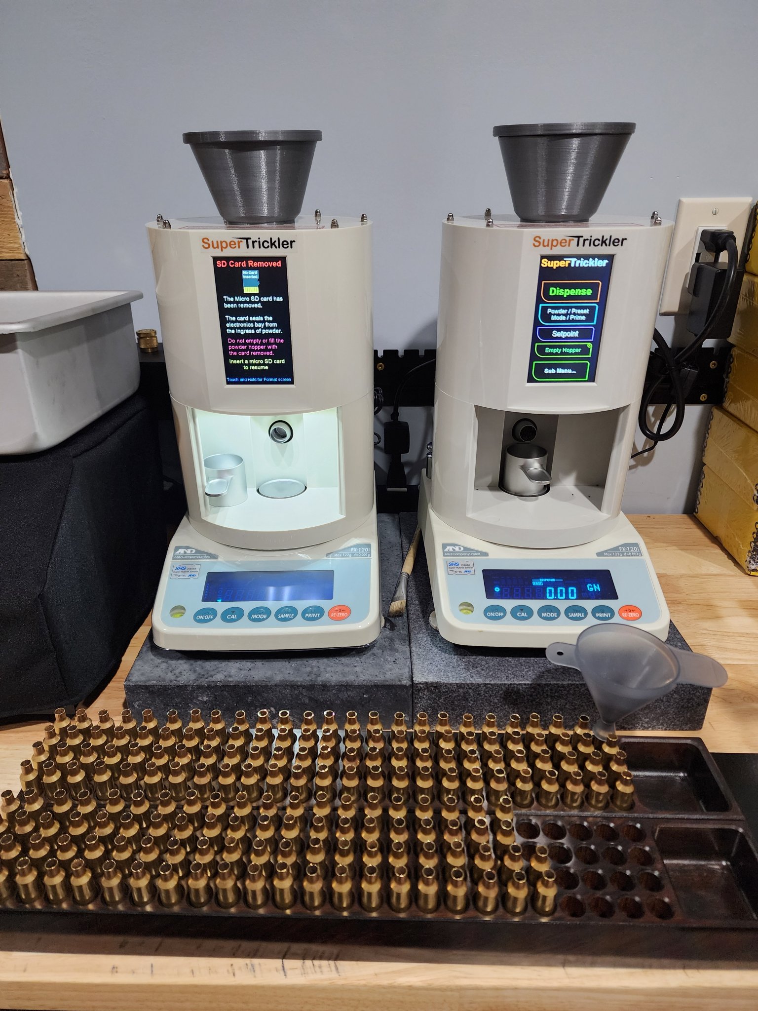

Just about anyone serious in precision shooting is using an AT, ST or Prometheus. The RCBS is junk in comparison and most of us have gone through a bunch of them. They are cheap Chinese produced unreliable throwers and scales. You can't trust what the scales read and they drift like crazy.
Right now a AT3 with ingenuity trickler will throw an accurate charge to .04 grains in less than 10 seconds. My ST will do the same with about a 90% success rate in about 12 seconds. Run 2 or 3 and you never have to stop dumping powder.
