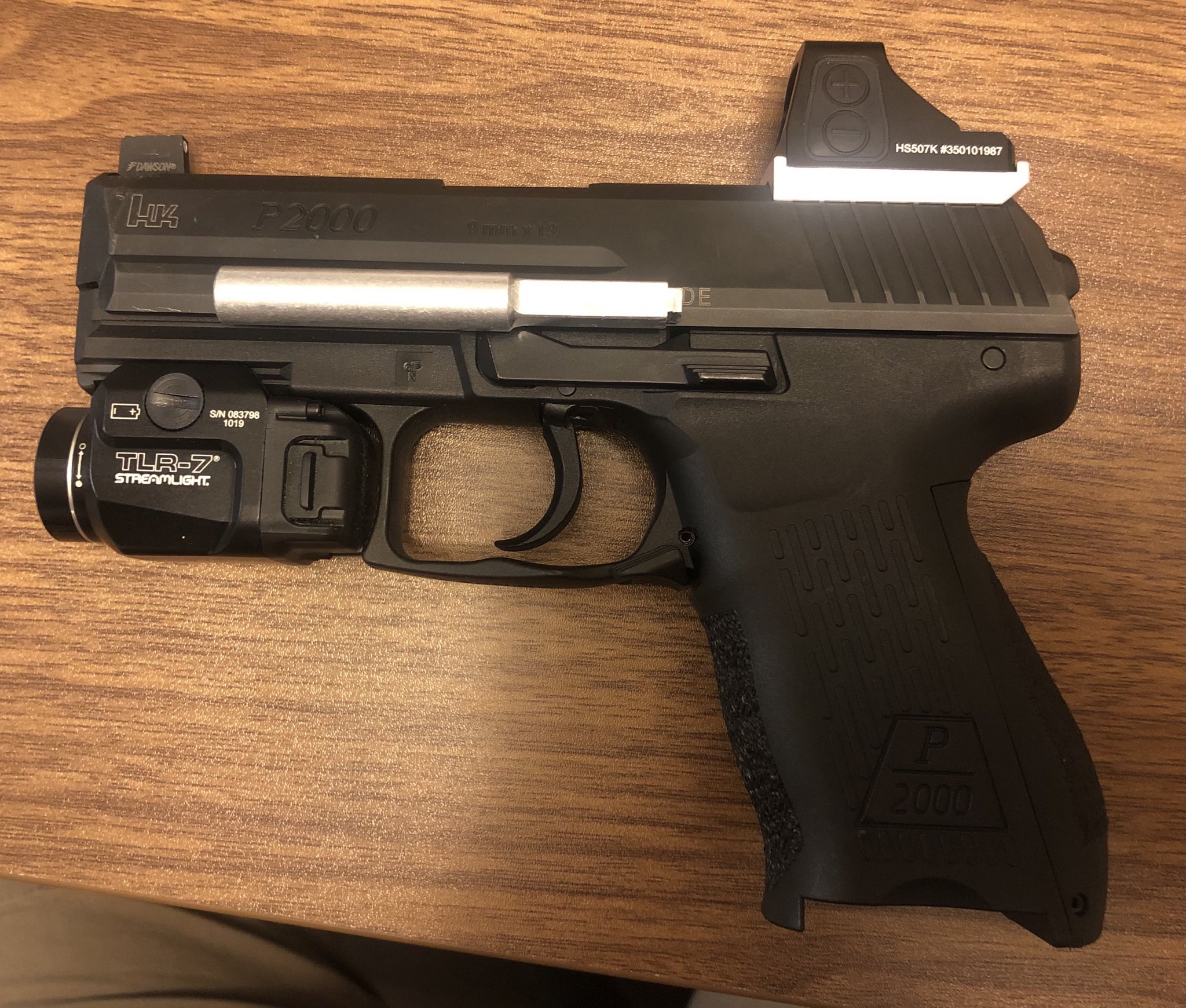

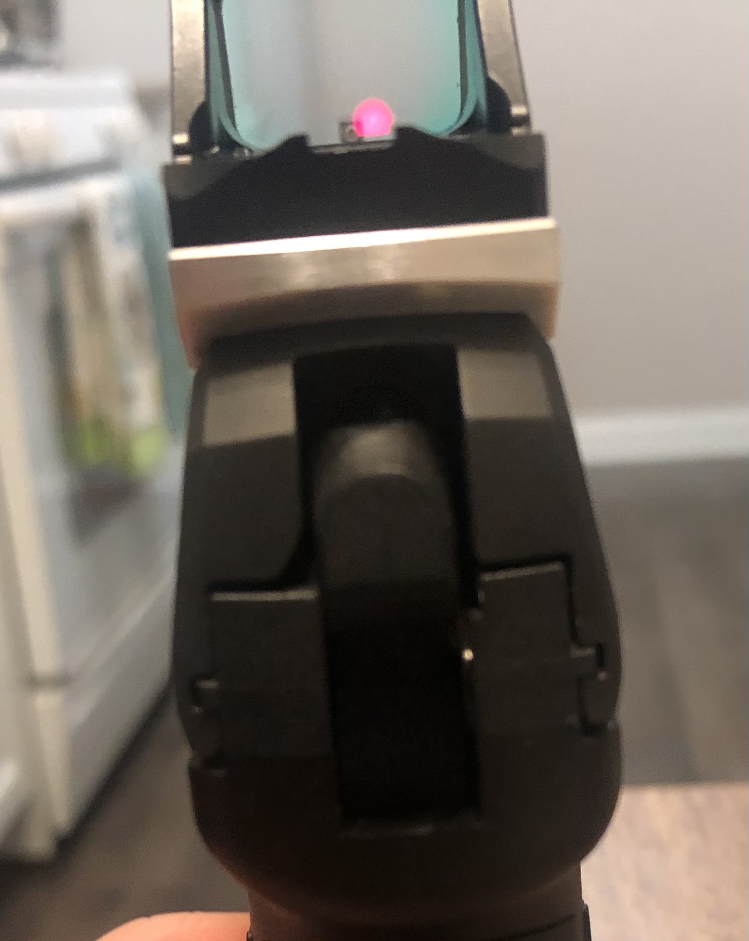

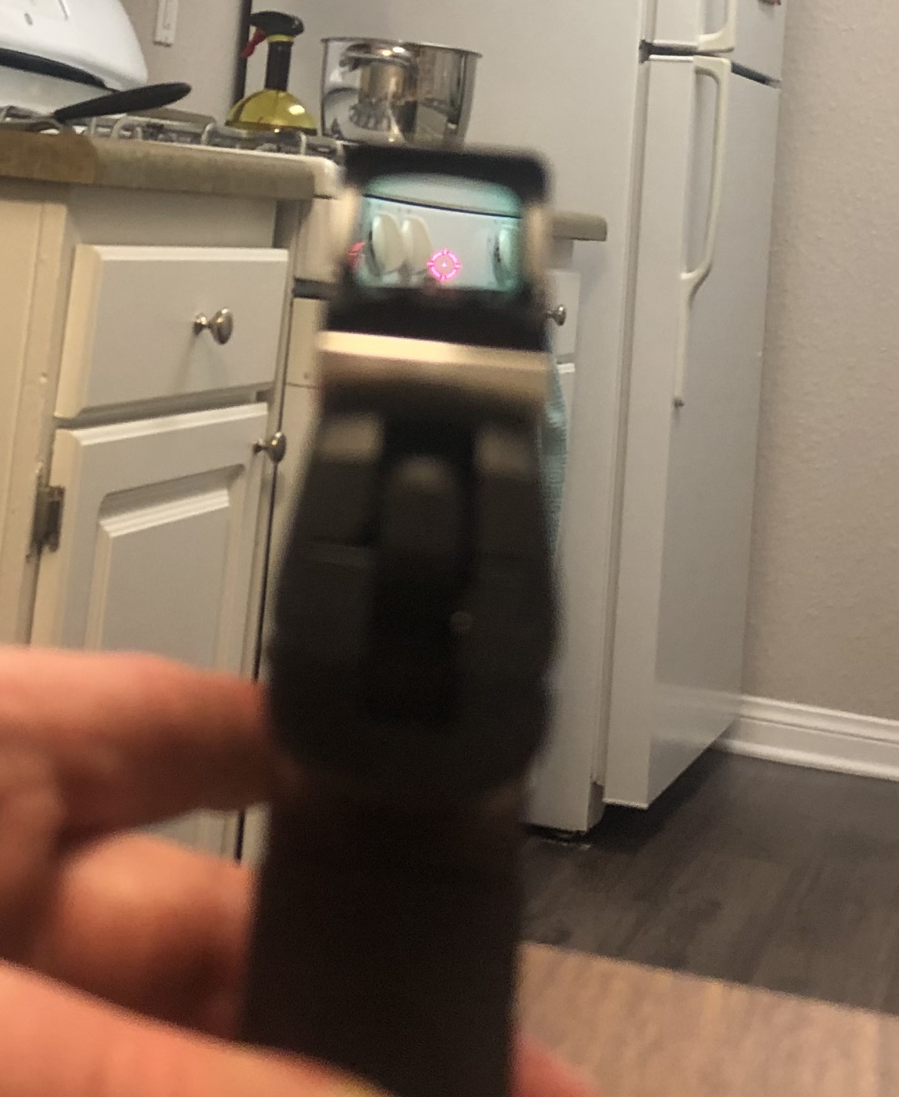

So, California sucks for gun stuff. We all know that. Rather than doing the reasonable thing and buying a Glock, RMR-cut slide, and RMR or equivalent, I decided to buy a Holosun 507K - narrower stack, has a rear notch for a backup sight - and make my own damn mount. I also snagged a suppressor-height (0.365”) VP9 front sight from Dawson Precision to go with said notch as a backup.
I got said own damn mount today and the front sight yesterday, and haven’t sighted anything in yet, but here’s how it turned out!
Reactions: geek65
Nice workaround. Let us know how it works.
Red dots on pistols take some getting used to but I’m getting lots of draw-and-dryfire practice into a mirror which helps. Zeroing was a bit finicky - my barrel/slide alignment shoots way left - and I’m almost out of travel, but the dot is so easy to use. The mount is still very secure after ~200rd. Cycling works fine even if I’m holding the gun awkwardly.

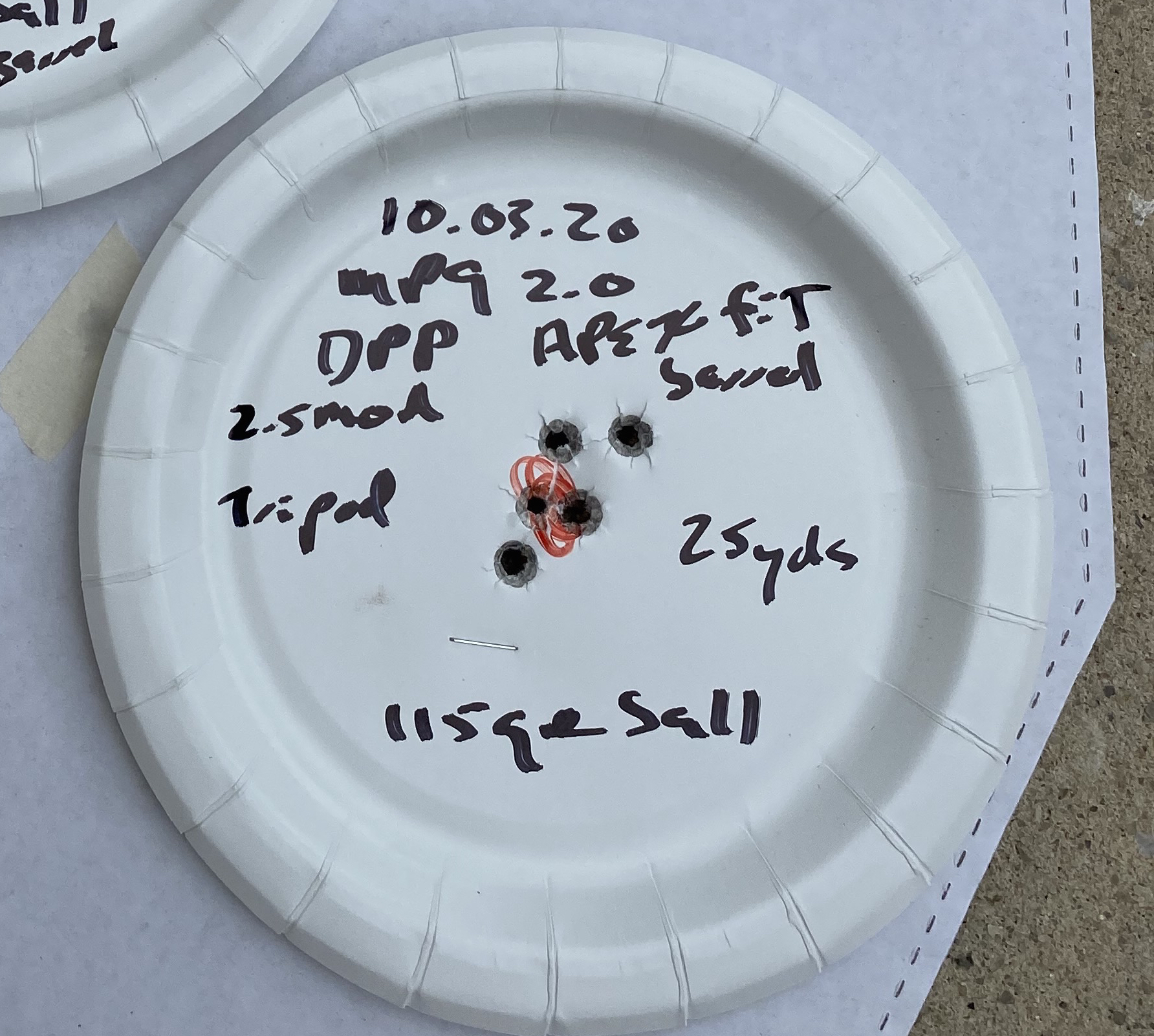

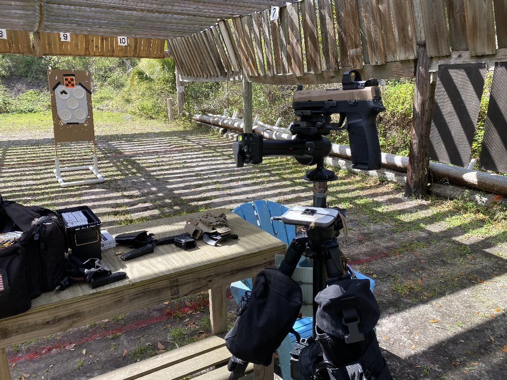

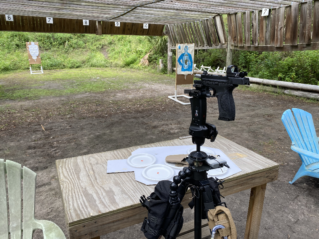

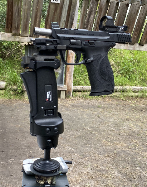

I like to zero my pistol optics with a tripod, what's good for the goose is good for the gander and much easier than toting a Manson rest to the range!

Leupold Delta Point Pro #2 FOP Range Zero 25 Yards Tripod 10.04.20 cropped IMG_6643.jpg

Leupold Delta Point Pro #2 FOP Range Zero with Tripod Picattiny Mount 03.08.20IMG_5012 copyE.jpg

I just adapted a LaRue QD picatinny mount to the usual mounting plate for the Manfrotto.
Smith & Wesson M&P9 2.0  Apex Fit Barrel Leupold DeltaPoint Pro Target Zero 25 Yards v. Sig P3...jpg
