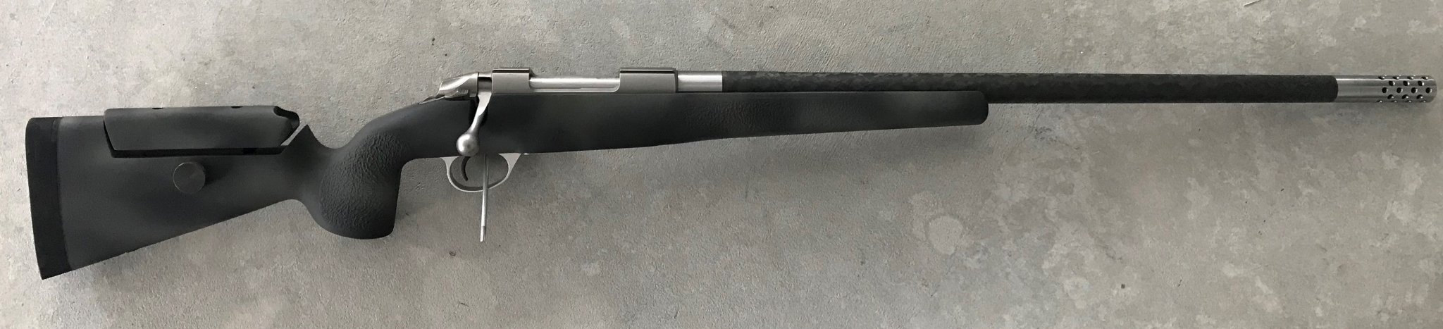

Welp - I just wasn't sure about trying to fit the mag to a longer cartridge. I looked again at ballistics for both 6.5 prc and 300 wsm at about 800 yds, and decided to stay with the 300 wsm. Rocky's Gun Works in Montana just finished the Proof barrel.
This rifle started out as a Finnlight, now it's a Finnotsolight. The 24" carbon barrel/brake at 2 lb 13 oz is 10 oz more than the 24" 2 lb 3 oz fluted Finnlight barrel. The adjustable McMillan stock at 2 lb 8 oz adds 13 oz over the 1 lb 11 oz Finnlight stock.
Looking forward to seeing how is shoots . . . .
