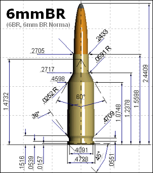

I currently have a Remington 700 that came from the factory chambered in .223 Rem. I am hoping to rebarrel it into a 6mmBR. Is this a possible conversion since the .223 action isn't as long as the normal short action? Or should I be looking to another caliber for this conversion? My end goal is to push Nosler 105gr RDF bullets with this rifle.

What you may have an issue with is the bolt face diameter. I think 6mmBR uses a .473 bolt face.

bolt face on the 6BR is different than 223 tho
Internal box mag has a spacer added to the 223 also the spring and follower are fit for the smaller 223rounds in a short action. Bolt face is the bigger issue.

You can either have the bolt face opened up or buy another bolt and send it with the gun when it gets re-barreled.

I did exactly what you're asking... I took a Rem 700 in 223 and converted it to a 6 Norma BR. Smith swapped out a the bolt with a .473, re-barreled and off to the races. I opted to use bottom metal that accepts AICS mags. Converted the mags using the Primal Rights conversion kit. It takes 308 AICS mags and lets you run 6BR smoothly through them. I'm only 100+ rounds in, but everything is running 100% so far. Accuracy is excellent :)
