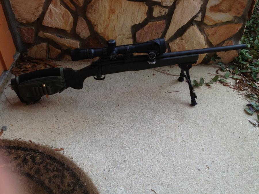

My wife had been tagging along with me at the range for quite a while and decided she wanted her own rifle. She settled on the Remington 700 AAC-SD because she liked the feel of the Hogue over-mold stock. Unfortunately, the very stock that was the selling point for her is also the rifles greatest flaw. When using a bipod the stock firmly press against the barrel causing huge accuracy problems. I was getting 4" groups at 100m using 175 gr Federal Gold Medal Match. I hit the web for a low cost alternative to the Hogue and found Lonewolfe's video in which he recommends the Bell and Carlson m40 stock. I gave the B&C m40 a go due to the low cost, aluminum bedding and most importantly my wife liked the color:) . My groups went from 4.0" to 0.5" using the same 175 gr Federal Gold Medal Match! I also added the Triad Stock Pack, and replaced the Xmark trigger with a Timney 510. I added the stock pack just to give her a means of adjusting her cheek weld. I put a quick video together that shows the results from my 100m zero and shooting steel at 500, 600, and 900 meters.

Yah I guess its just "luck of the draw" in regards to the stock. I went to the local gun store a couple weeks ago and he had two AAC-SD's, one sitting on the counter with a scope and bipod, the other up on the rack. The stock on the rifle sitting on the counter had the same problem as mine. I checked out the other rifle on the rack and their was no contact between the barrel and stock. I feel bad for whoever buys the rifle sitting on the counter.
