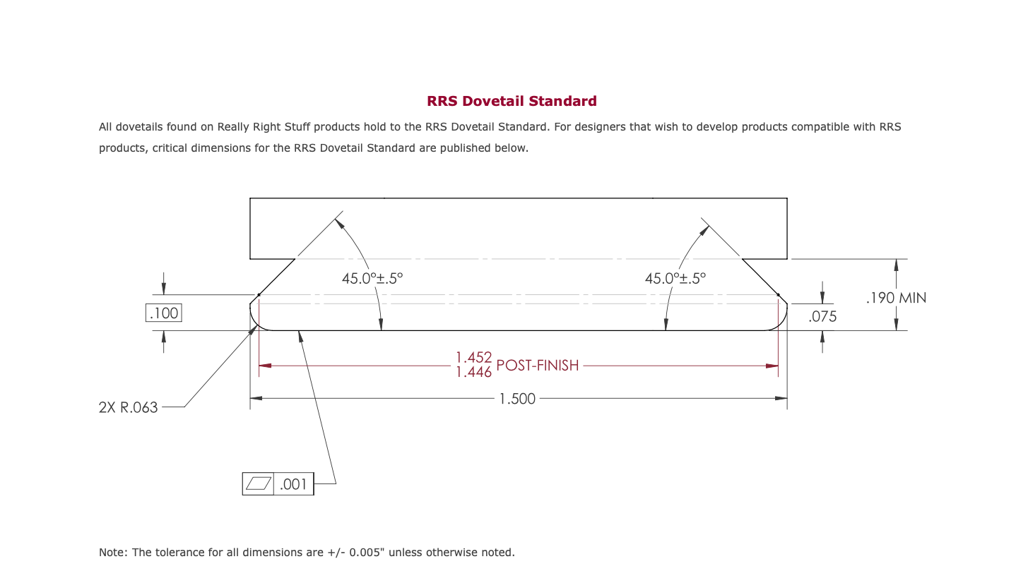

So for accessory cross compatibility, is it Arca Accessories fit RRS dovetails or the other way around? I know that RRS=RRS and ARCA=ARCA, but I also thought one of the two clamps fit (workable fit not perfect) the other rail.
The mfgrs seem to be at a "BluRay vs HD DVD" moment where some of each product are on the market. Like 419 has the ArcaLock which (I think?) I based on the ARCA Swiss but their lever works on either?
Any clarity you can put up on this would be helpful!

Exactly why I asked; lots of products hit the market with various versions of compatibility due to wrong spec or naming. Good to know! RRS it is!

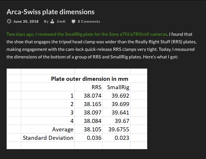

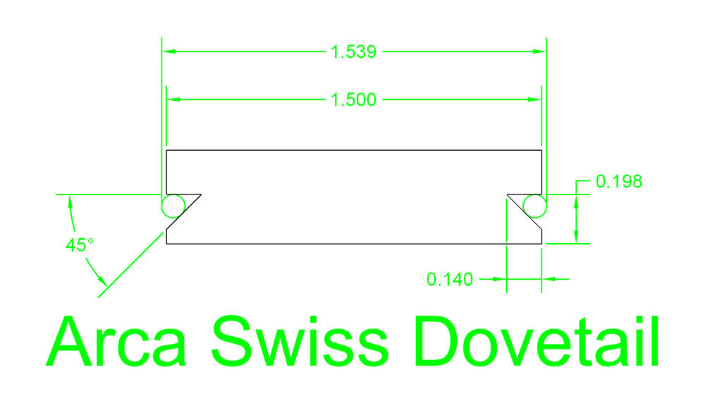

They fit, it's just that RRS perfected/polished Arca-Swiss (which has no standard). At least RRS was able to standardize it with their nomenclature/product line.
You can see the median dimensional differences below. Hejnar Arca-Swiss clamps, etc work with RRS and Arca-Swiss for example - it's all compatible, just not as "precisely matched" as RRS-to-RRS/SOAR parts are.

They fit, it's just that RRS perfected Arca-Swiss (which has no standard). At least RRS was able to standardize it with their nomenclature/product line.
You can see the dimensional differences. Hejnar Arca-Swiss clamps, etc work with RRS and Arca-Swiss for example - it's all compatible, just not as "precisely matched" as RRS-to-RRS parts are.
Yup. I just read the product detail on the Area 419 Arcalock line and it's made to the RRS spec. Awesome product, but the name is misleading though.
