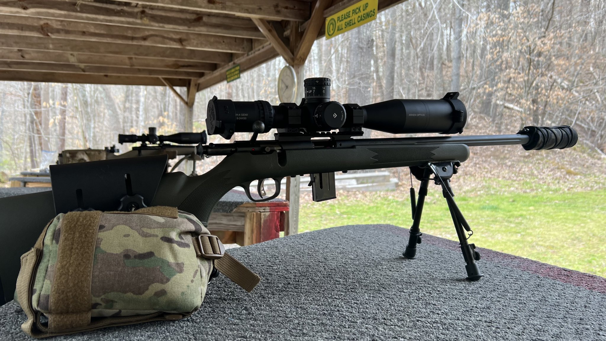

.Kind of a rocky start with my Savage 93R17 FV. Poor fit initially, couldn`t get a good cheek weld and groups and accuracy ( POA vs. POI ) was all over the place. Was extremely difficult to get any sort of sub-MOA group. Put a strap on comb pad that gave me a consistent sight picture and practiced dry fire with a quick trigger squeeze the instant the scope ( Vortex 3-7 ) cross hairs hit the center of the aiming dot at 100 yards instead of holding it there for several seconds. Groups are averaging right at 1 MOA now and .6 " POA vs. POI. Also helped to finally find the round the gun shoots best ( CCi 17 grain TNT ). Still room for improvement, but a lot more fun now!

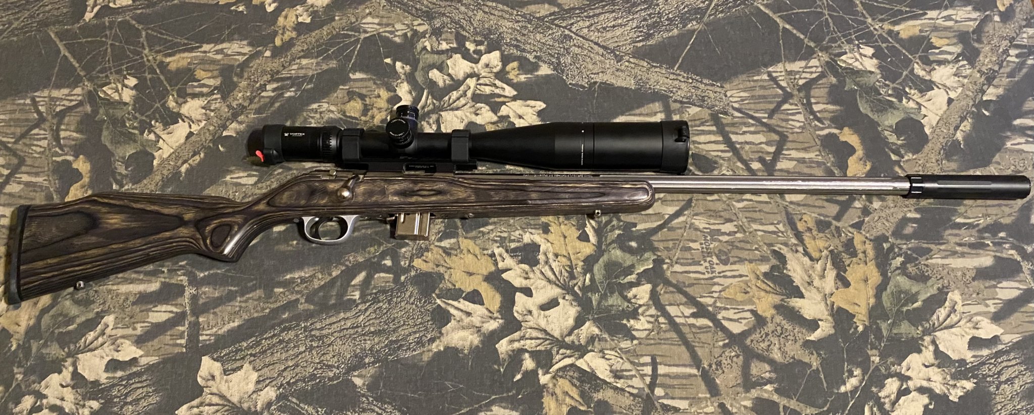

Here’s a picture of my old Marlin 917 VSF .17 HMR I finally got threaded by my smith a few months ago.

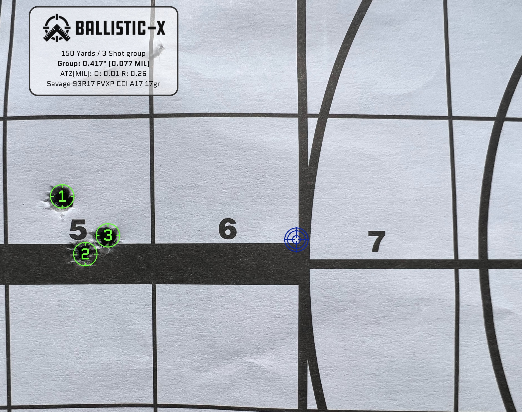

The CCI A17 was developed for your gun if you look at the package. Just a 3 shot group as it did open up some after this with 10 shots but still at 150 yds.

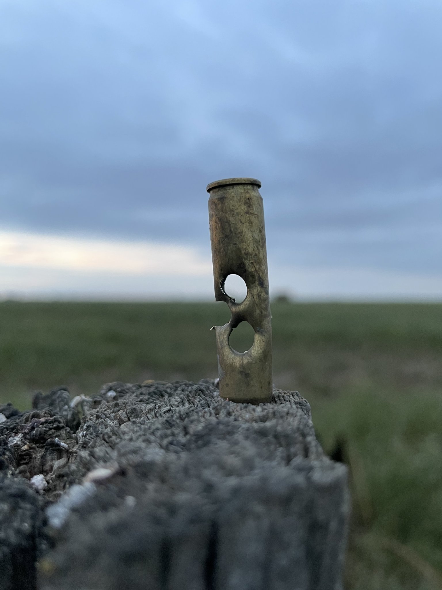

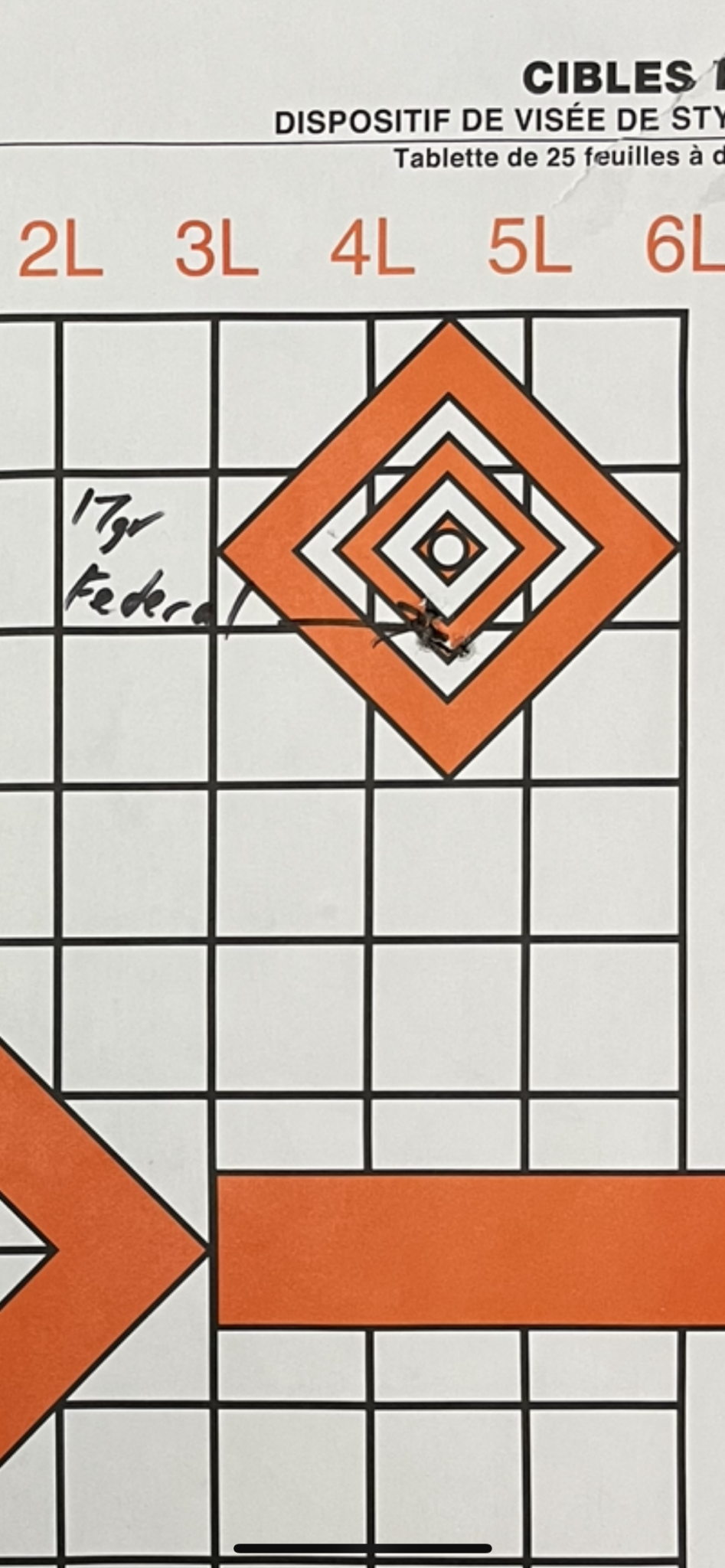

These are what it used to shoot, both three shot groups, compared to what it’s shooting like now. All groups shot at 100 yards.

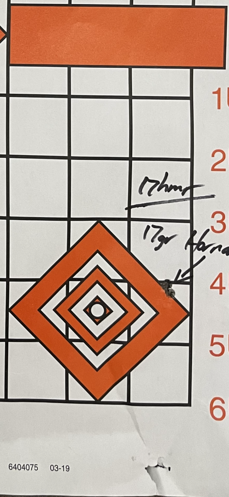

Another 3 shot group before as well. One bullet right through the other hole

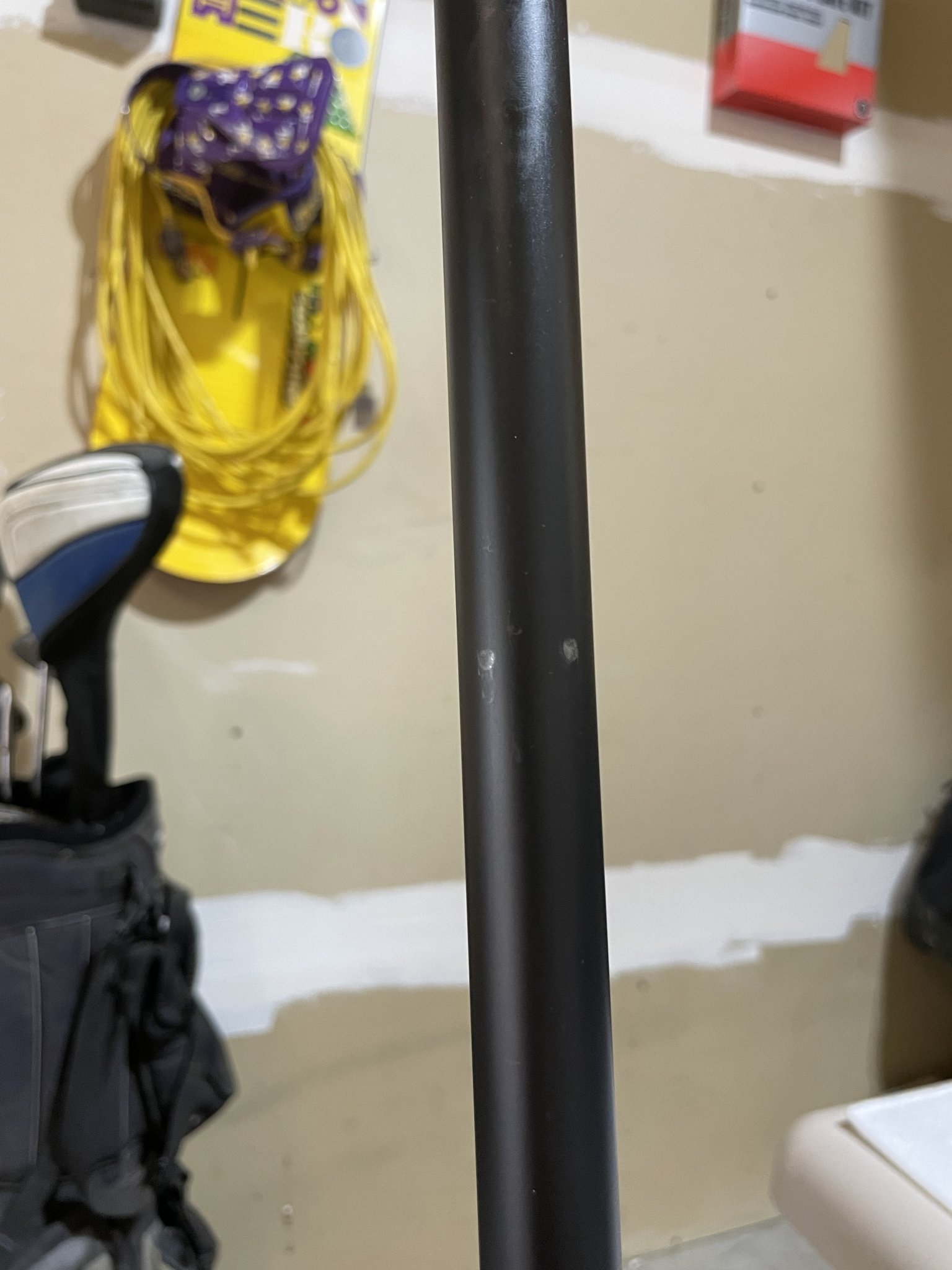

Hmmm I just found another thing on my rifle. Took the hand rail off to check barrel nut, it was tight. But noticed a mark on bottom of my barrel from a screw connecting the bipod to the handrail, pushed up against my barrel, now wondering if that screw being up against the barrel was causing the issue?
Yeah, that’s probably not helping anything.

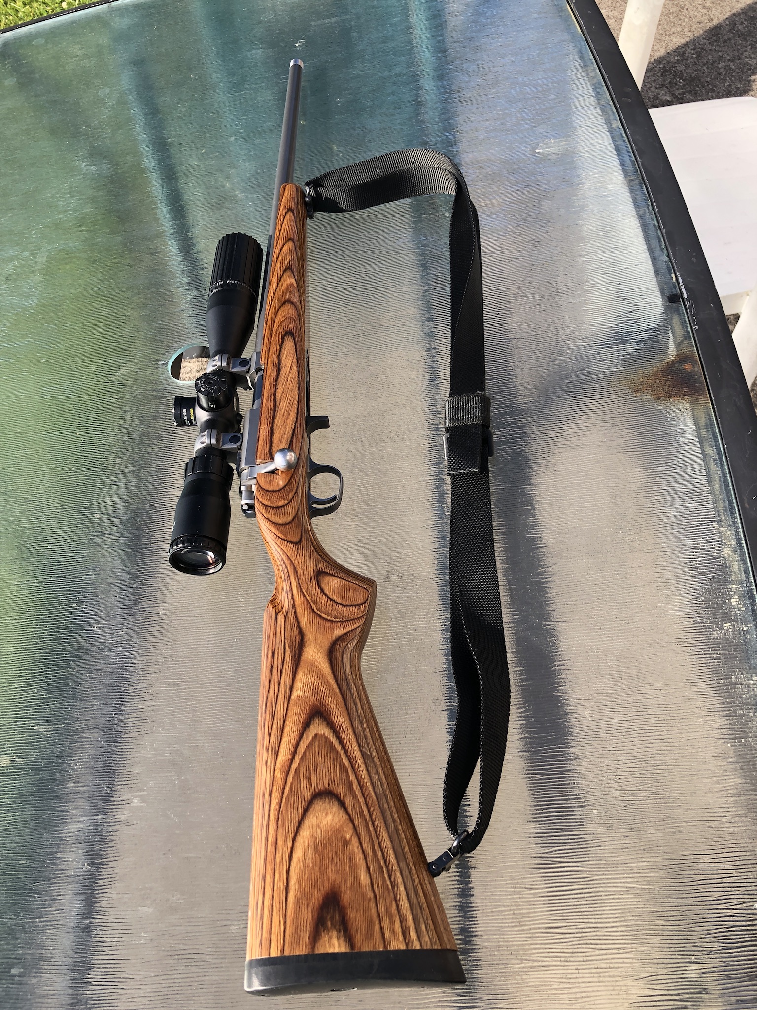

Ruger 77/22 with a 17HMR barrel…done by Randy at CPC Precision…

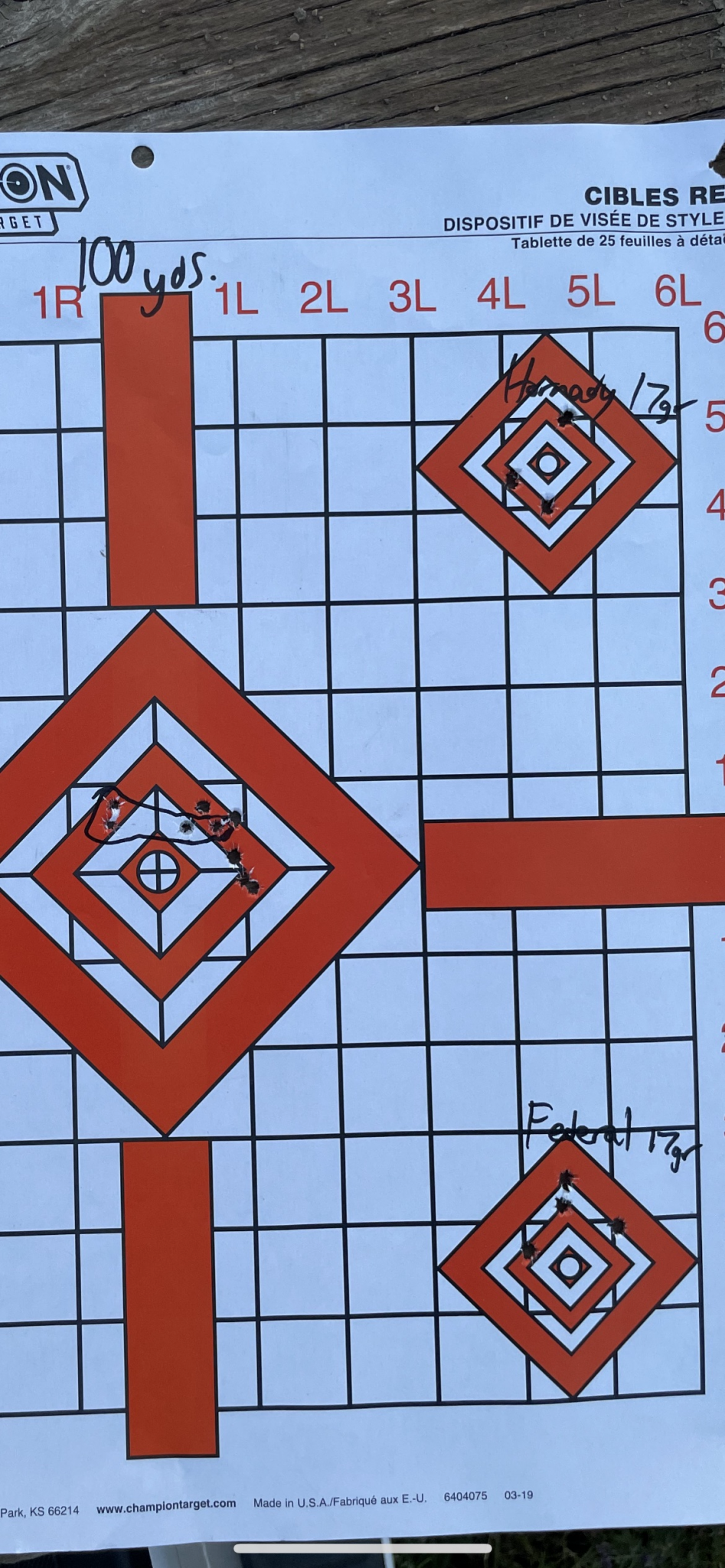

Dang nice! I took my bipod off my rprr today and went and shot and it fixed my problem. The one screw was just touching the bottom of the barrel holding the bipod on, or would just touch when I shot. Took it off. And well this was 3 for 3 shots through a .223 shell at 102 yards

I posted this before. As promised I need to shoot a few 9 round groups to show different ammo. And as promised I need to list a pic of the rifle and barrel. I haven’t had it back out
100 yards for 9 shots
That`s great shooting, especially for a .17HMR. Makes me wonder if you need special barrels and such to do that.
