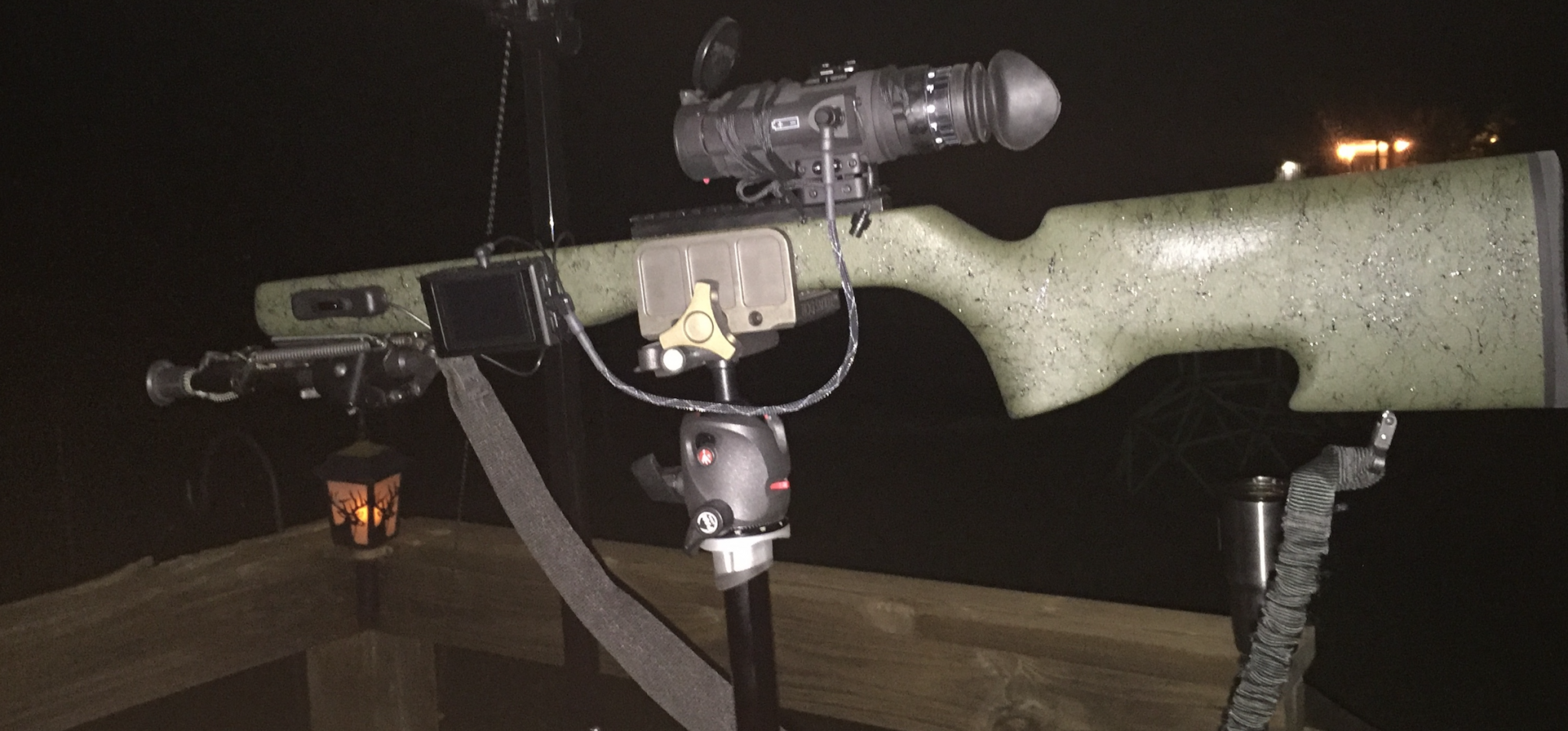

    On the housing. I searched my pictures and couldn't find a close up of the unit (in detail). I feel dumb if it isn't, but I'm almost certain mine is aluminum. Like forged. It appeared the brass inner unit was pressed in and that is what I figured caused the splinters in the housing. This was early on. Was never worried about it until 6 or 8 months ago when they appeared to grow a little bit. Skip to the end, the one went to the edge, that led to SS conversations, send it in, typical 2 week turnaround, etc. Ok, cool.
    This is where it stands. I'll post a pic of the demo unit I used it on.
    This was the original set up for my demo work. Lost the DVR and switch shortly after, just not needed for what we were doing. Still use this platform today for a "real world" feel. PS, it was hot and we all swapped cheek sweat.
