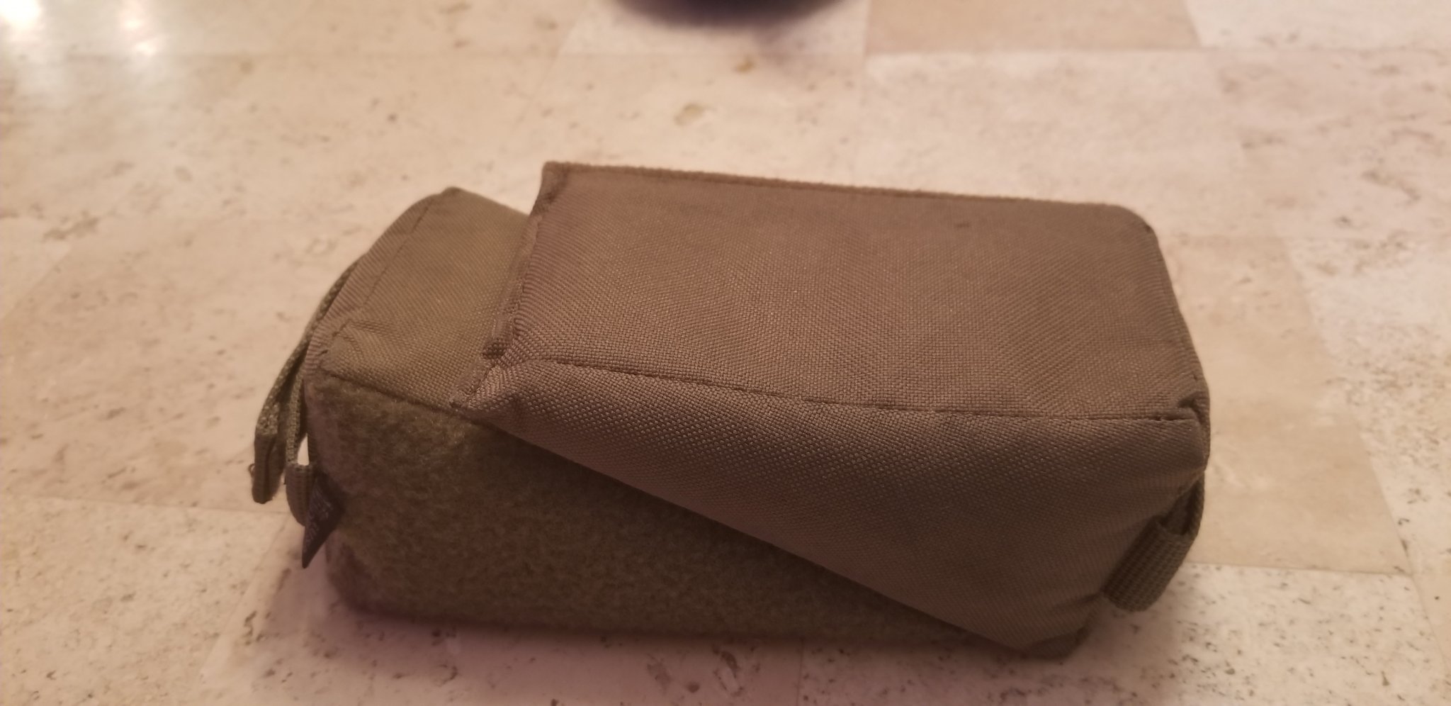

    I have been messing with bags that have enough give to adjust up, down and side to side to get on target. So far, biggest benefit is using real sand and not a light weight fill. Top of bag needs to be flat and smooth so stock rides it and can not get grabbed. I'm finding that different rifles need different size bags.
    What I like most so far is two wedge shaped bags. I am using these from Midway, and plan on reproducing them with a sand fill, or refilling these with sand.
