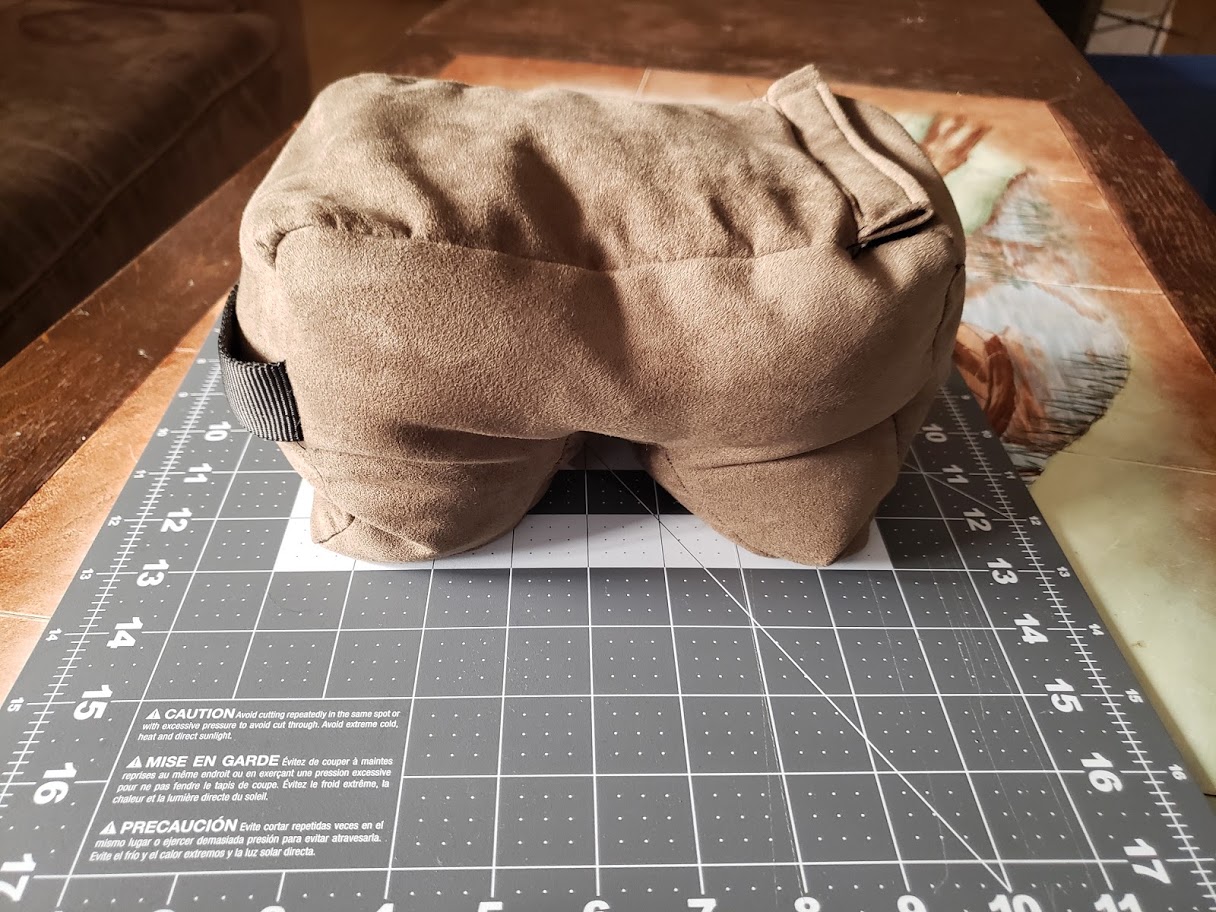

Actually, this looks like a good one to try:
Looks like I could get things close with straps.

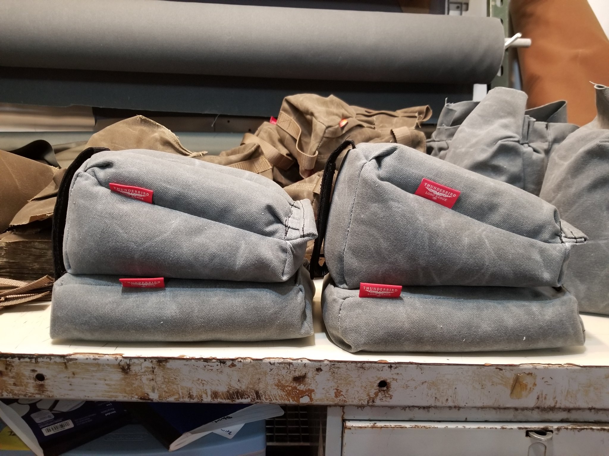

This is a bag that I make for guys shooting ELR. It has a flat bag underneath if you need, especially being a big guy.
A bigger bag is likely going to be what you want. I shoot with a big guy that uses a big pillow type bag and rests his chest on it and then also the rifle stock.
