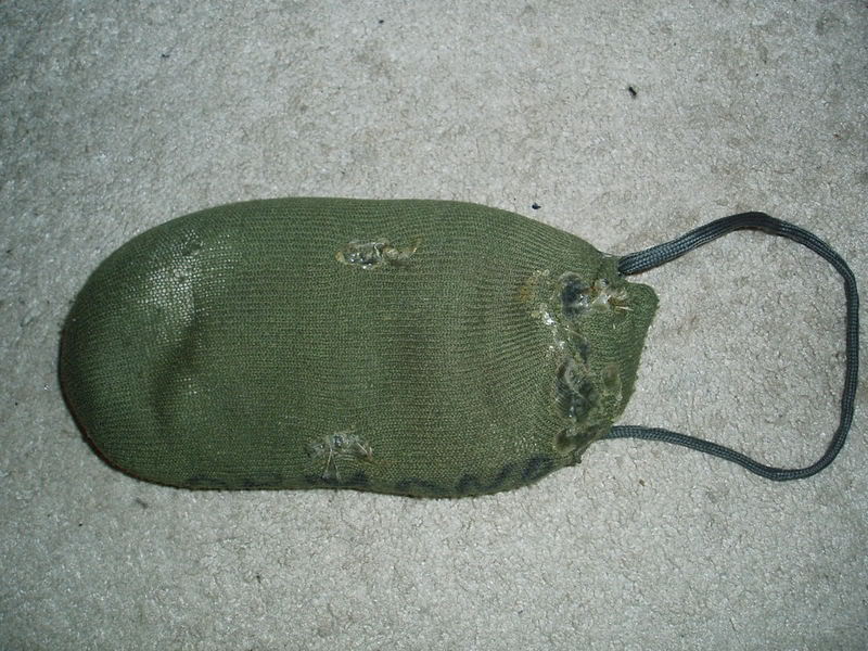

    You could make your own as well if you felt like it. Been using my own for years. Take a sock and fill it to the size needed with poly pellets aka doll fill found at any arts and craft store or walmart and what a lot of commercial bags are filled with. Then cut sock, fold over and sew it shut. You don't have to be a top seamstress to do it. Then put it in another sock with sewn part in first and then cut and sew again. Done. I add a piece of 550 cord as I like to be able to grab it or attach it to the rifle for matches and I put a little shoe goo over threads to protect them during harder use but you don't have to. Not pretty but works as good as anything out there and costs about $8-10 to make.

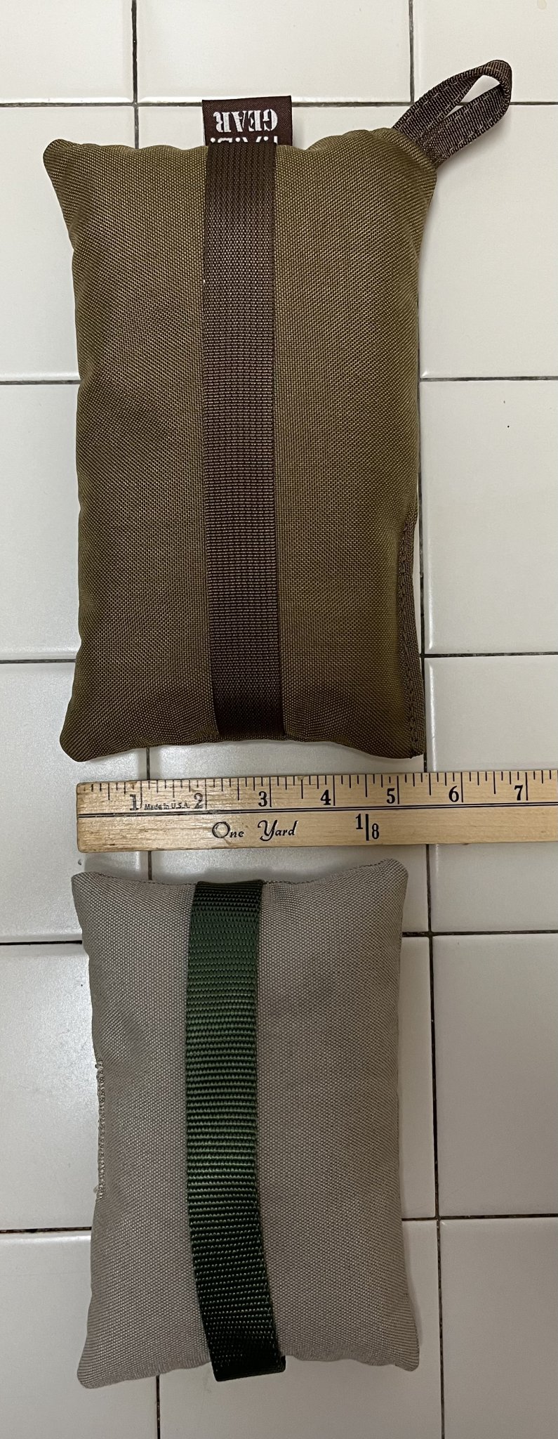

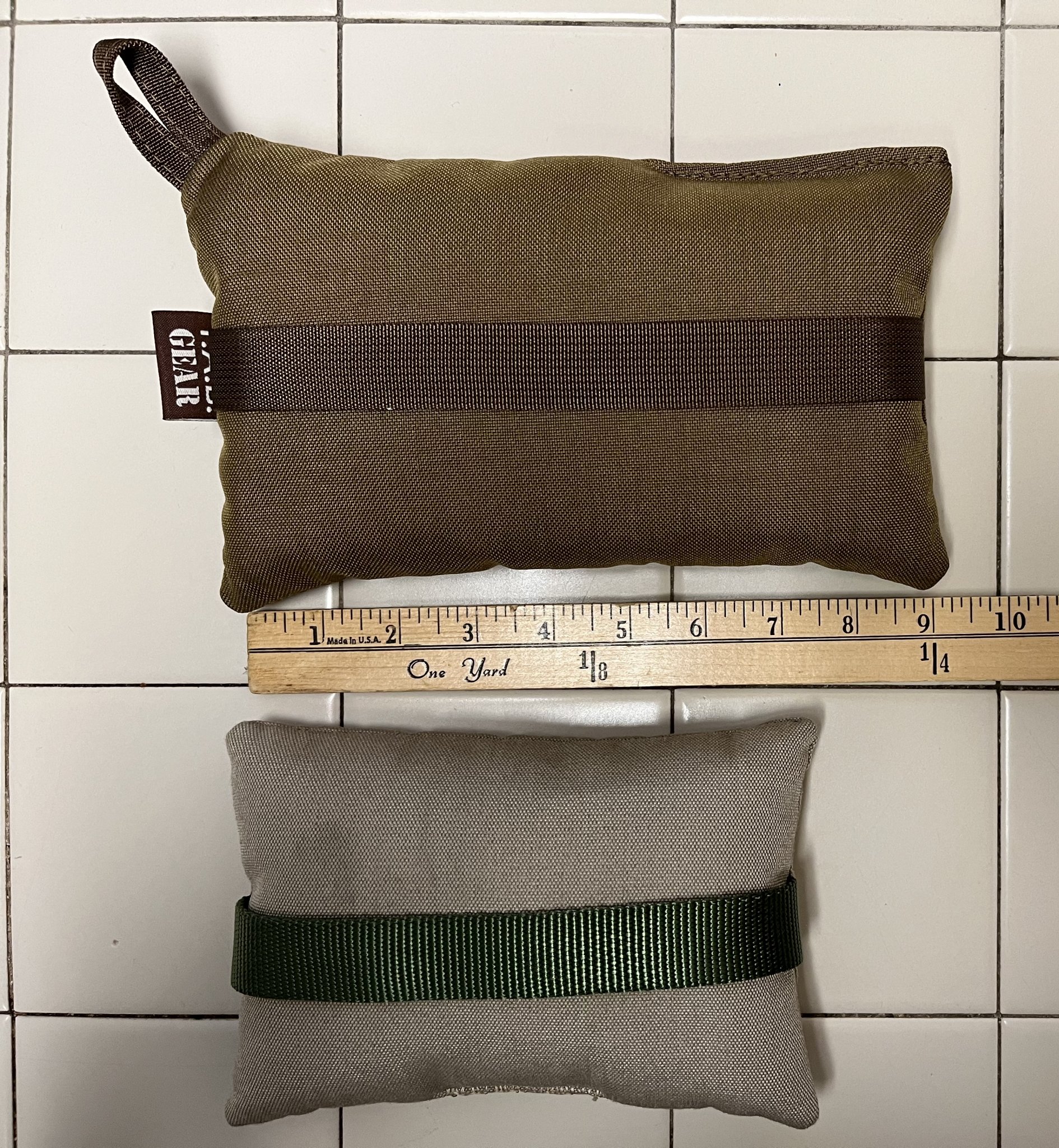

    TAB Gear Large Rear Bag compared to Taylor Was Here rear bag.
