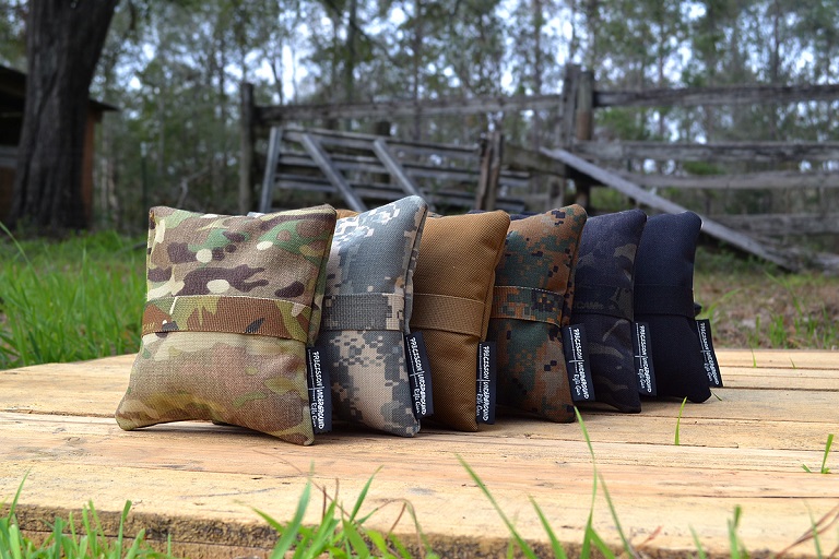

The correct rear bag is what you need. Not just a camo sack with slippery beads!

The neat thing about F class is that you can do whatever works for you. That said, I only know of one serious F-class competitor who doesn't use a bag similar to those in Monte's post above.
Give it a shot it may surprise you! Same concept, the bag is sized to your needs. Once you compress it the top edges fold in on the stock and hold it like rabbit ears.

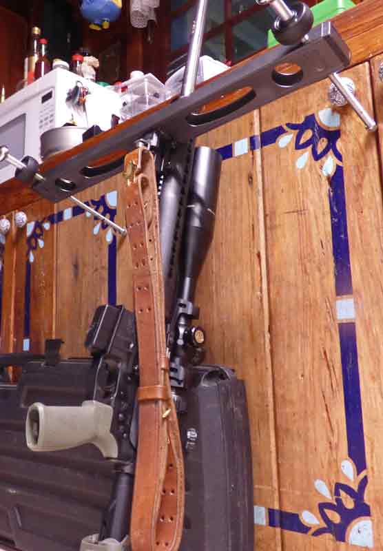

i remember seeing how you can use the sling to "load the bipod", if your a bipod smasher
I tried it this past Saturday @ 600.
Will take a little getting used to.
Once I get everyone at the range used to seeing it I'll probably try just a hand loop.
