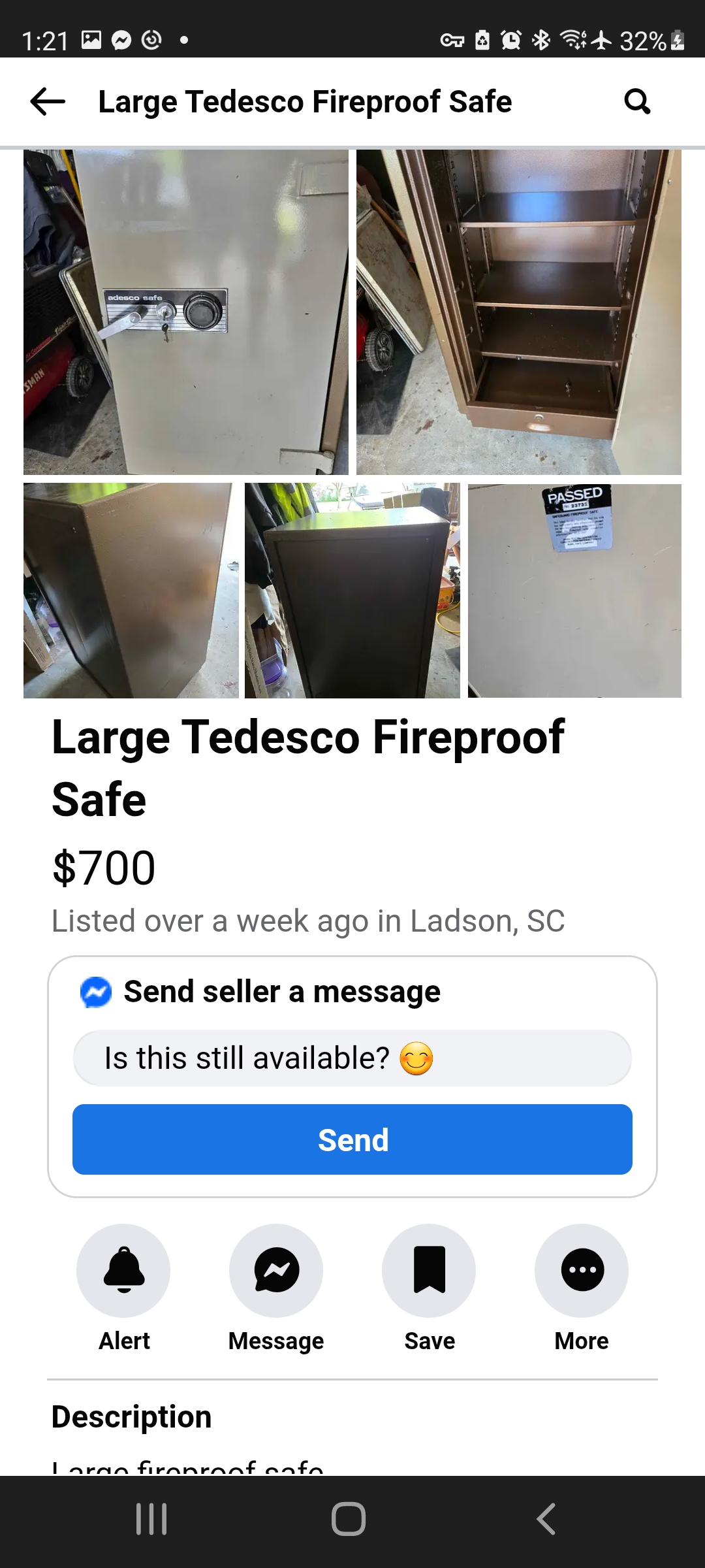

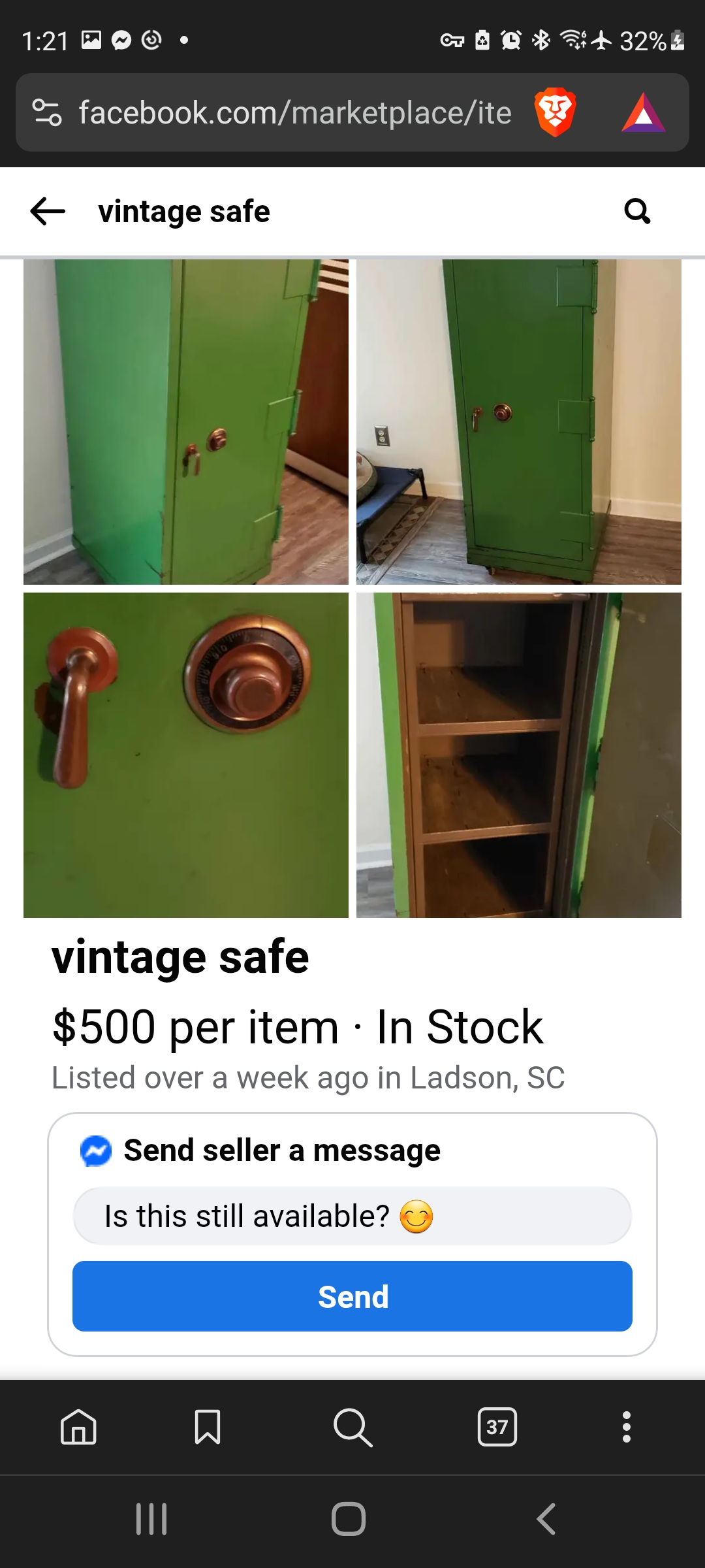

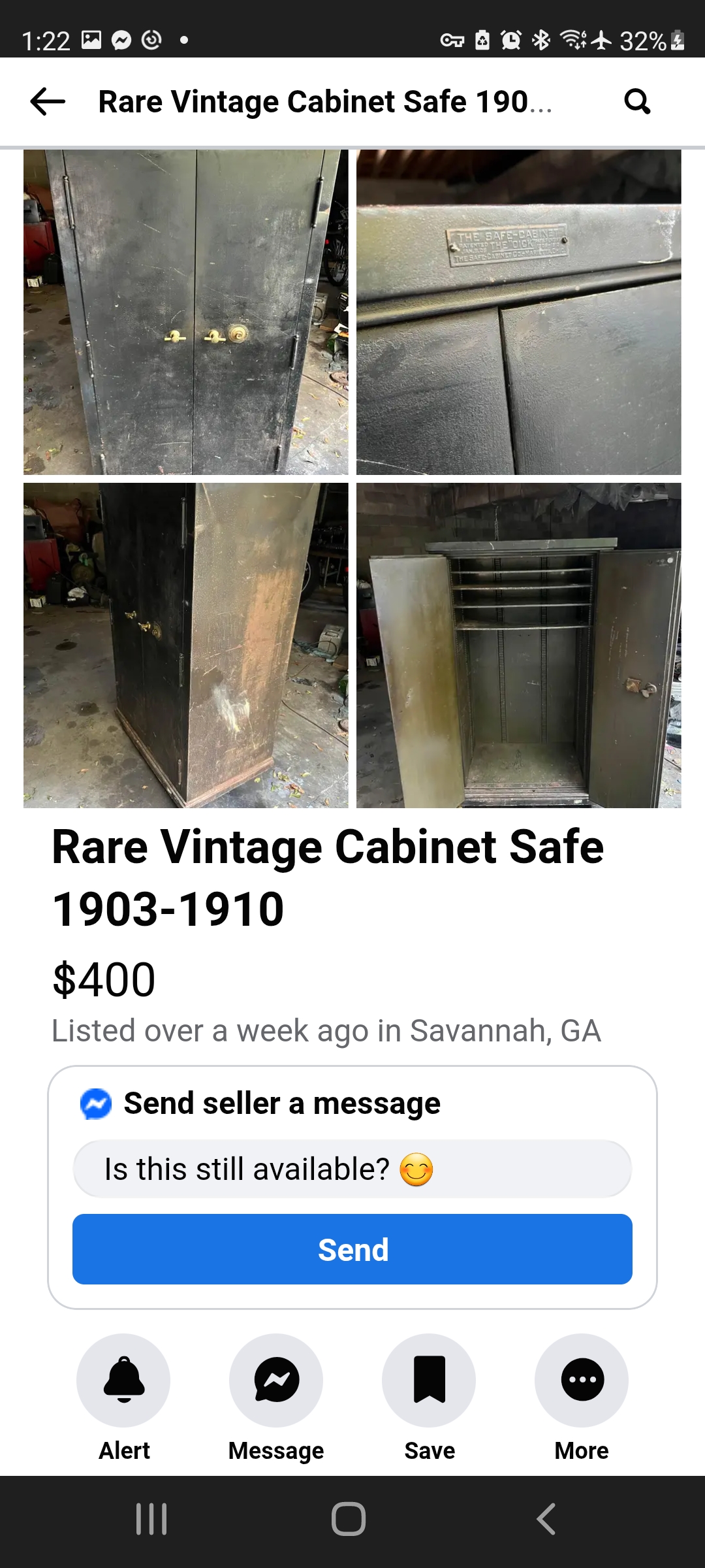

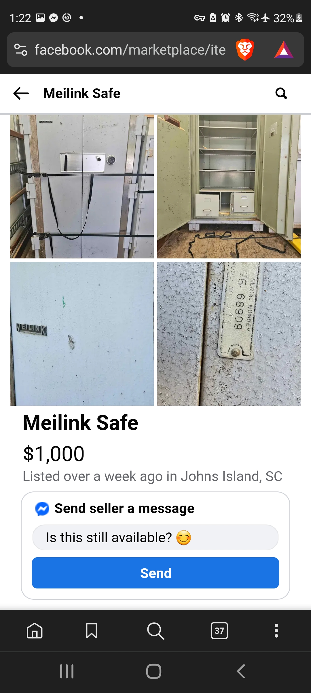

If you live near a big city and it is going on a solid floor, go on FB marketplace and look for old safes. Mosler, Gary, Yale, etc. It is easy to move them with a bar and pipe. Often because they are heavy folks will give them away.
I got my last double door Mosler that weighs 3500 for 300 bucks and loaded it into my truck bed myself with hand tools.
If you slap the sides and it doesn't sound like you hit solid stone, it isn't worth shit. Not even a little wobble or resonance is tolerable.
If you can find something with a TL rating you can assume it is good.

The guy who is listing the safes for 1000 is high but offer him 500 cause you have to move them and get the combos reset. Combo reset on an open door safe should be less than 200 easy.

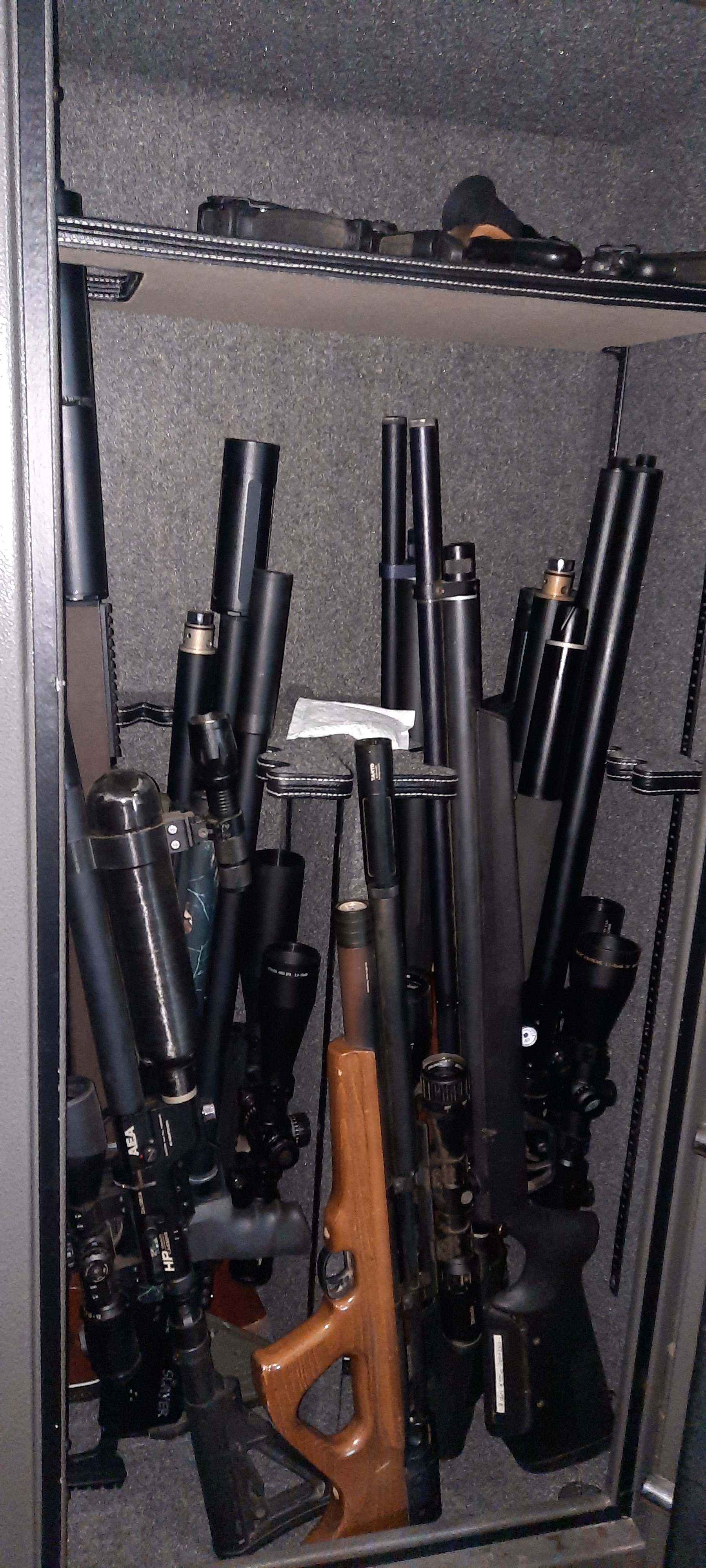

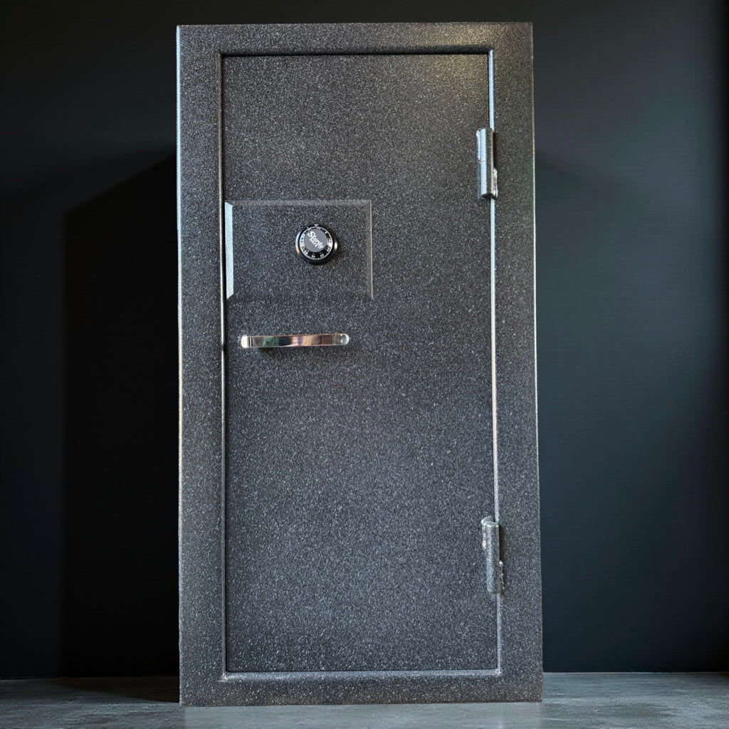

I have that exact safe, there's no way you can get more than 12 long guns in there , I use mine inside my house to store pcp airguns , it's fairly easy to move if you have a small trailer a dolly and a Freind to help , like others have said a professional thief will be in and out in 5 minutes, but it will keep the casual neighborhood teenage thieves out , I live in a area that isn't prone to thievery and have two safes for my powder burning guns in a locked room inside a shop next to the house with cameras and alarms on all corners ,and I'm retired so home most of the time ,if I lived in a large city I'd invest in way better safes .

But when good, bigger Moslers or TL rated safes are available for cheaper, why would someone buy some chinesium safe?
I think that Mosler safe you posted from facebook is an old "tamper" rated safe, obsolete rating I think, not the same as a burglary rating. Ratings have changed over time.
You can find one here that has been completely refurbished as a 30 gun safe and has no security rating at all.
Other than that I'd say most people aren't looking for another project or fixer-upper or they're married and the wife won't let anything that fugly in the house.
infinitely better
From the plate on the inside of the door it has a "Mercantile Safe Policy B" rating which is a insurance company rating not based on any tests, this is pretty much the lowest rating on the scale, below RSC.
I'm not arguing about how much better or worse it might be than a Liberty, just passing on information trying to answer your original question of why someone might not be jumping at the opportunity to own one.
Either way it's plenty good for keeping kids and casual sticky fingers out.
