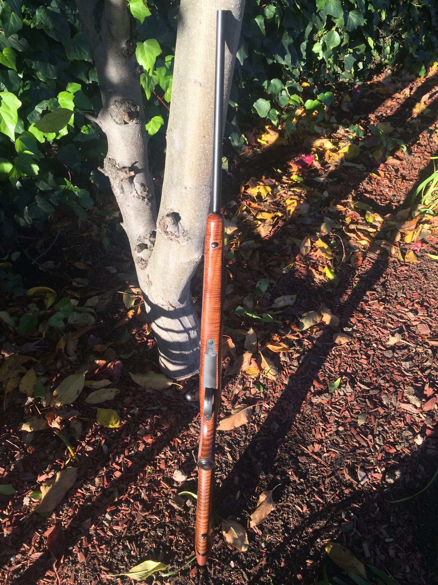

I’ve got a absolutely beautiful Kimber Classic 243win. The wood stock has fiddle backing throughout and it is such a nice light handy package, butttttt it shoots like shit. 4-5 factory offerings and nothing under and inch. 3-4 handloads (Sierra, Barnes, Berger) only Barnes at 1.25 inch. The barrel channel isn’t even. The right side is much closer to the barrel. I can still slide a dollar bill to the shank, but looks off. The rings are Talley and a Zeiss Conquest 3x9 which have been proven on other rifles. So.....
Would you rebarrel?

I really want to make this rifle a family type heirloom. It’s accurate enough for hunting but I can’t stand not getting peak performance. If it was shit grain wood I wouldn’t care but this thing is a beauty and I like the weight and balance. I’ve got 3 young girls under 1, and would love for them to take their first animals with it. It would have to shoot non-lead as we live in horrible California. Does an 8 twist the best option for mono bullets in a .243?
Would would the “experts” on the hide recommend?
Not the best picture but I’ll post of more next time out. If you zoom in you can see the “zebra” like fiddle backing.
