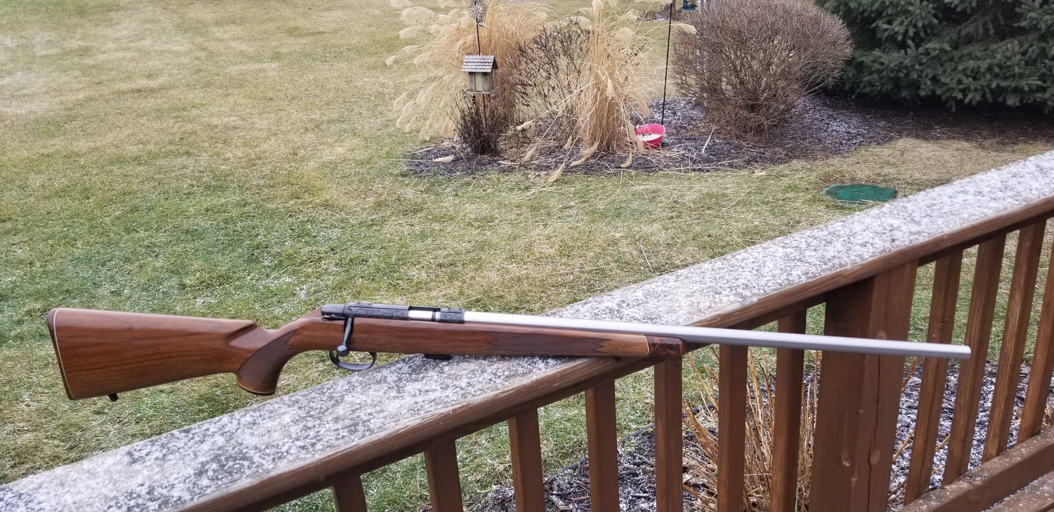

I had the model # wrong it's a 541-s anyhow got everything together test fired , cycles and ejects fine.
The barrel was a Shilen 17 caliber blank for a 700 rem turned it down and chambered to 17 mk2.
Thought I would show how it turned out .
Thanks

Its windy and nasty here so conditions arent ideal but he's getting half inch groups at eighty yards with the barrel freefloaded .
Another smith friend thinks it needs up pressure on the barrel ? After the wind dies we will shoot before modifying anything.
