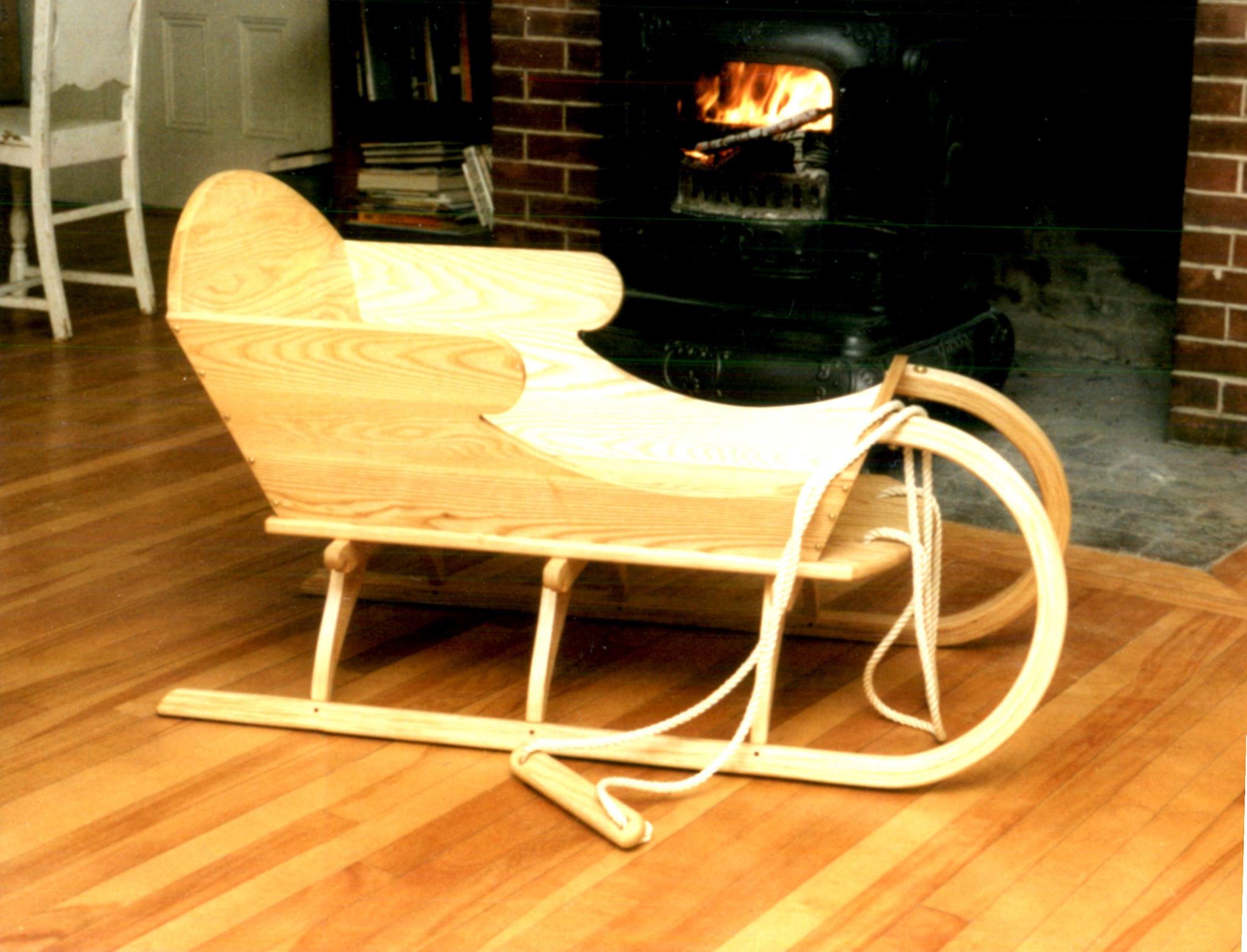

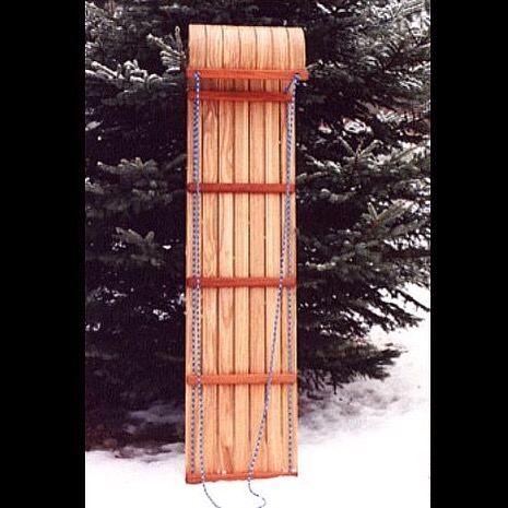

Personally I would use boiled linseed oil with a top coat of butchers wax. Do both sides the same to stabilize it for the long haul.
When you attach it to your bench, screw a center screw then for the remaining screws across the width, slot the holes on the skirt or whatever you are attaching to and use washers. This will allow expansion and contraction so it won't split.
I built both of these using the above finish. It is very durable
