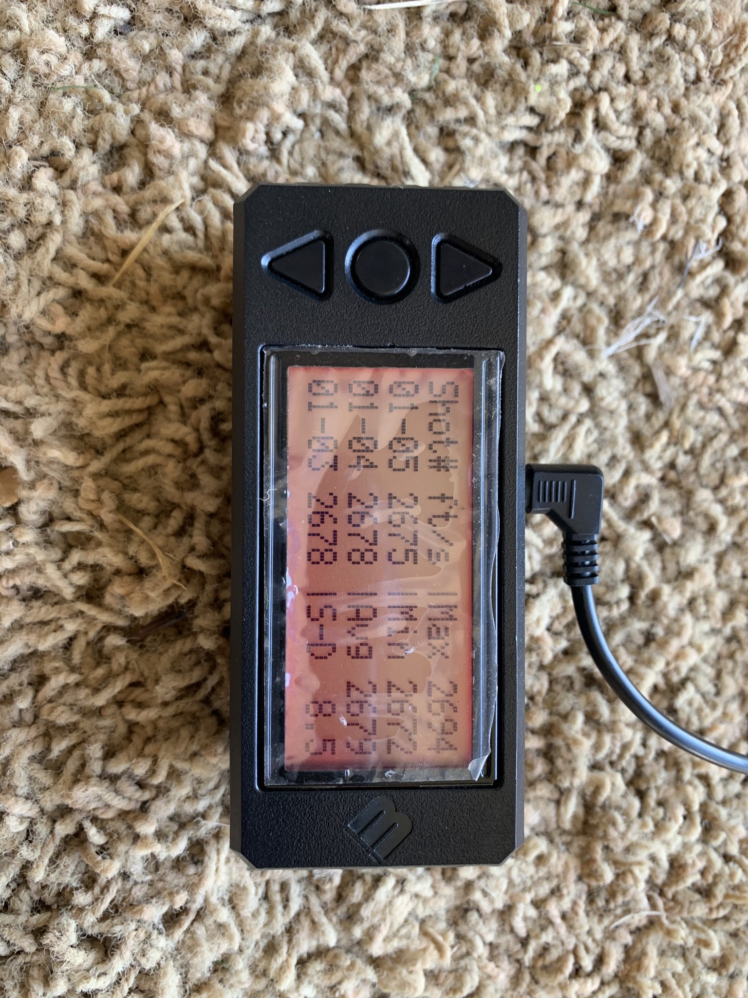

Seems a little on the slow side for the 140s, this is my setup with factory 140 eld 24” proof
