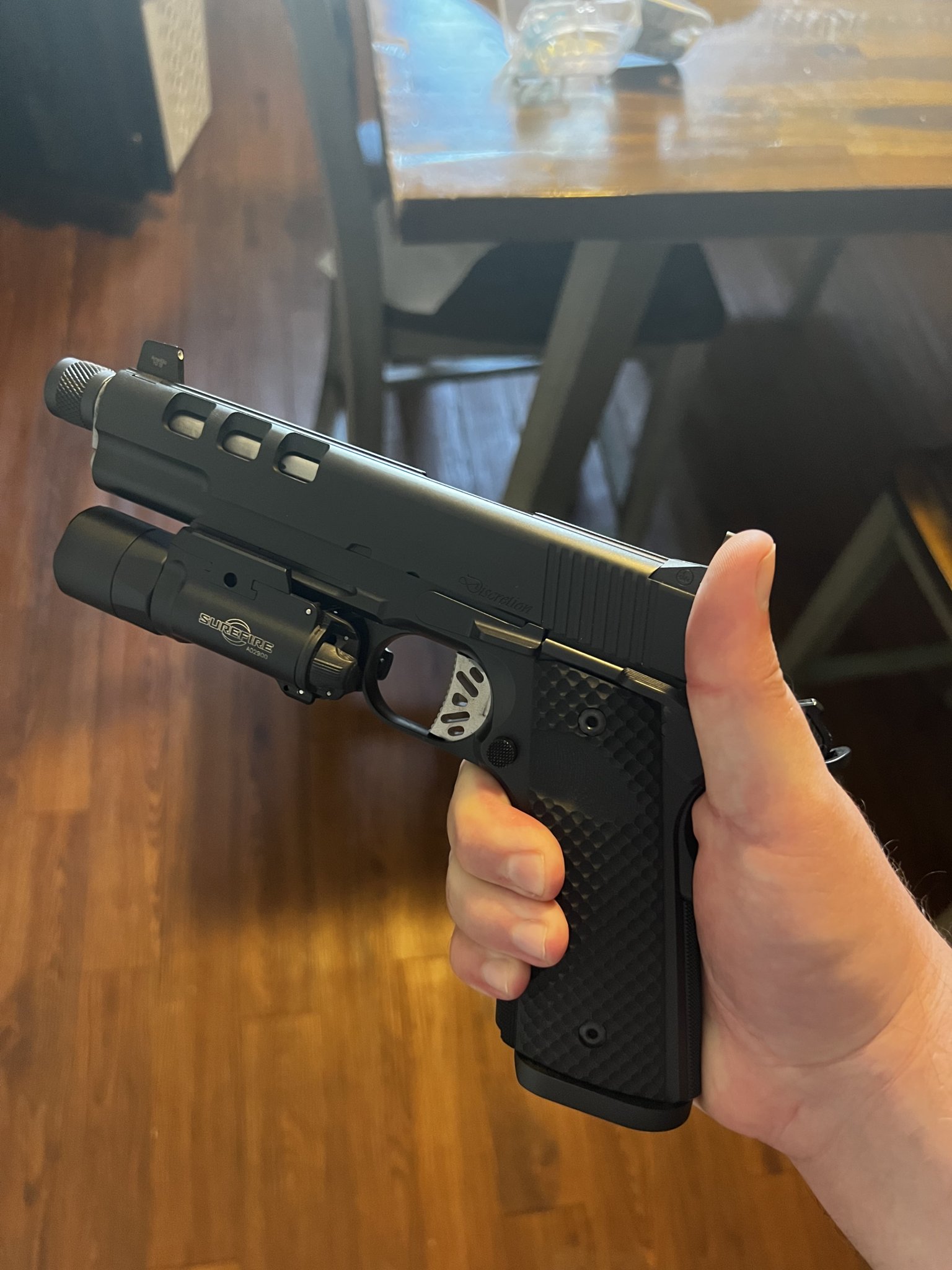

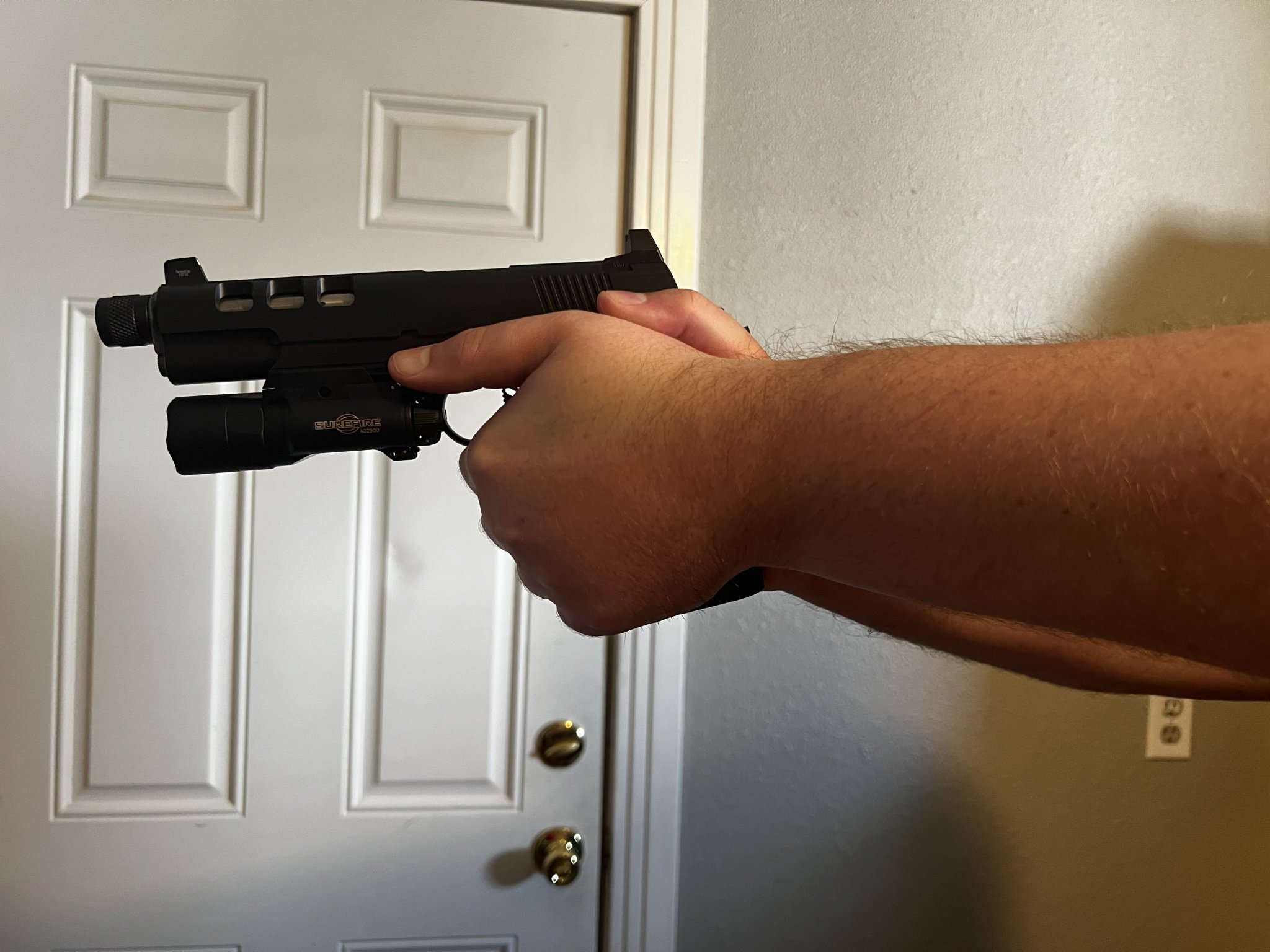

Your support hand needs to by sucked in more to the frame and your left hand thumb needs to be under your other thumb. From the video it looks like your right thumb is being pushed against the pistol by your left thumb. They both should be in the pistol. Give me a bit and I’ll show you an example.

You got good advice from @Kadams1563 also notice the subtle difference in how his left wrist is rotated and yours is not. That makes a yuuuge difference in recoil control.
Your arms are also hyper-extended and your elbows are almost locked out (or so it seems from the pic). Both are no bueno for recoil management. Flex (bend at) your elbows just a tiny bit.
