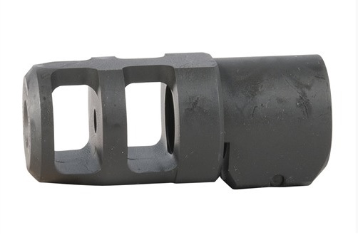

So, are those wrench flats on the top and bottom of the Badger FTE? or just styling?
Any reason for recommending the "mini" FTE over the full-size?
What do you guys think? Are big ports like this better? or smaller ones?
Thanks!

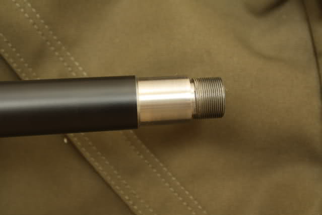

I LOVE my badger FTE (full size). It works like a champ and its easy to get on and off. The only down side is it doesn't fit onto a standard threaded barrel. The barrel has to be milled down at the end because the Badger slide over the end a bit like a sleeve before the threads engage. Its looks kinda ugly when the brake is off. Doesn't hurt anything though.
Id go mini fte. The standard fte is huge for something like a 6.5x47. very easy on and off. Don't overtighten and you are good to go.
