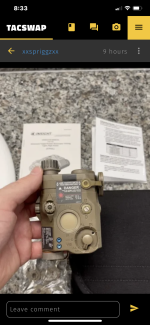

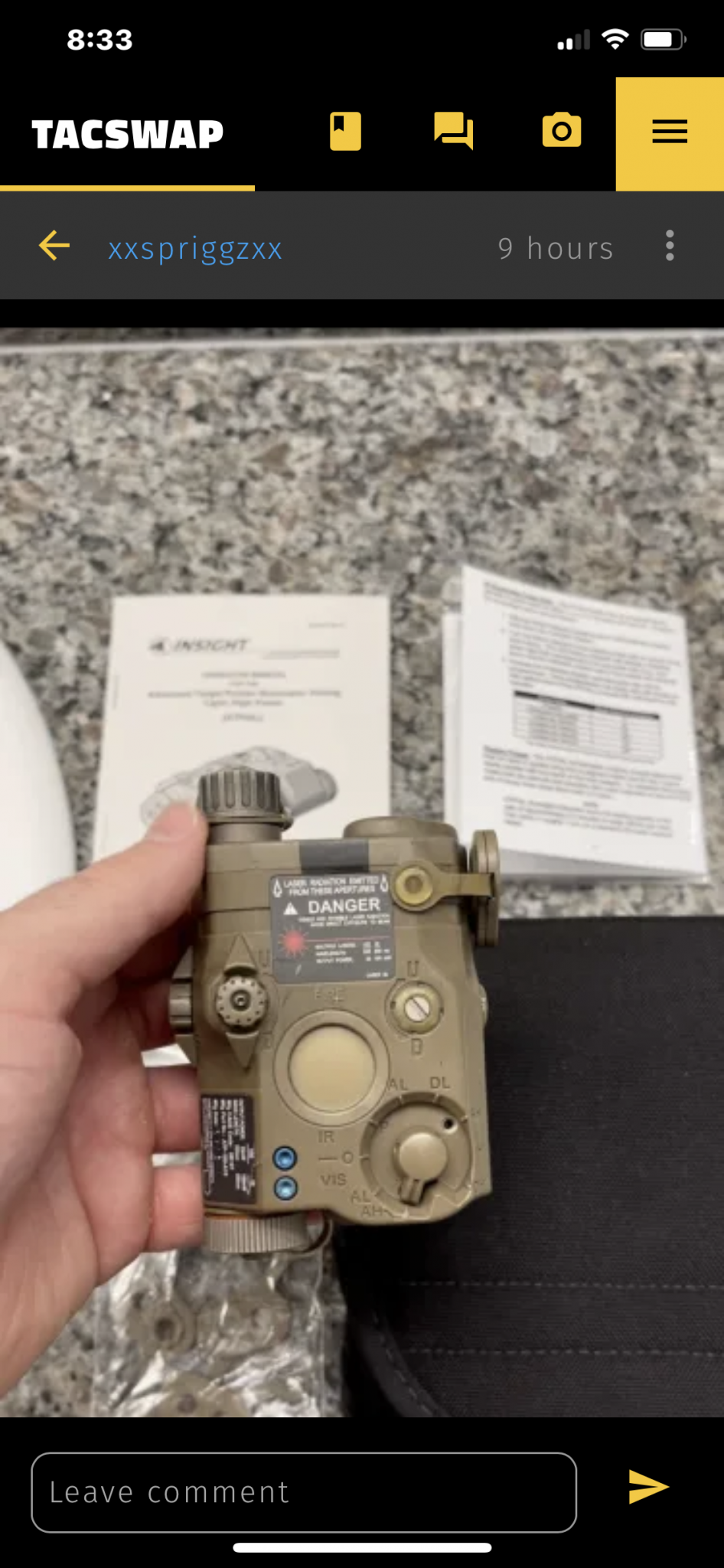

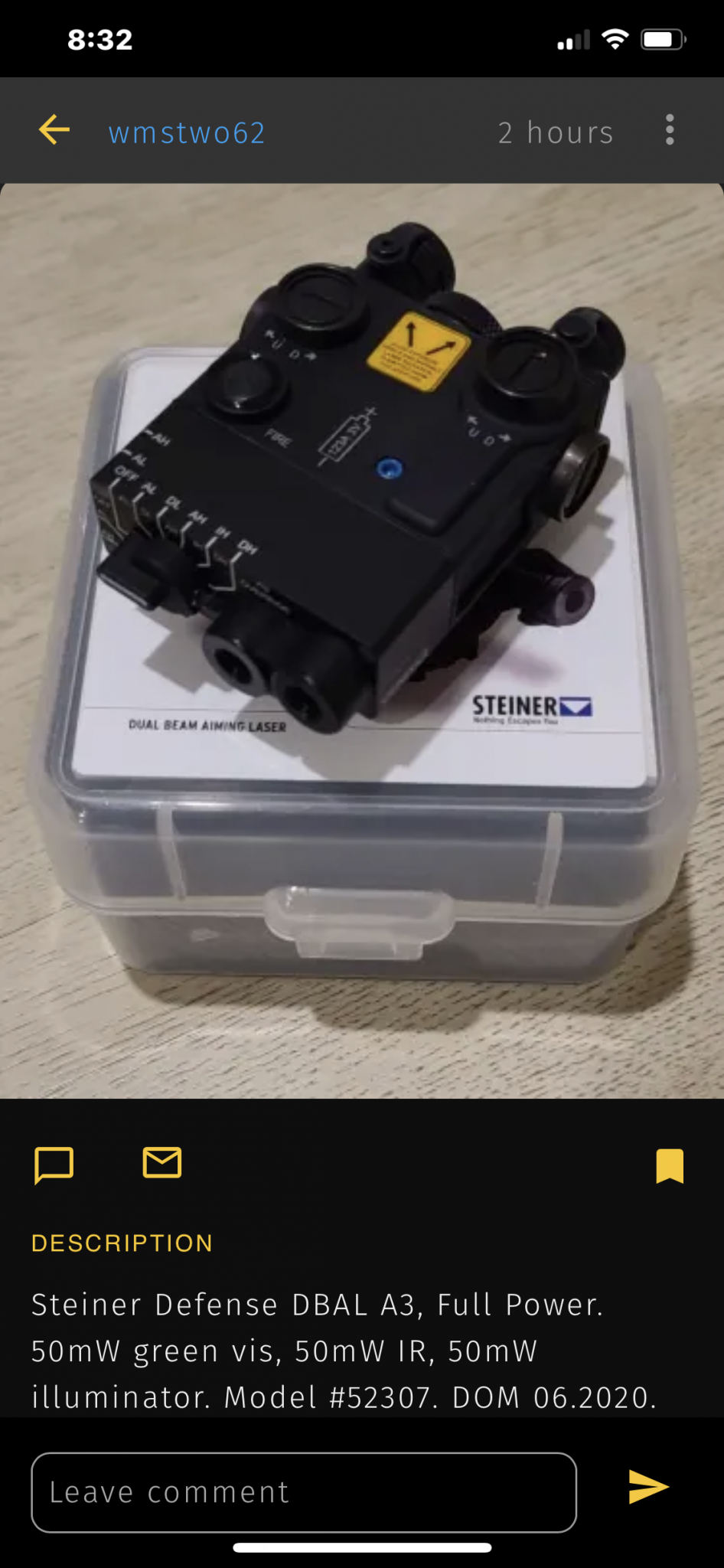

There’s a PEQ LA-5B for 2800.00 and a new Steiner A-3 Model #52307 for 2200.00 50/50/50mW on TACSWAP.com right now
Those are really good prices and both are outstanding full power Laser Illuminators
TACSWAP
