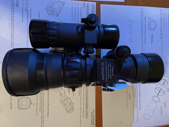

Here is an idea of the size comparison between a PVS30 and an UNS-SR
