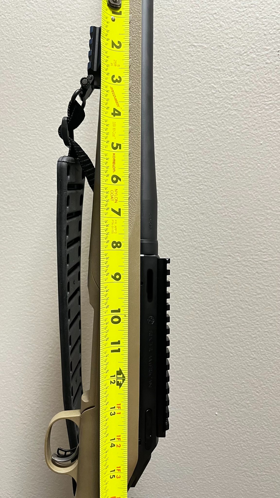

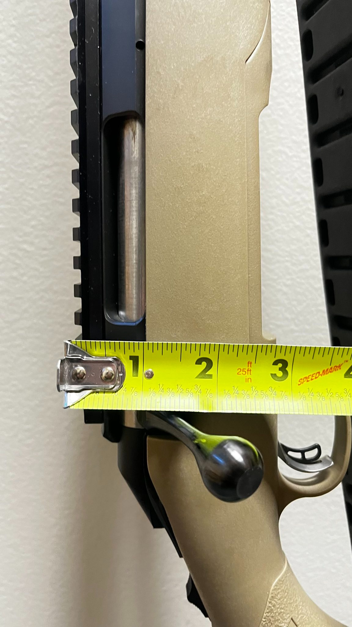

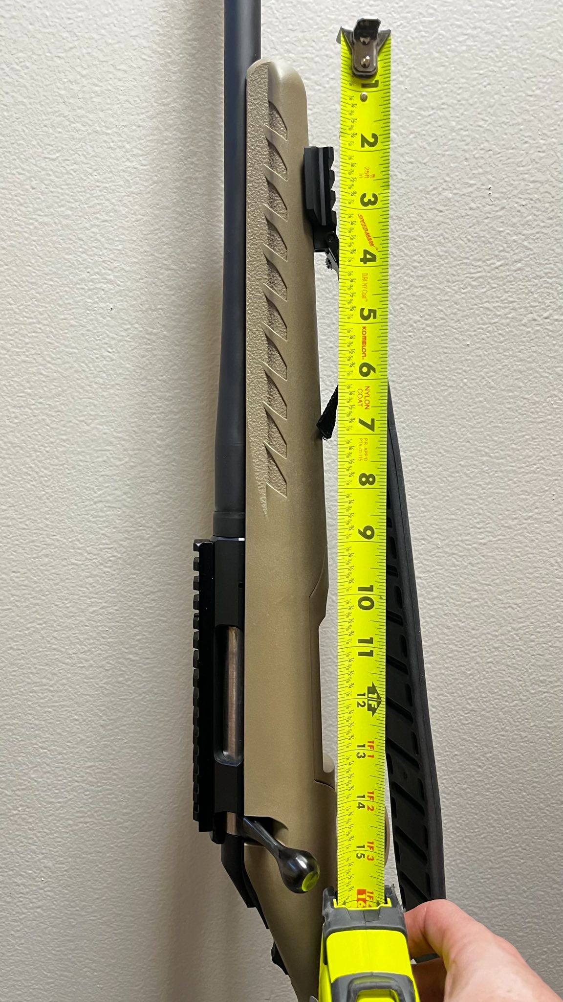

If you can take pic of the rifle from the side from action to about 10" down barrel. Just want to see if that mount is as low as it looked online.

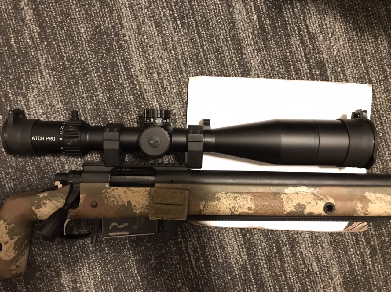

That’s actually a little taller than it looks online so you might get away with a 1” height especially with the slimmer barrel contour. I have a Match Pro in 1.26” height rings on my 700 and will post a couple pics when I get a chance.

Glad to help. You will like the Match Pro. Really is a good optic for its price range. Below is a pic of my Match Pro on my 700 with a 20 MOA base. The barrel is a heavier contour M24 also. I think the 1” would work for your set up.
