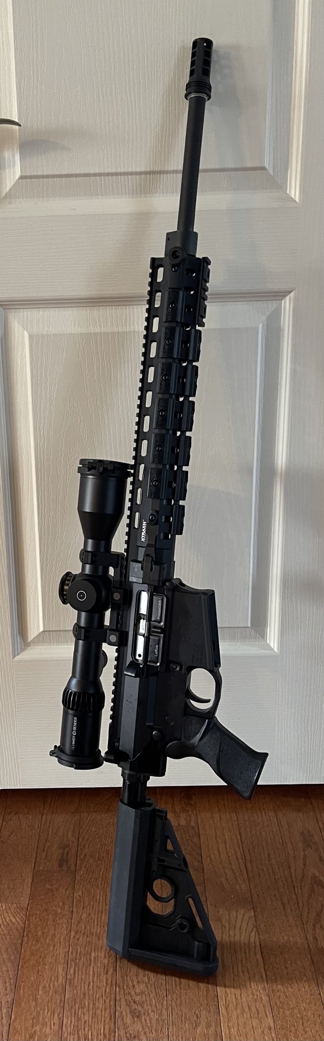

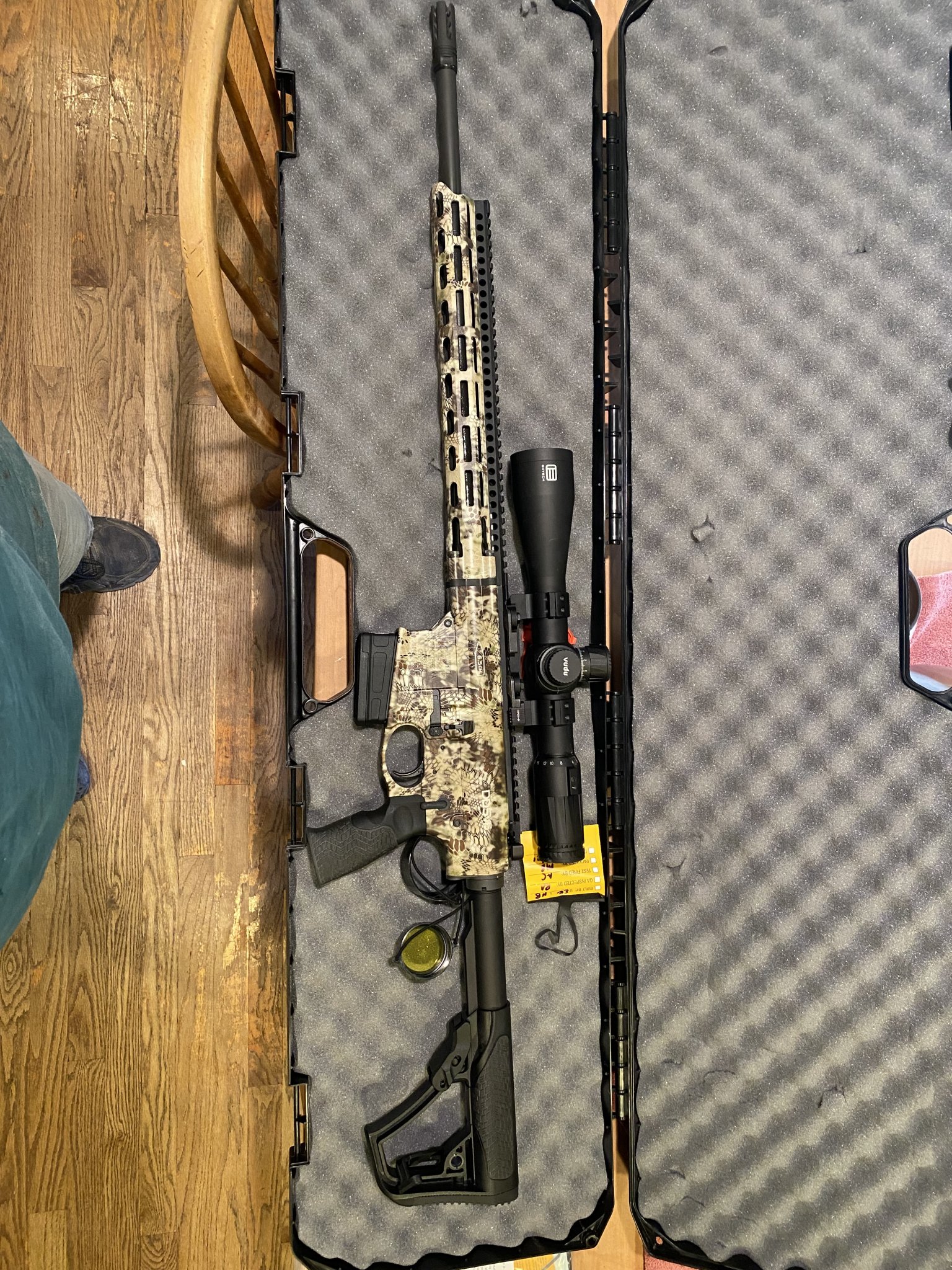

Daniel Defense DD5 V5 in 6.5 love it
Reactions: harry_x1

thanks.. can you share your pros/cons with this rifle? How reliable and how accurate it is with match ammo? Thanks
Pros fit feel build the way it shoots and being a Daniel Defense very reliable life time warranty and full disclosure all i have done with it so far is run 2 boxes of S&B through it to sight it in tight sub moa at 100 cons its not a ray gun so i have to buy ammo
Reactions: harry_x1

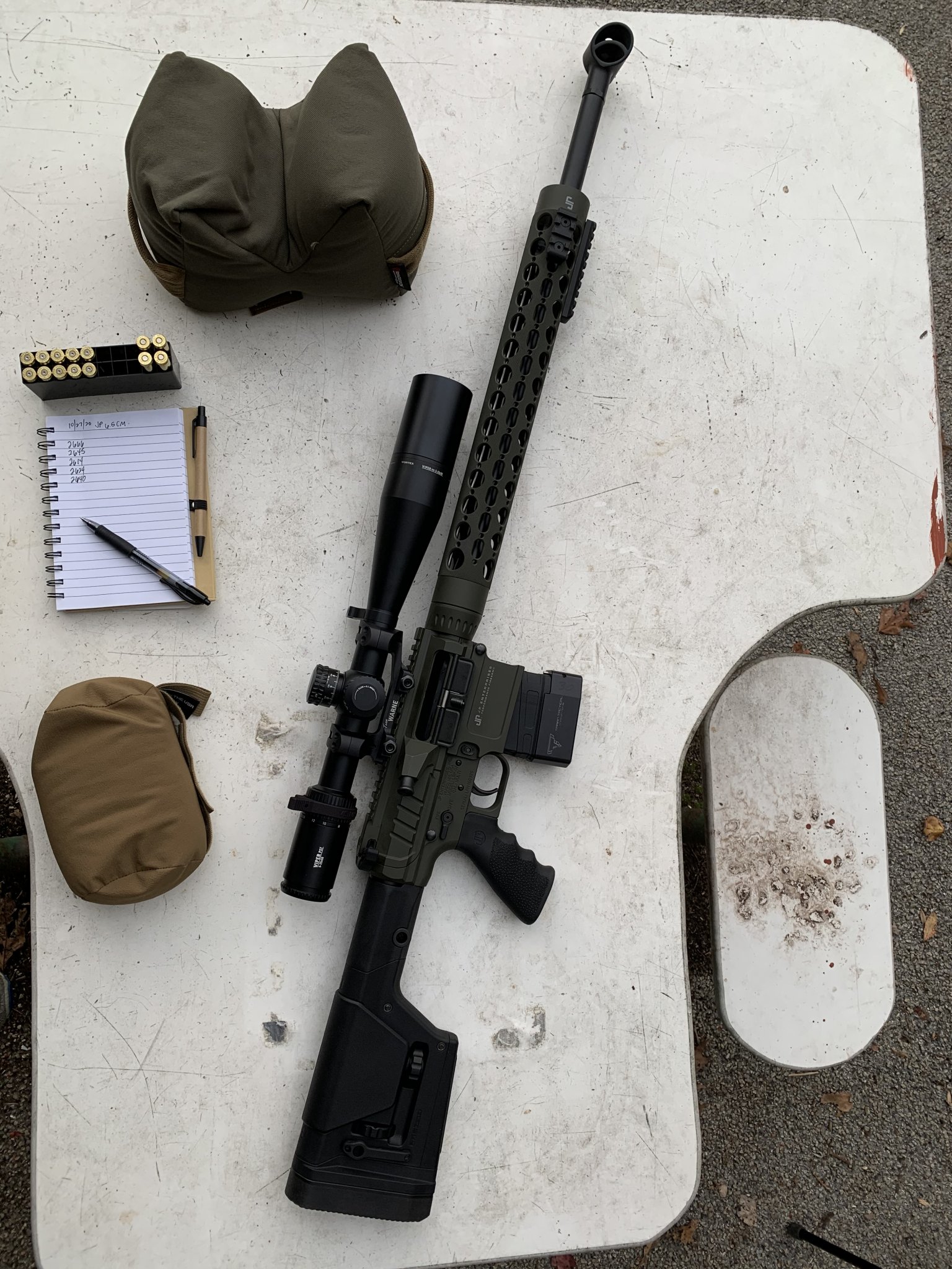

I have had a couple of AR10s in 6.5CM. I only have a Seekins SP10 currently so that tells my story. The LaRue I had shot well but just wasn’t as refined in my opinion as the Seekins. The Seekins SP10 just flat out hammers and runs fine when dirty. Their (Seekins) customer service is next level as well. I’m leaning towards trying one of their 6arc DMR rifles next.

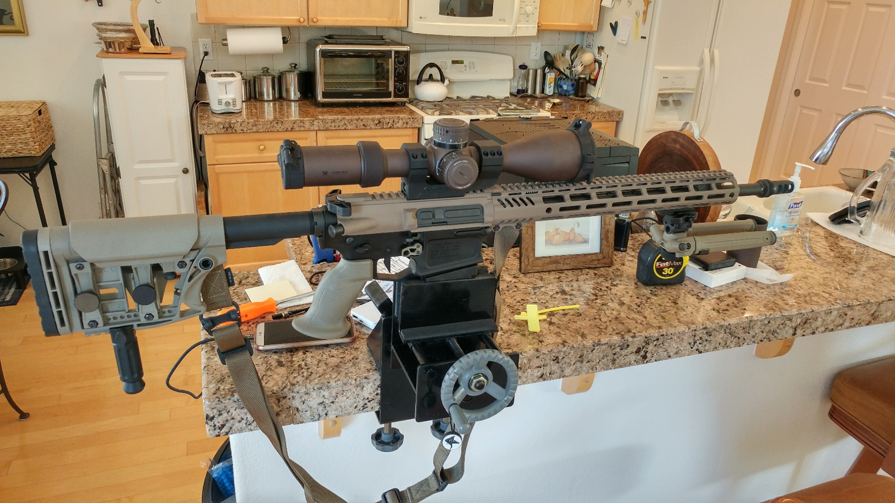

I had Craddock Precision assemble my upper with a Bartlein 18" barrel. Put a Rubber City Armory high pressure bolt in. Rubber City also offers a adjustable gas key if you don't have a adjustable gas block. I shoot 130 ELD-M's at 2730 fps. Shoots from .60 to 1 moa.

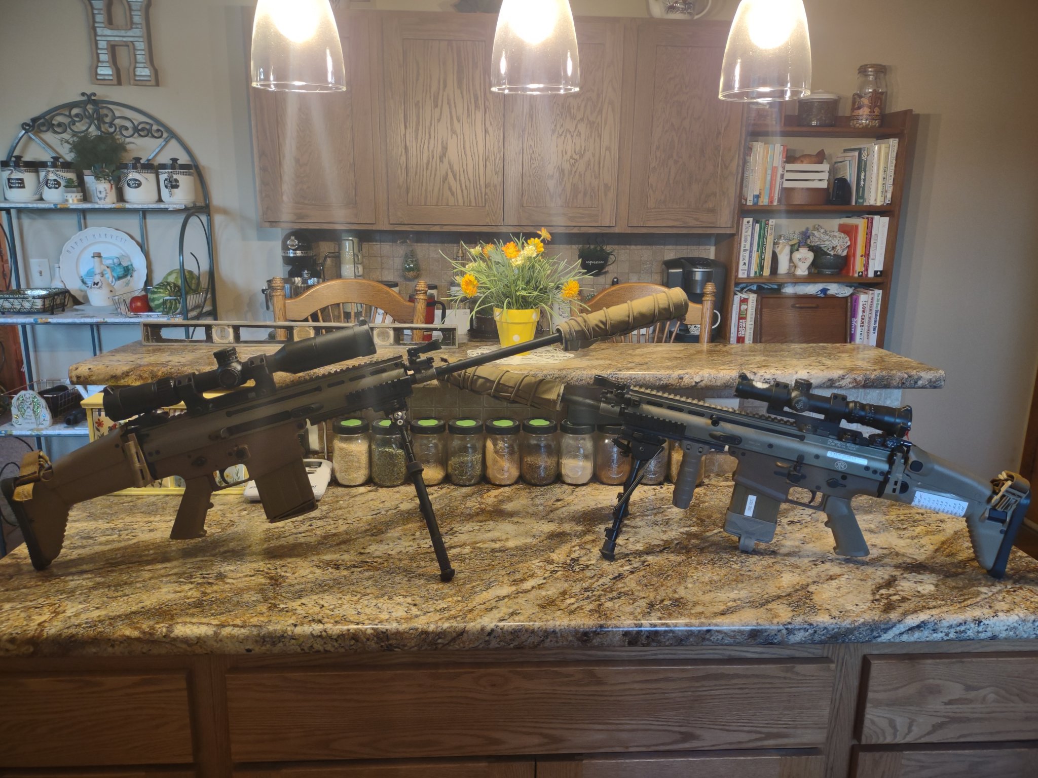

I love my scar 20s in 6.5. I never heard about the popped primers but I had the same experience a couple months ago. I was freaking out about it as the previous sessions never experienced the issue. So I checked the lot numbers on my ammo and it seemed to be a single box of one lot that was hot. Hornady 140 eldm's. Next box of my regular lot number was fine. Only other thing that pisses me off is how loud it is suppressed. My scar 17 is nice and quiet, both 20s' are loud. I have a tbac 338sr on the 6.5.

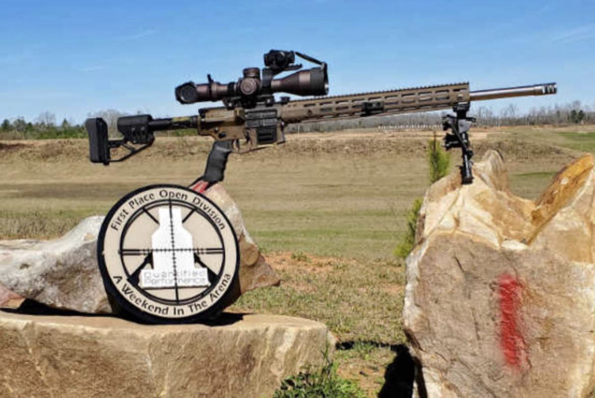

My Seekins SP10 has been an awesomely accurate rifle. Had an MDRX in 6.5 but really didn’t shoot it enough to get a good feel for it. Have a Knight’s SR25 in 6.5 for work that hammers and feeds the 140 hybrid targets that jam in my Seekins. Just got a GAP-10 in 6.5 but haven’t shot it yet. Budget will really determine what you can get.

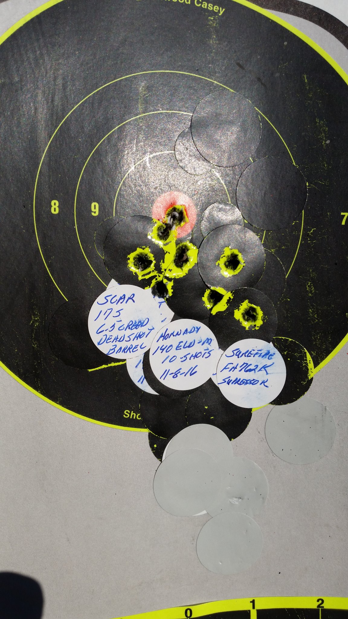

I have had a SCAR 17s in 6.5 CM since 2016. I had an extra 16" 308 barrel assembly that I sent to Dead Shot Barrels and they used the OEM bolt, gas block , receiver extension , and bottom metal and made me a 20" 1in8.5 barrel. It shoots better than I can and I haven't experienced any problems with it even running it suppressed with my SF 762K suppressor. Below is a 100 yd group . I shot the first 7 rounds then shifted my grip and position and the last 3 went lower and right I apologize for the large pictures.
