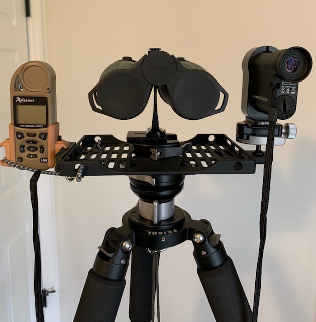

May not be the direction you want to go, but you could mount an Abel Table to your tripod and then your bino's and a red dot to the table using RRS clamps and Abel/Mlok accessories.
Yikes, their site is extraordinarily uninformative. I don't quite follow how the tray attaches to the tripod nor the tray to binos and the additional red dot. It is a bit large for what I was originally thinking of, but if that is the best solution...I can get behind it.

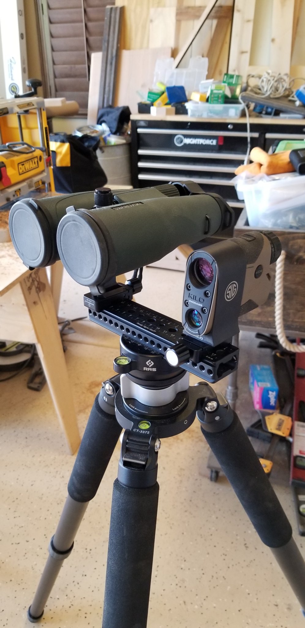

Check out the RRS Cinema Rail at Mile High.

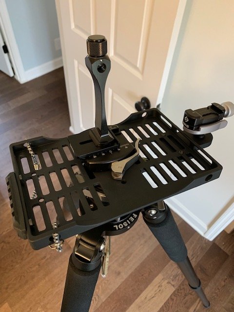

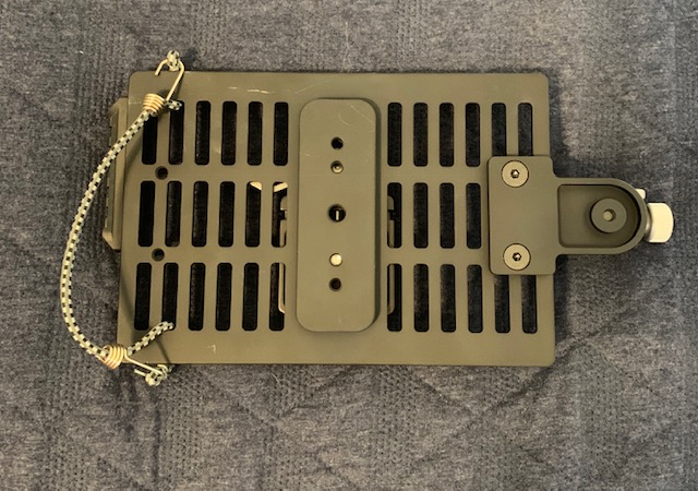

On the bottom of the table is a RRS/ARCA spec dovetail that will interface with your Anvil head.
Here is what I used to attach my Swaro's to the table. Again, this may be overkill for you, but it might give you another option. Note that the open slots on the bottom are MLok, so you can attach a picatinny rail and mount your red dot to that.
