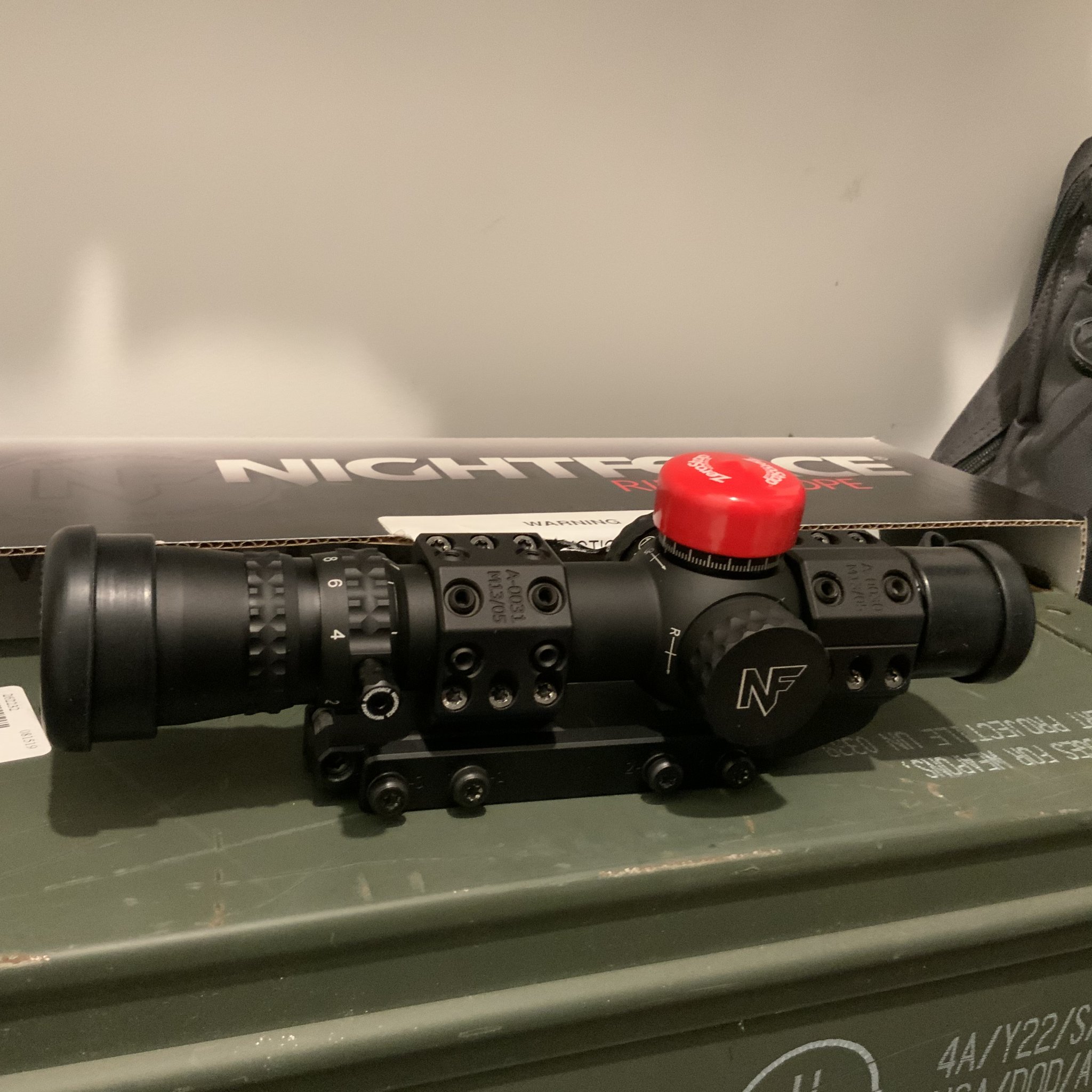

    I picked this up to put on top of a Noveske N6 12.5 in barrel pistol..waiting now almost 5 months for them to finish it up.

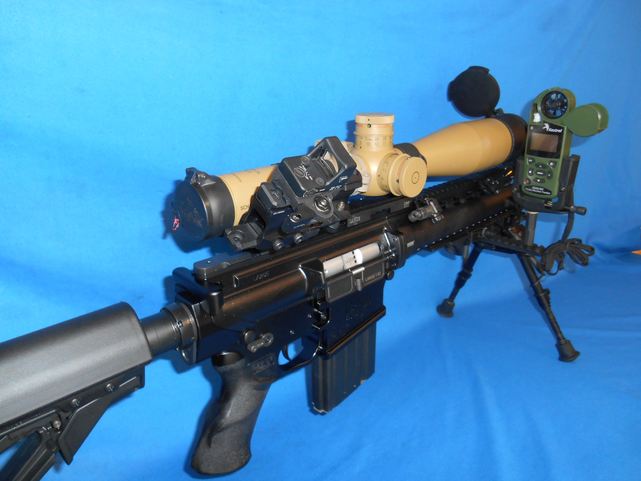

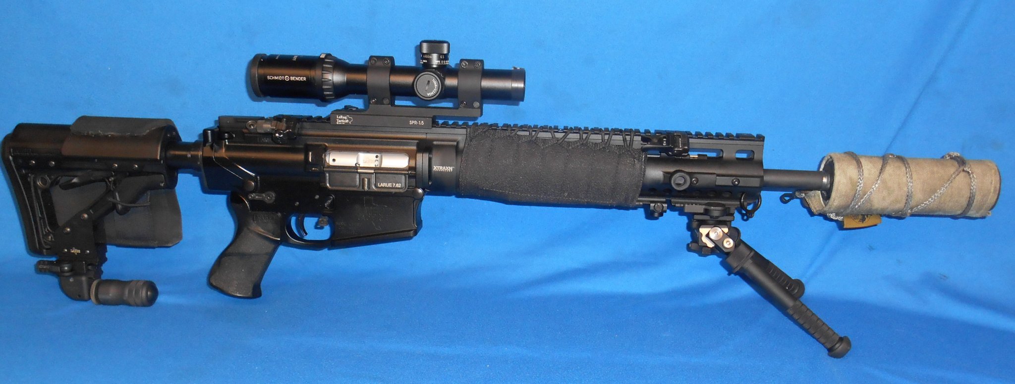

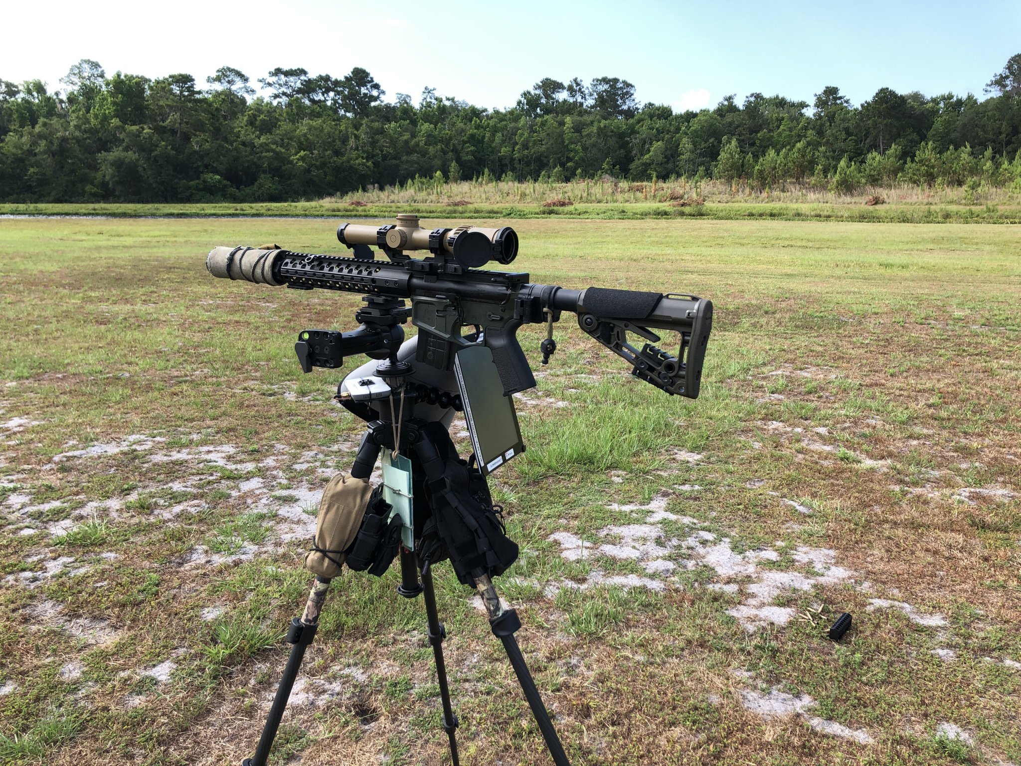

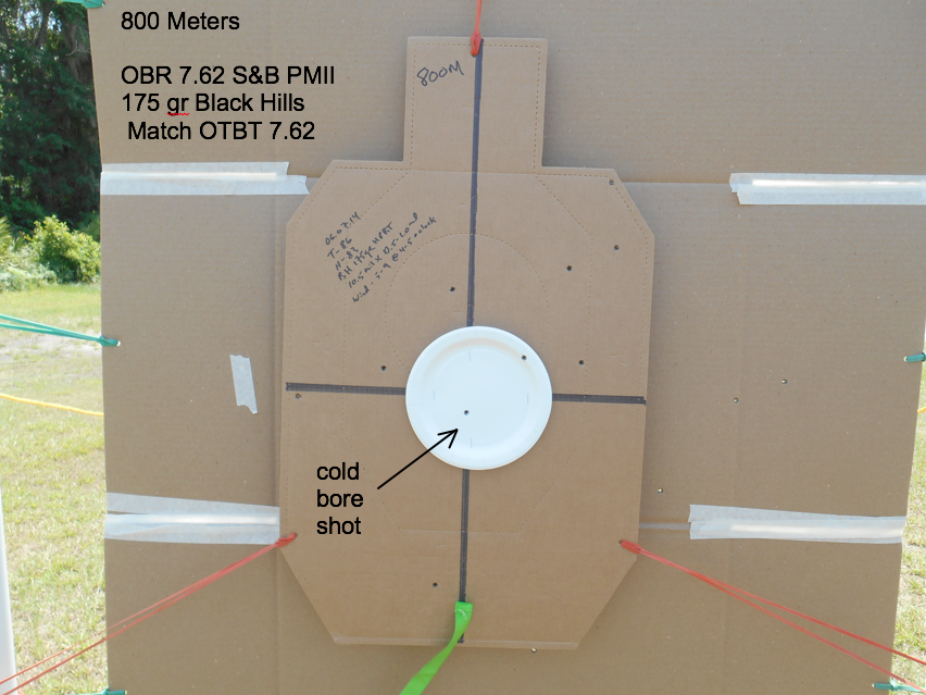

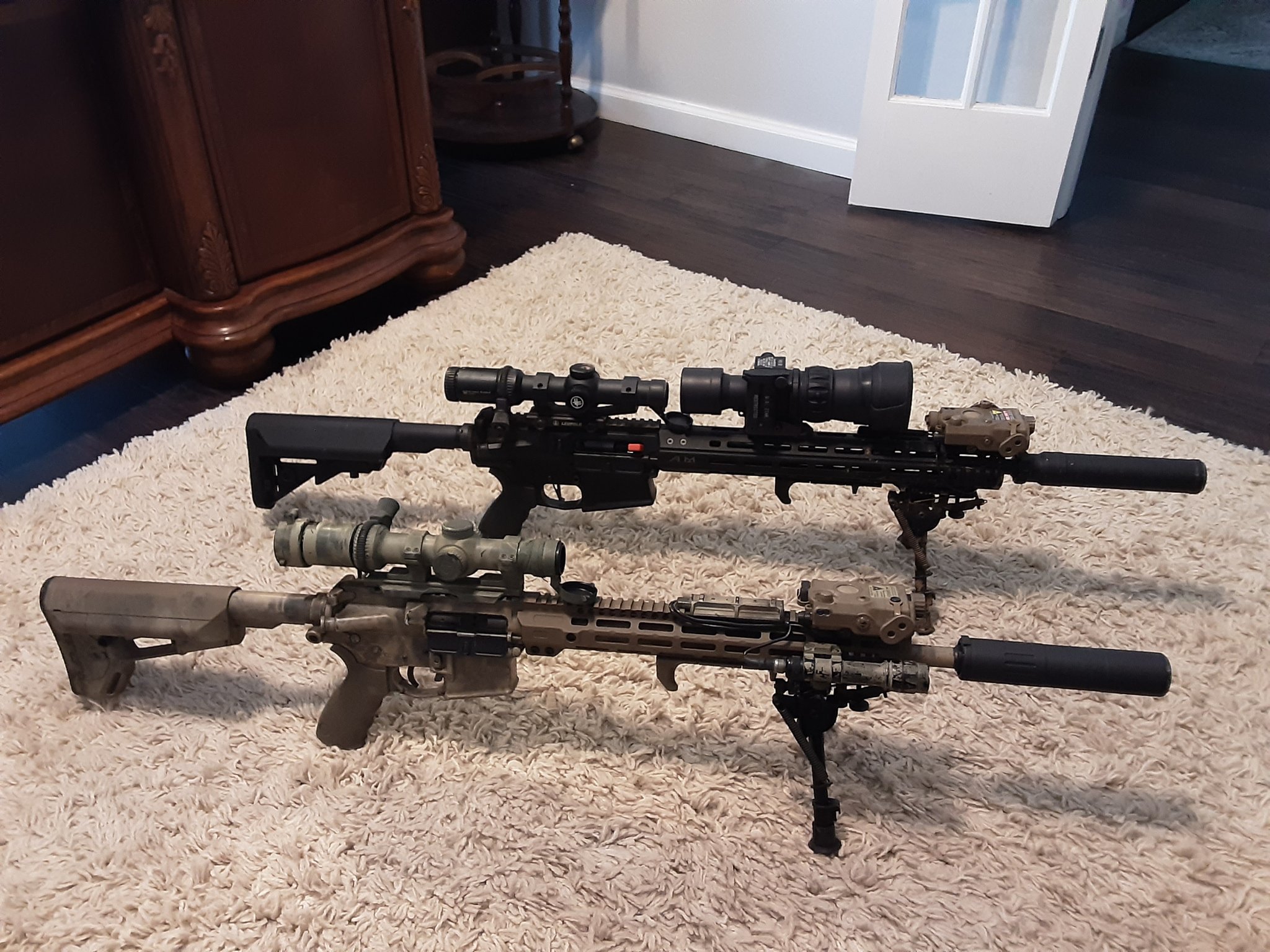

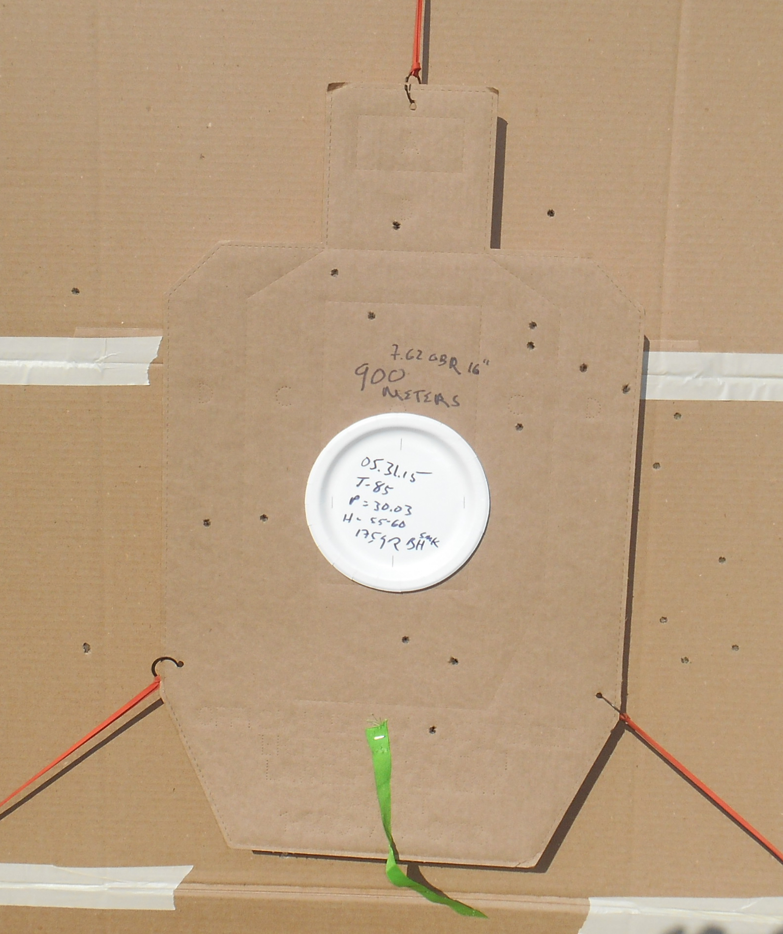

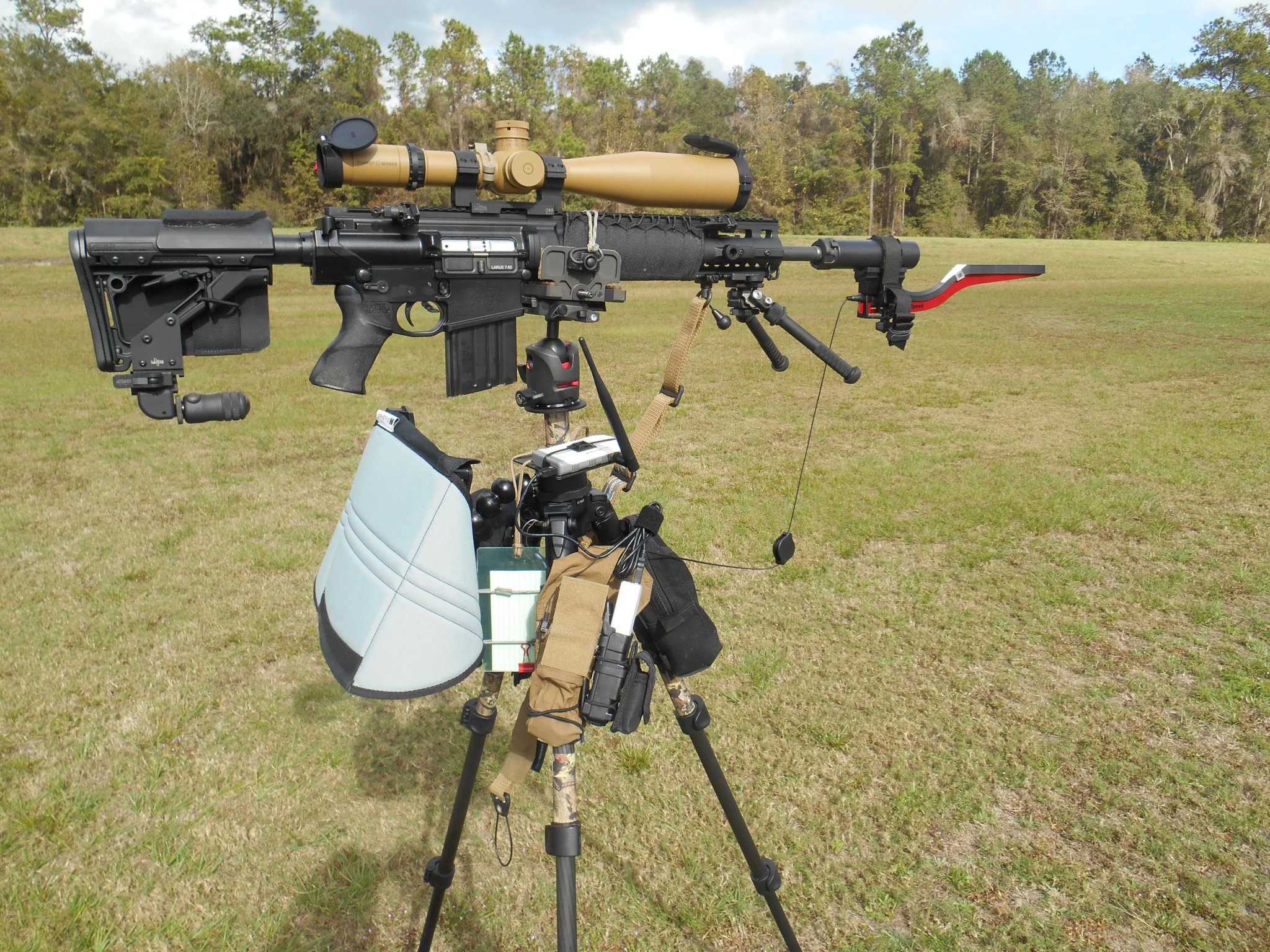

    Since I'm sheltering in place I'll add a few comments. My only 16" 7.62 is a LaRue OBR. I have configured it with all sorts of optics for fun. I would not even consider it for a SHTF choice, however if I had to use it as such the most practical combination is probably having the SB 1.1-4X short dot with calibrated turrets. Most commonly I run a SB 5-25 with / without a RMR zeroed at 100 M, as such I have had cold bore shots at 800M (when the round is transonic) and it still is pretty good at 900M with factory ammunition. I have quite a few SBR's so If I had to choose a heavy caliber (probably not a great choice for any SHTF scenario) it would be my Wilson Combat 6.8 SPC II 11.3" with S&B 1-8 short dot with dual CC MDR-T6 reticle (shown last). So a gas 16" 7.62 is quite capable of fairly long range shots; up close is easy with red dot optics.

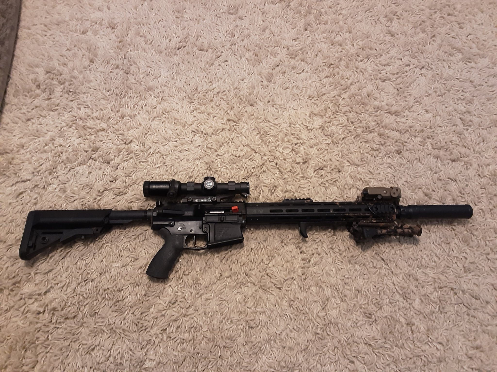

    I run a vortex 1 - 8 on my 16" .308. Usually using 168 SMK or TMK. This has become a real multi purpose gun, from longer range pigs and coyotes to range fun. I also have a .223 in almost the same spec as well
