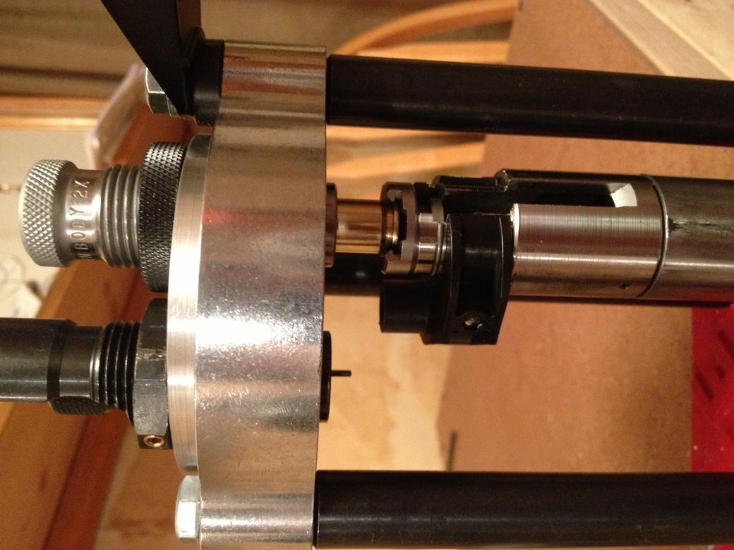

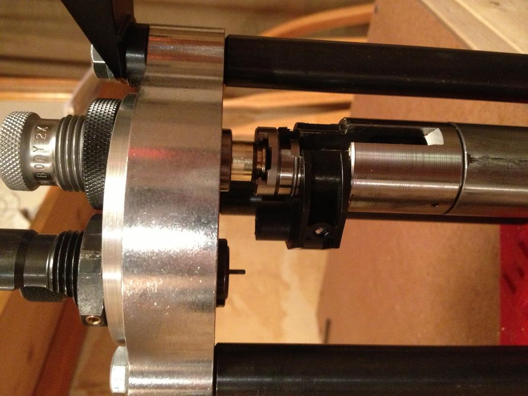

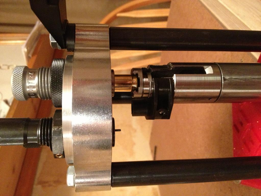

All casings measured exactly .470" at the point where they longer fit into the die. This is a slightly different spot on the casing with the different brands of brass. Sorry the pics are sideways but you get the point. Does anyone know if the die is supposed to be able to accommodate casings of this diameter? I'm starting to think my chamber was cut oversized.
Once fired Lapua
http://www.snipershide.com/shooting/attachment.php?attachmentid=18636&d=1381607696
Once fired LC
http://www.snipershide.com/shooting/attachment.php?attachmentid=18637&d=1381607741
Once fired FGMM (excluded the 4x fired stuff)
http://www.snipershide.com/shooting/attachment.php?attachmentid=18638&d=1381607791
virgin Lapua actually fits
http://www.snipershide.com/shooting/attachment.php?attachmentid=18639&d=1381607816
