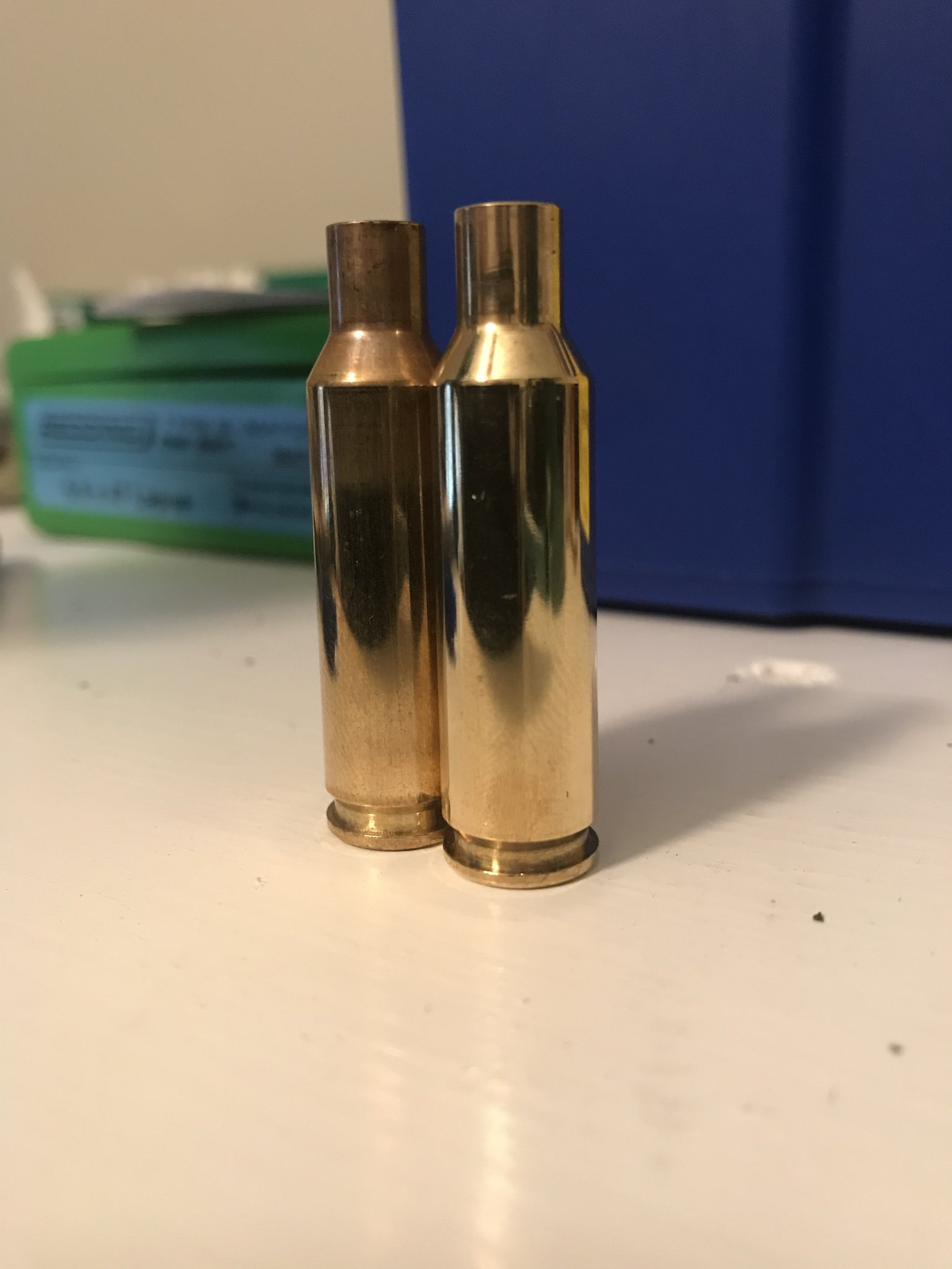

Loading for 6.5x47 and when I resize the bushing leaves a slight bulge on the neck. Don’t feel any resistance with an unloaded case, when I chamber a loaded round it feels snug. Any reason to be concerned or anyway to correct?

Really hard to tell but when I load it seems to be more pronounced

Not sure if it's your pic or what, I do not see the bulge, but one neck looks way longer from that angle, too long of a neck would yield the same feeling when chambering a round. Have you trimmed, or what are your case lengths?
