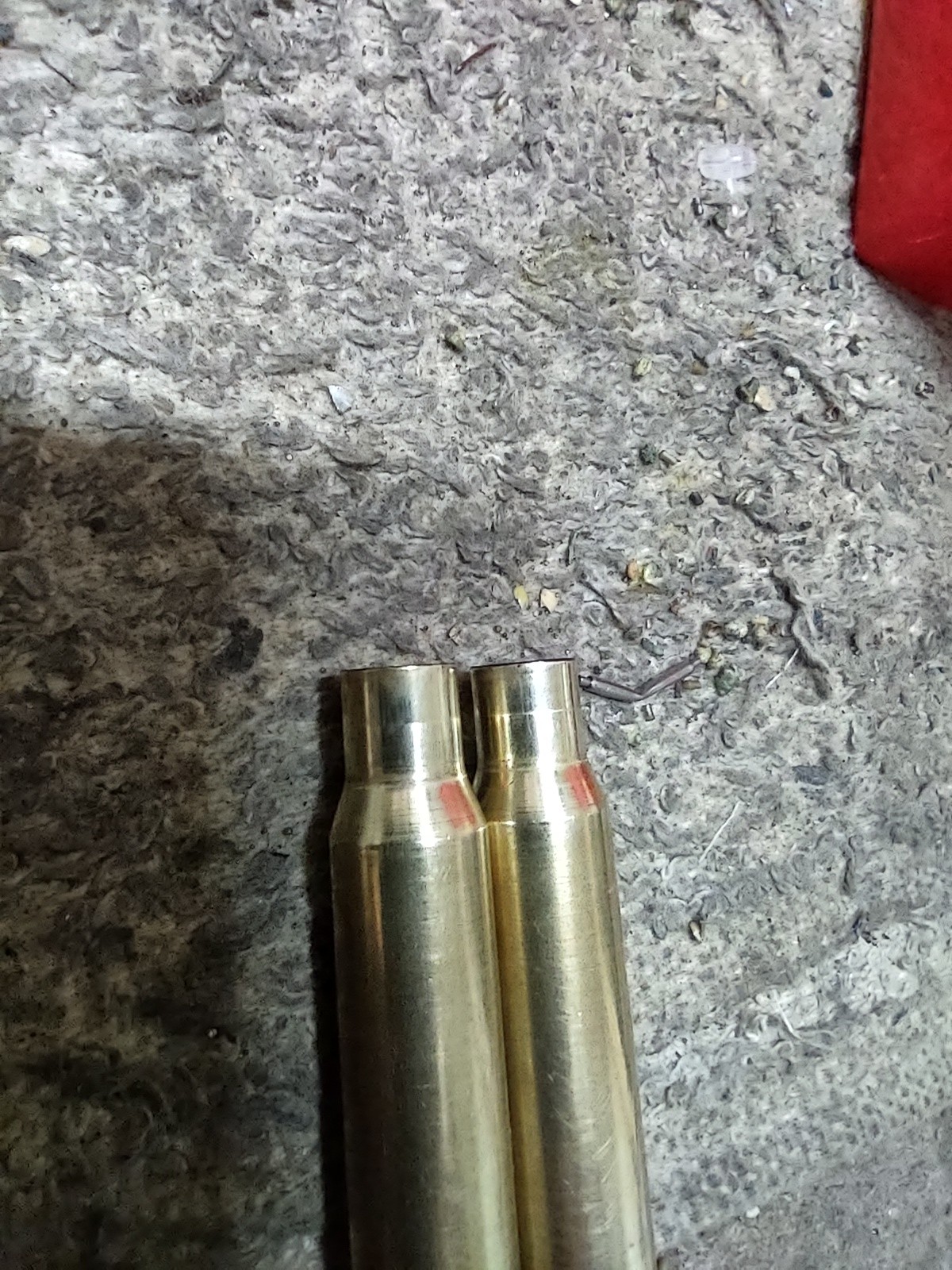

I'm using a Redding Type S precision bushing die on my 308. Full length die. As shown in the photo it's only doing the neck half way down. I tried an old rcbs die and it does the whole neck. Is this normal on the Redding? I'm bumping the shoulder about 1-2 thousandth
. Thanks.
Screw the die top down until it stops.
Back it out 1/16th to an 1/8th of a turn.
Shake the die. You should hear the bushing click a tiny bit.
That's it. You're done.
It will size about 90% of the neck.
That's the way it's designed.
