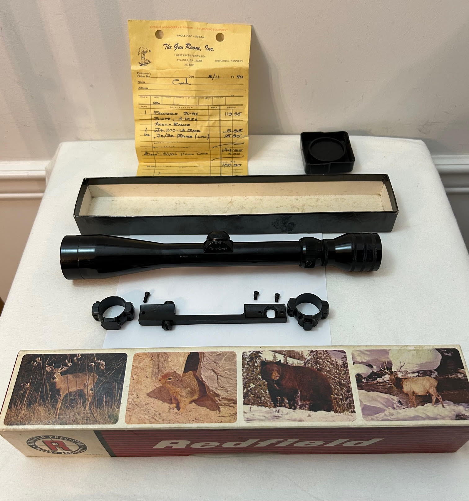

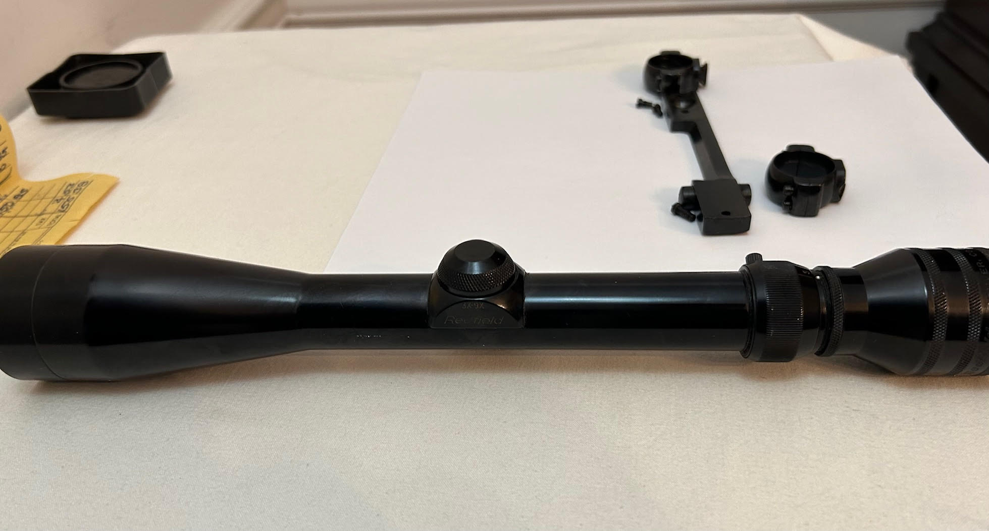

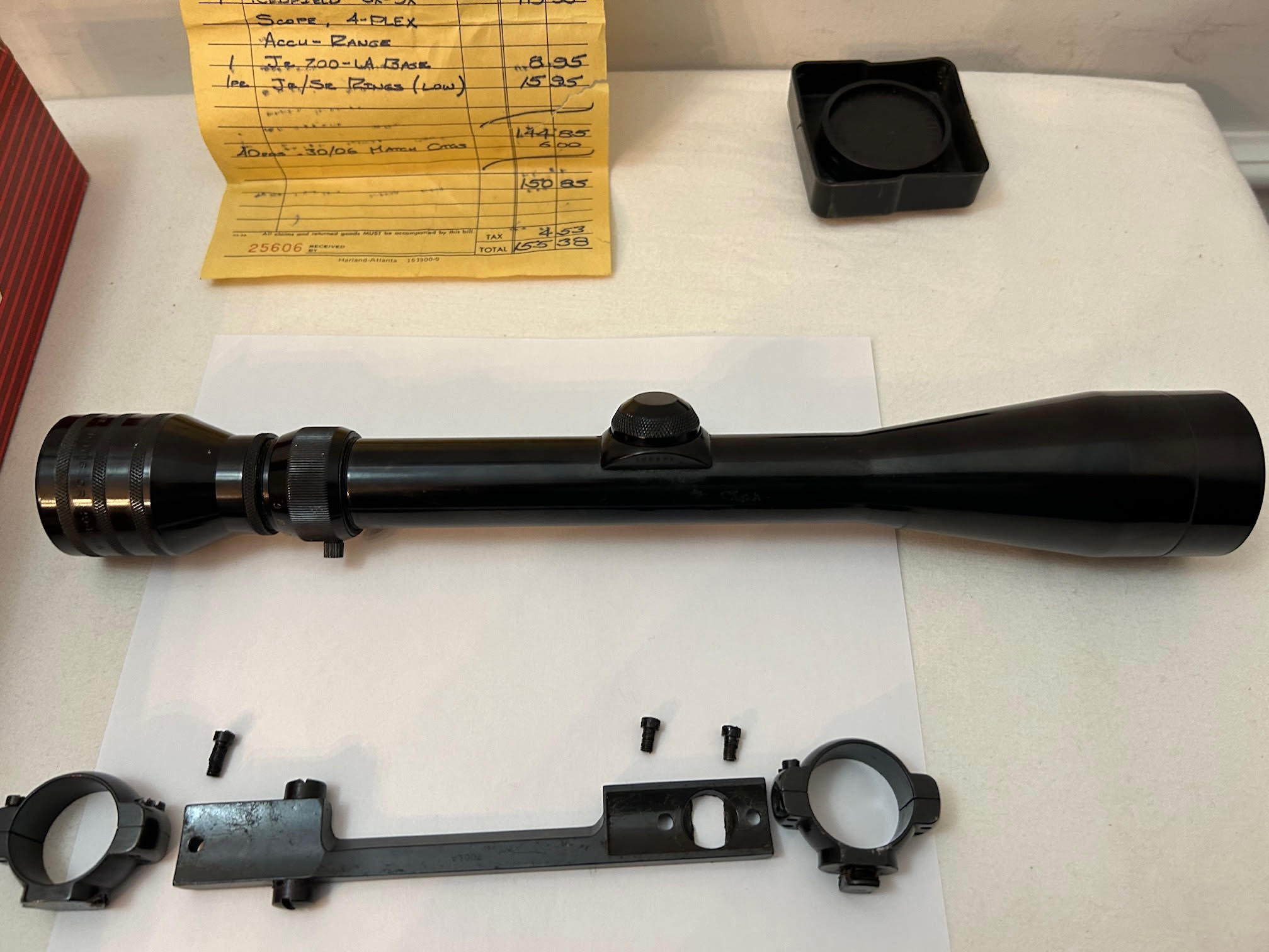

Looking for advice on a good way to sell a Redfield 3x9 Accu-range. I acquired it in 1970, and have the original box, bill of sale, and even the original Redfield mount and rings for an R700. It is the civilian version of the military Vietnam era scope. It's in excellent condition. I'm getting old, and the time has come to start unloading goodies since they cannot come with me.
Looking for advice on how to fairly sell this beauty and get it into the hands of someone who would get happiness out of owning it.
Thanks.
Thanks.
Pics of above. Sorry about duplicates. Not yet familiar with site.

How much do you want for it? Do the rings have any stamps. 1" or 64? Thanks
The bottom of the rings look like they are stamped "1".
I'm still trying to figure out what a fair price is. I saw a "new old stock" offer for $2400. Mine is used, but in excellent condition.
