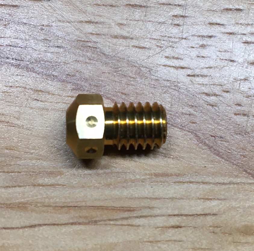

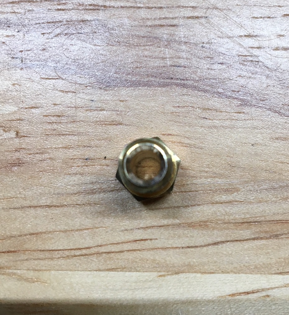

I found that 3D brass printer nozzles with 6mm (6M) metric threads fit the Autotrickler. Amazon has lots of them cheap: Here
You do have to drill them out with a 1/8" drill bit and then chamfer the ends so not exactly plug and play, but fairly simple.
I tested with IMR8208 and H4350 powders and it worked very well with no overthrows. I did have to adjust the angle of the Autotrickler and also change the slider bar position to work better with the nozzle in place. Without the reducer nozzle I would get slight overthrows every 5 to 10 times. A very nice improvement.
