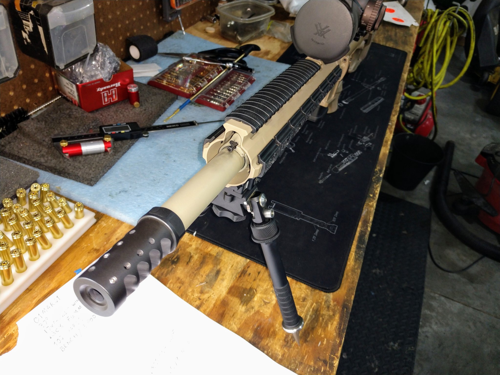

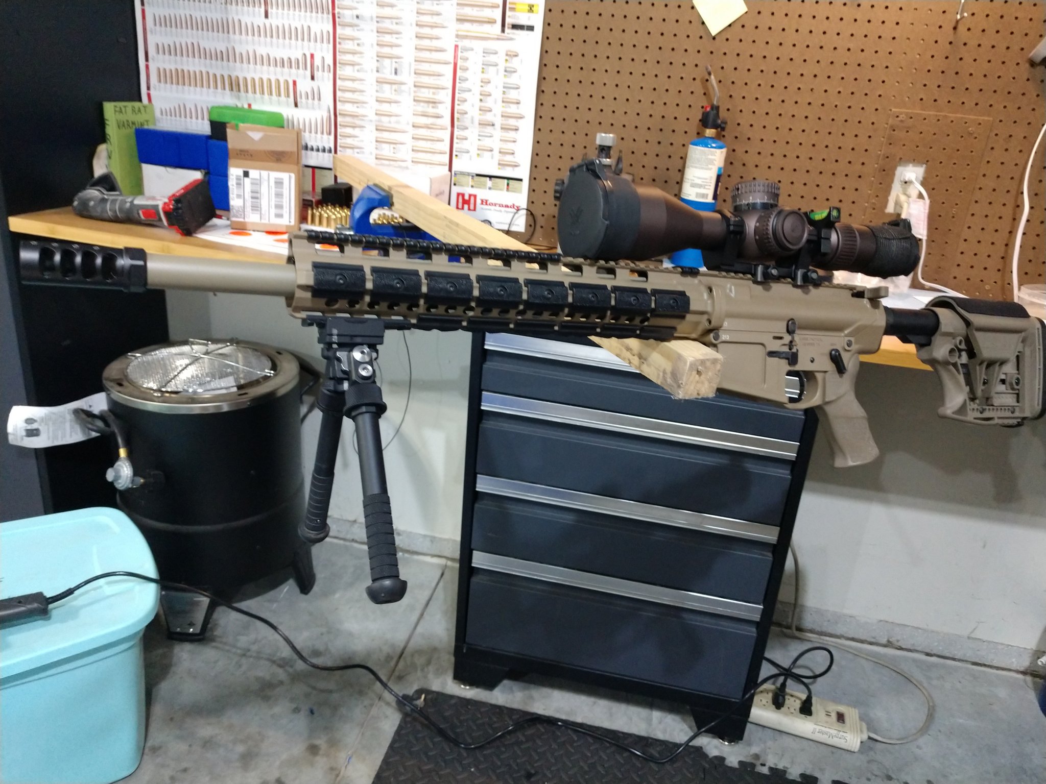

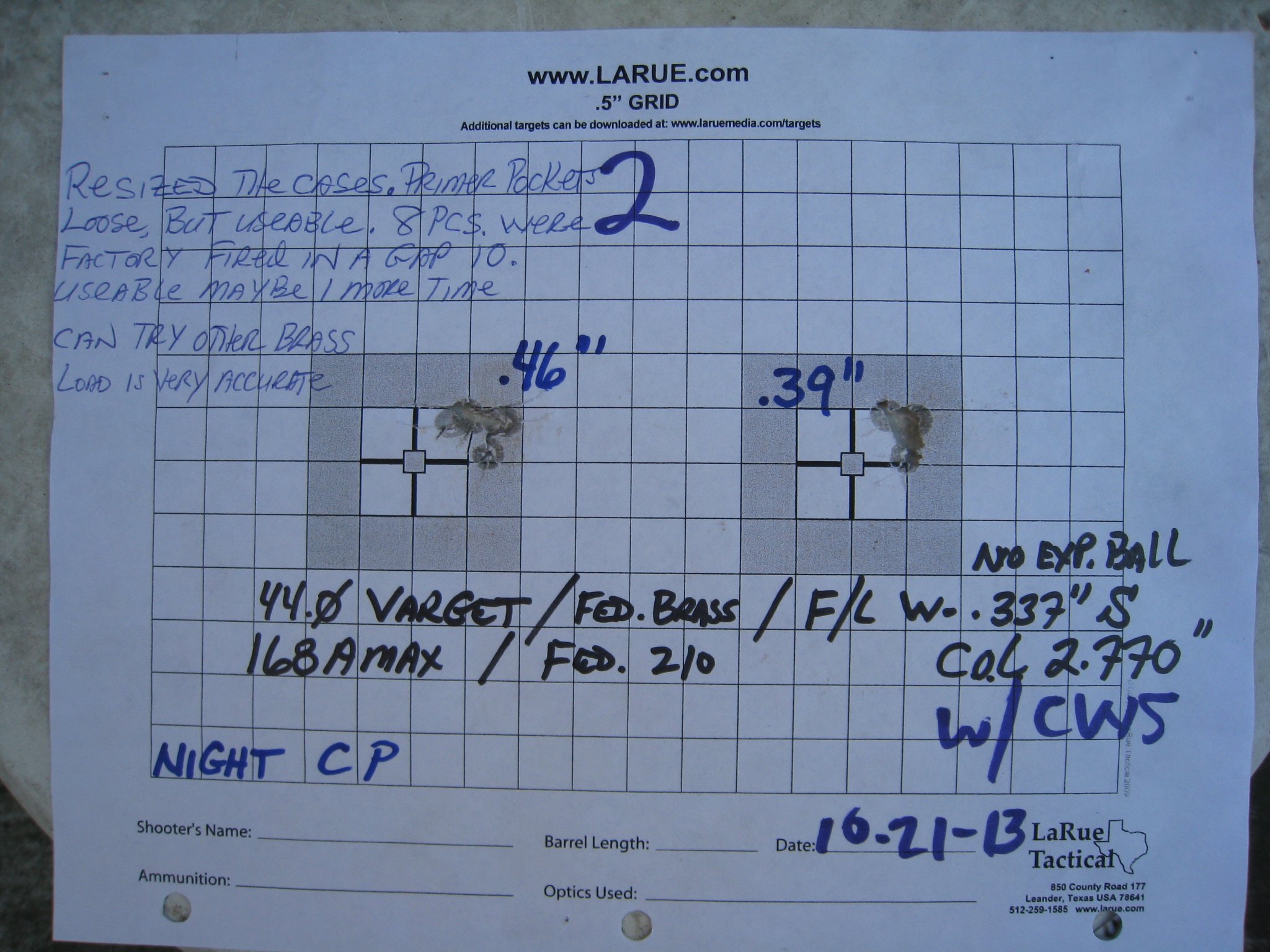

    Just thought that I would share a little preview of a .308 Barrel Review I'll be doing in the near future for a Compass Lake Bartlein Barrel.

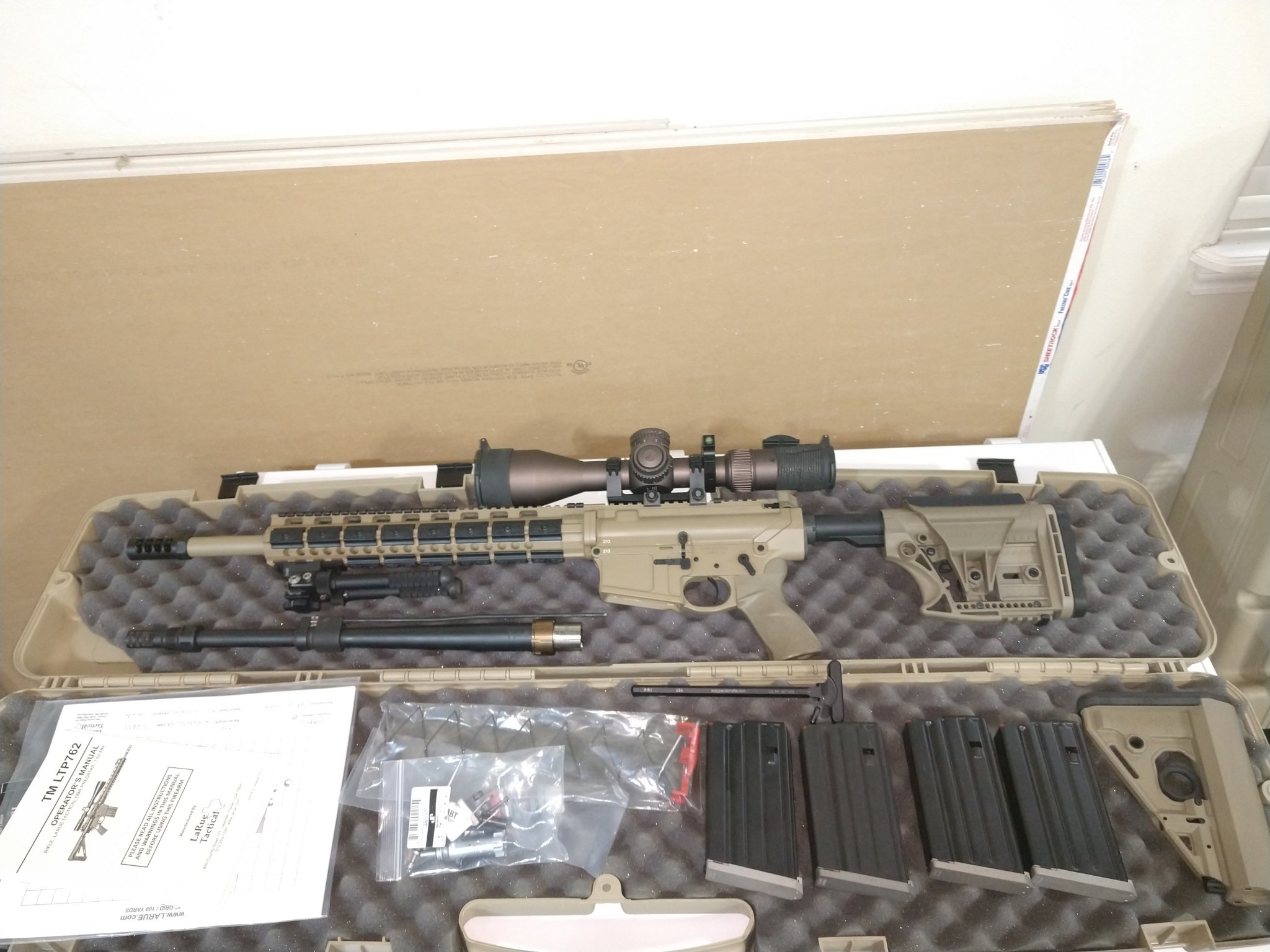

    Picked up a LaRue rifle that was plagued with some barrel and bolt issues so I decided to rebarrel the rifle instead of selling it and thought I do a Range Report and review for y'all. I wrote a thank you note on the Compass Lake Facebook page and supplied some pictures from today.
    I haven't been this impressed by the performance of a barrel in a loooong time and I'm looking forward to sharing my experiences with all of you in the upcoming reviews. For a barrel to shoot this accurately with less than a 70rds downrange and to group like this while fiddling with parts that affect the accuracy is truly impressive. Hopefully next week I'll be able to meet up with @FALex at a 100yrd Indoor Range and test out some of my Handloads I've got ready to go and see what this thing can truly do without being influenced by the freezing temperatures and high winds of Idaho. I want to get a second shooter behind the rifle and possibly get some video footage for the review.
    "Thank you to CLE"…...................
    I just want to take a moment to personally thank Frank, Theresa and especially Paul for the outstanding work y'all did on this barrel.
    I had the Compass Lake family spin me up a Custom Bartlein .308 Barrel to replace the less than stellar problematic OEM barrel that came in this rifle.

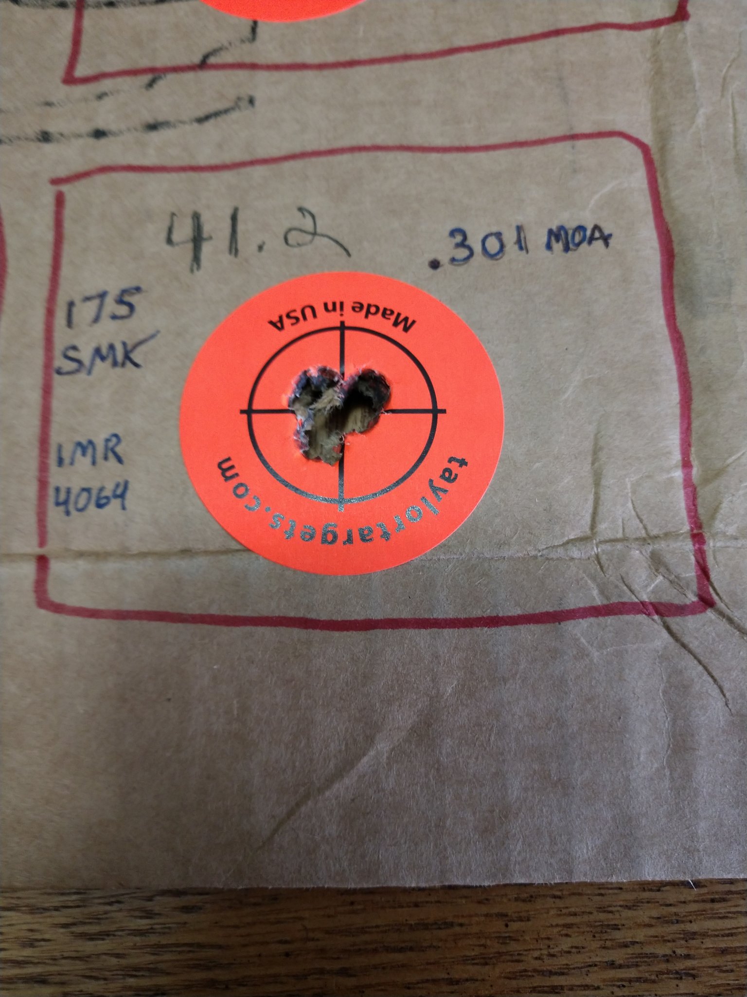

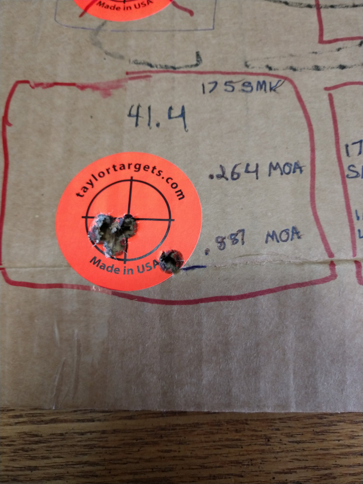

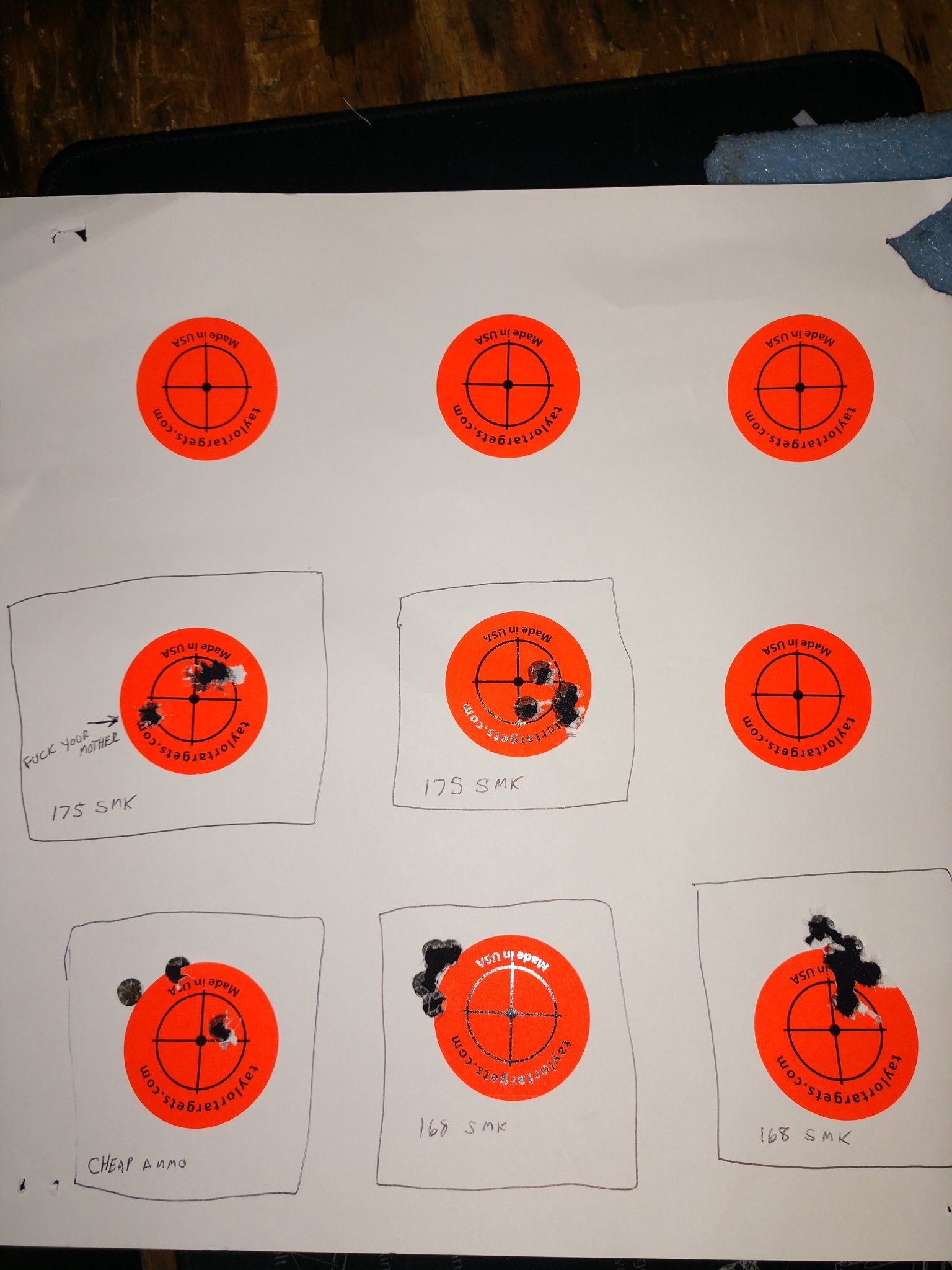

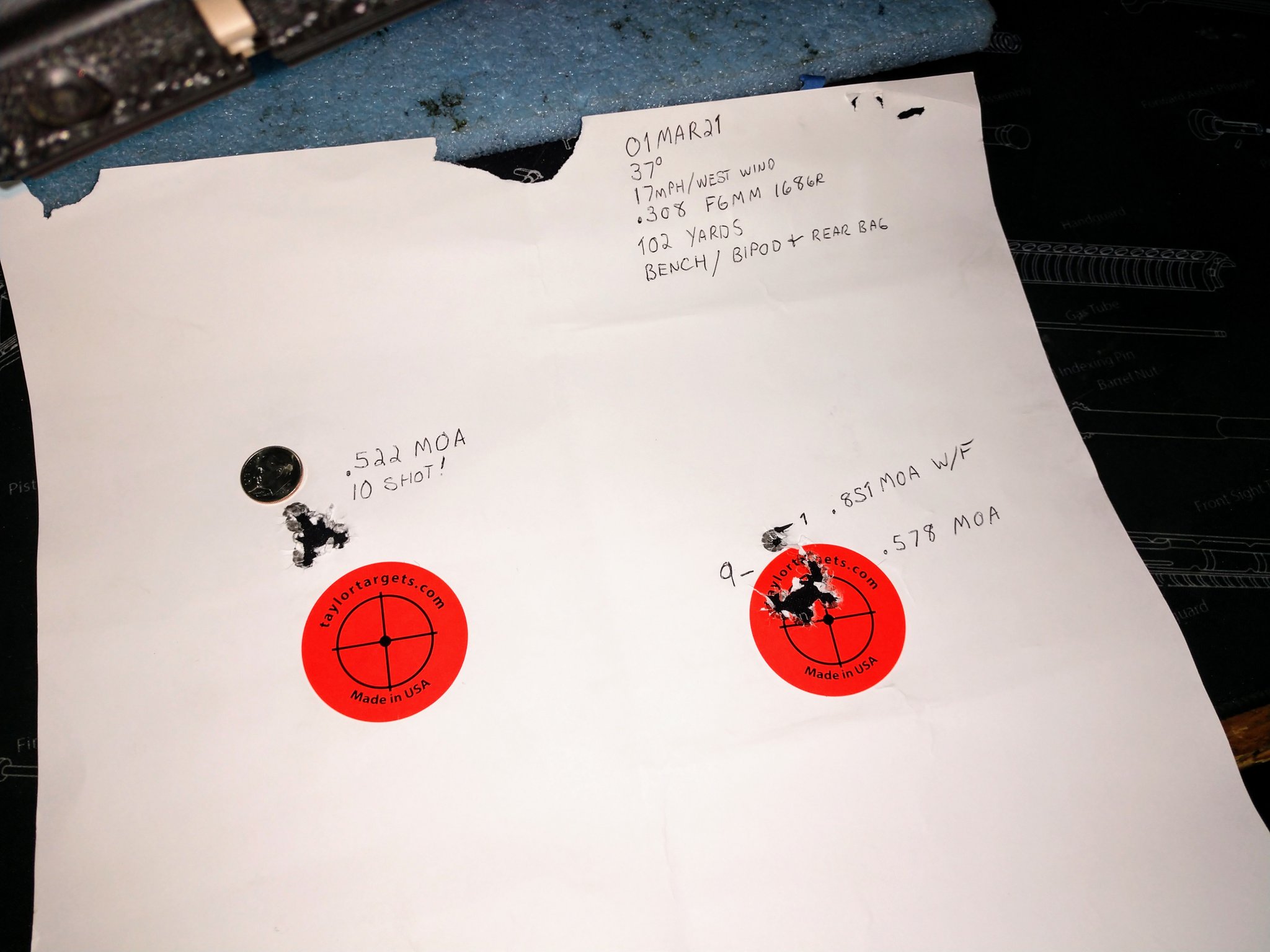

    These two 10-shot groups were shot one round at a time, checking for BCG lock back while conducting barrel break-in, Muzzle Brake, Gas Block and Scope adjustments! in less then ideal weather conditions. Compass Lake Barrels consistently shooting 1/2 MOA or less is pretty much the norm but this one truly has impressed me with less than 70 rounds down the barrel and store-bought ammo, can't wait to see what handloads and favorable conditions produce.
    Job well done.
    The American Precision Arms Gen 3 Little Bastard Brake with the adjustable ports really helped put the icing on the cake as far as adjustability for this platform and how far it can be dialed in, not only is the 18" Bartlein Barrel with Rifle Length Adjustable system super soft to shoot but now the recoil is directly to the rear and centers itself perfectly back on POA.
    These were the first rounds out of the barrel, pretty damn impressive considering I was scrubbing the barrel in between shots.
    M110 Contour.
    Perfectly balanced.........

    Don't give up on it! I have a CLE Bartlein on my 308 also. I'm sure as soon as yours is broke in and conditions are better with some handloads your groups will tighten right up. Maybe let someone else shoot it as a comparison.:whistle:
    Great shooting. Nice to see someone with an AR10 that's "sub MOA all day" who's actually posting groups to back it up.:)
    And as accurate as the gun may be, you're certainly doing your part. That's outstanding shooting on a platform that a lot of us struggle with.

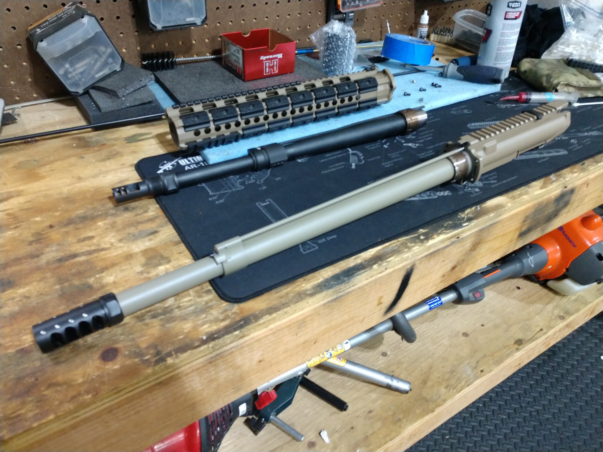

    I'm interested in what it took to get the larue rebarreled - thinking of doing it to my tOBR, what does it entail?

    Nothing special, you'll have to decide what barrel length and contour you want and then just send in your LaRue Bolt to Compass Lake and they will do the rest. You will need to buy another tOBR barrel nut and a adjustable Gas Block/Tube.

    That's actually an interesting question, several years ago when I started rebarreling LaRue rifles I discovered that the barrel nut torque can and will affect accuracy and POI. I ran several test shooting groups with the barrel nut torqued down to various torque values.
    And oddly enough I found out that they generally group better on the lower end.
    My .308 FDE aka (PredatAR) has a sweet spot between 35-40 foot pounds. And my OBR preferred to be between 50-60 foot pounds. I was completely convinced that this had to to do with the receiver face not not being true and square, but both the receiver faces were GTG.
    If you have Compass Lake spin you up a barrel for your LaRue they use a barrel extension that is larger in diameter so it has to be thermo fitted, but this increases the rigidity of the complete upper provides, better barrel harmonics and keeps the upper receiver and barrel in sync with each other as they swell under heat.
    If you plan on using the old barrel as a bullet hose for surplus ammo and your new barrel for precision work obviously you'll need more of a slip fit so just make sure to remind them to turn the barrel extensions down a couple thousandths.
    And if you're a little apprehensive about doing this just send your upper receiver in with your bolt and have them assemble it for you.
    Another reason why I'd recommend you sending in your upper receiver is because some LaRue rifles have different feed ramps, The OBR does NOT have extended m4 feed ramps but the predatAR does.

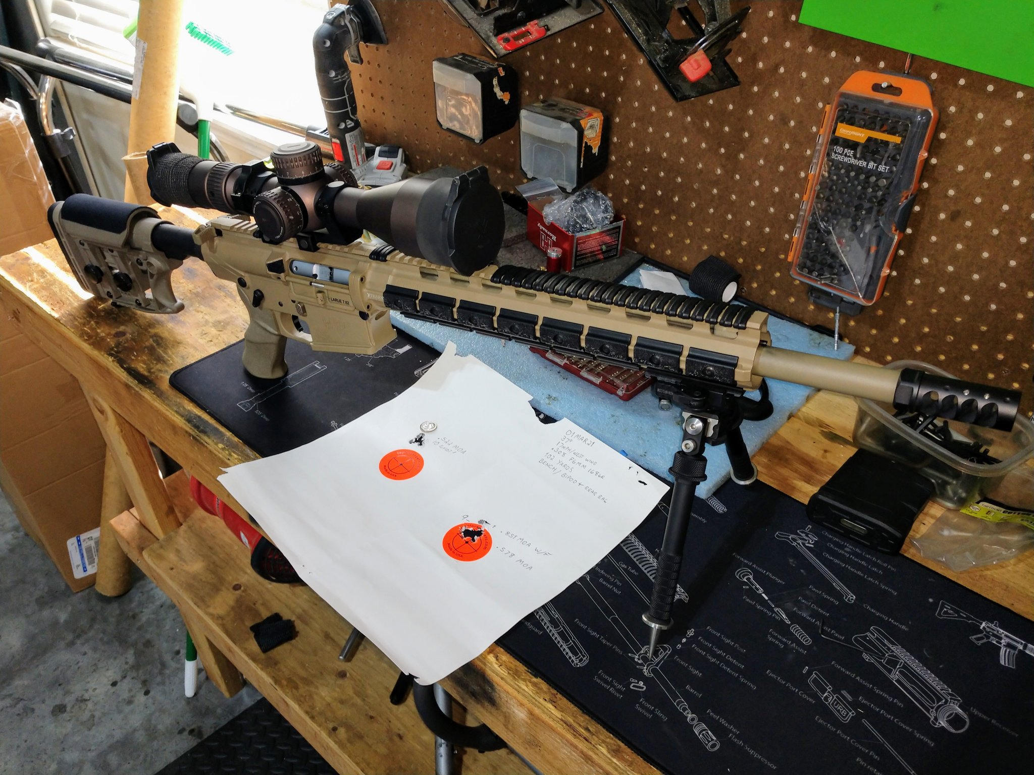

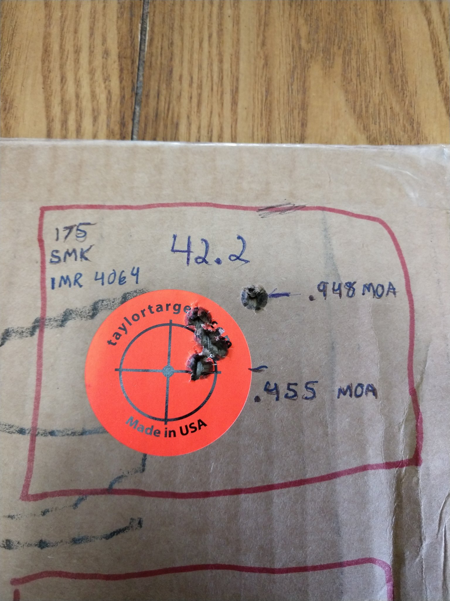

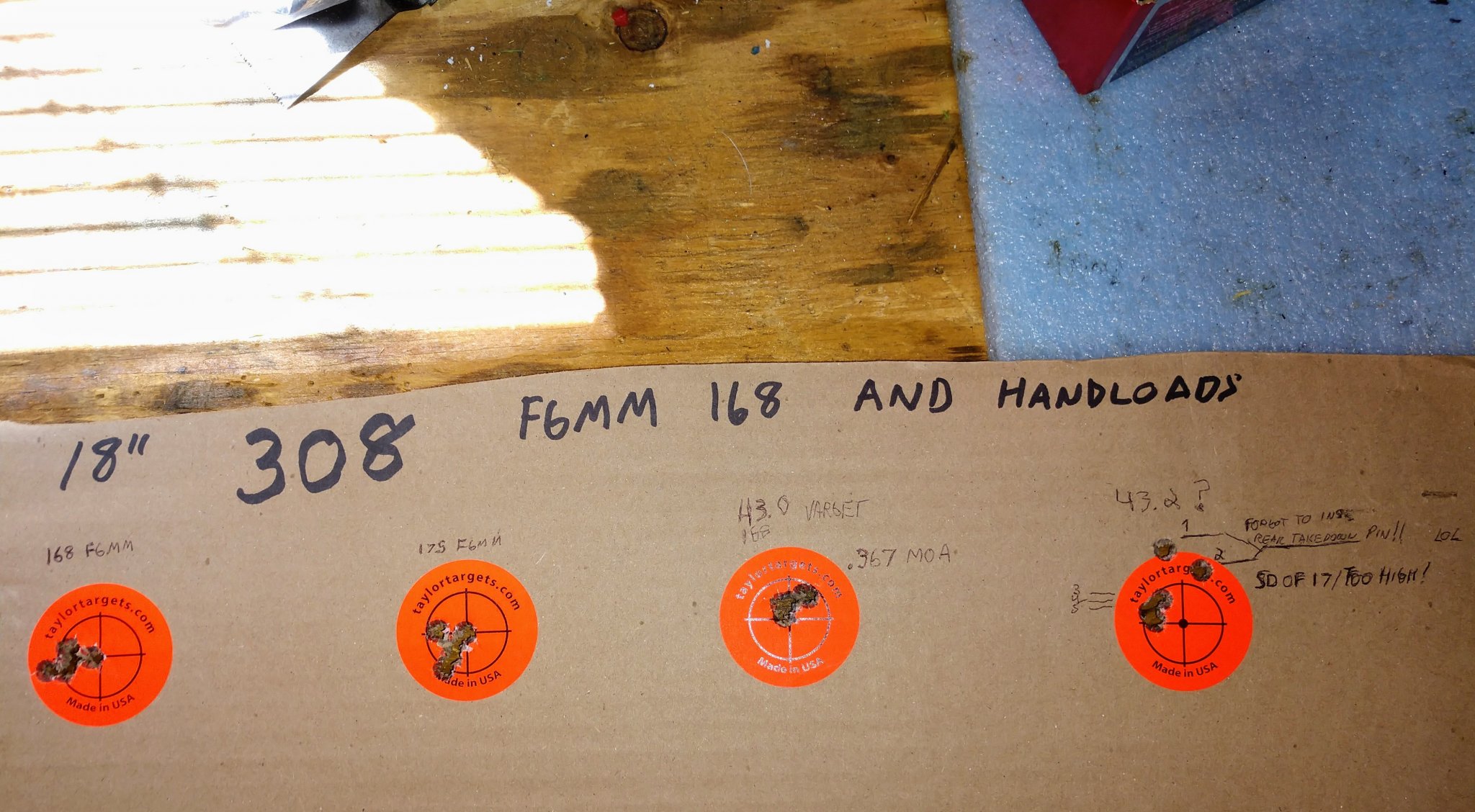

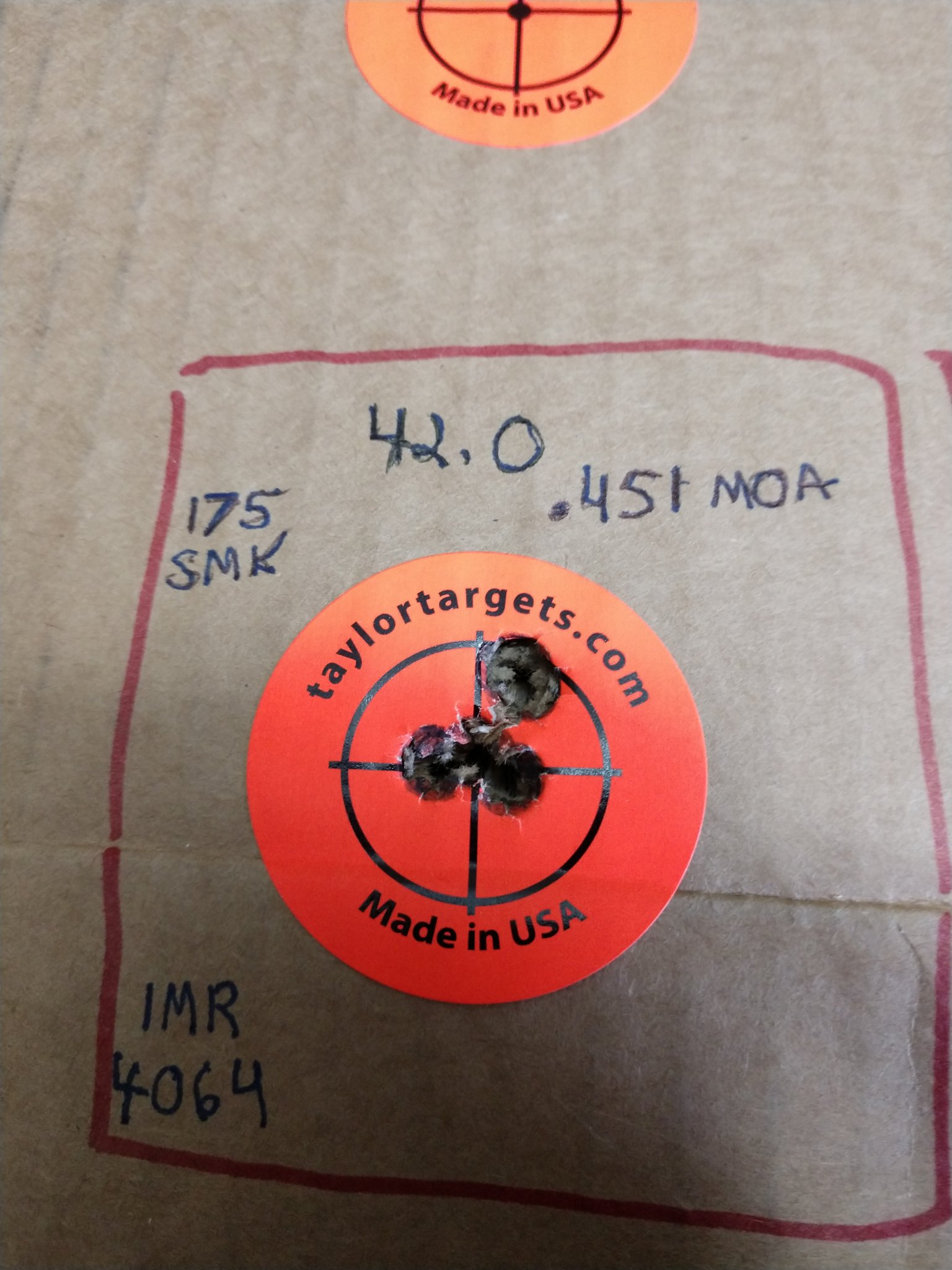

    Just FYI this thread is not done, I just haven't had a chance to get to the range in a while due to VA appointments and surgeries. The last time I was at the range I retested the federal gold medal match 168 and 175 and confirmed my pet load for the 168's with 43.0grs of Varget and for shits a giggles tried 43.2grs but the SD shot up to the double digits so I'll be sticking with the 43.0grs with a SD of .06 with the 168's. Oh yeah!! and I can also show you what happens when you forget to insert your rear takedown pin...lol. Best part is it still shot sub MOA..lol
    Now that The barrel seems to be completely settled and I have little over a hundred rounds of fire formed starline match brass and a solid pet load I plan on shooting a 5x5, I don't think she'll have any issue averaging sub-half MOA.

    Thanks, I never thought I'd go back to 308 not after shooting those 6.5 wind cheater bullets for so long.
    Never in my life have I ever forgot to insert the rear take down pin before..lol when that first shot went high, I thought to myself there's no way 0.2grs of powder could cause the POI to shift that much so I sent the second round and it went high and right and there was a very noticeable change in the recoil impulse of the rifle, it felt like severe bolt bounce so I broke my cheek weld and and lifted my head off of the stock and well... "Here's your sign"!! Anyways I popped the pin in and drove the last three rounds almost in the same hole. I was definitely impressed that is shot SUB MOA even with a my Grade-A Fuckup though.
