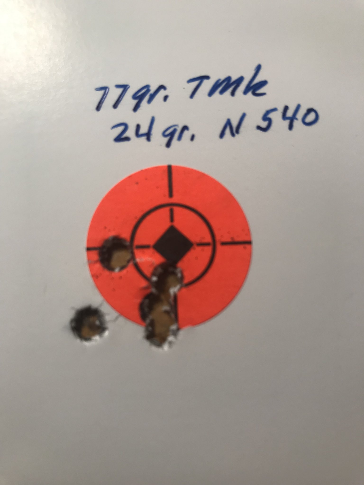

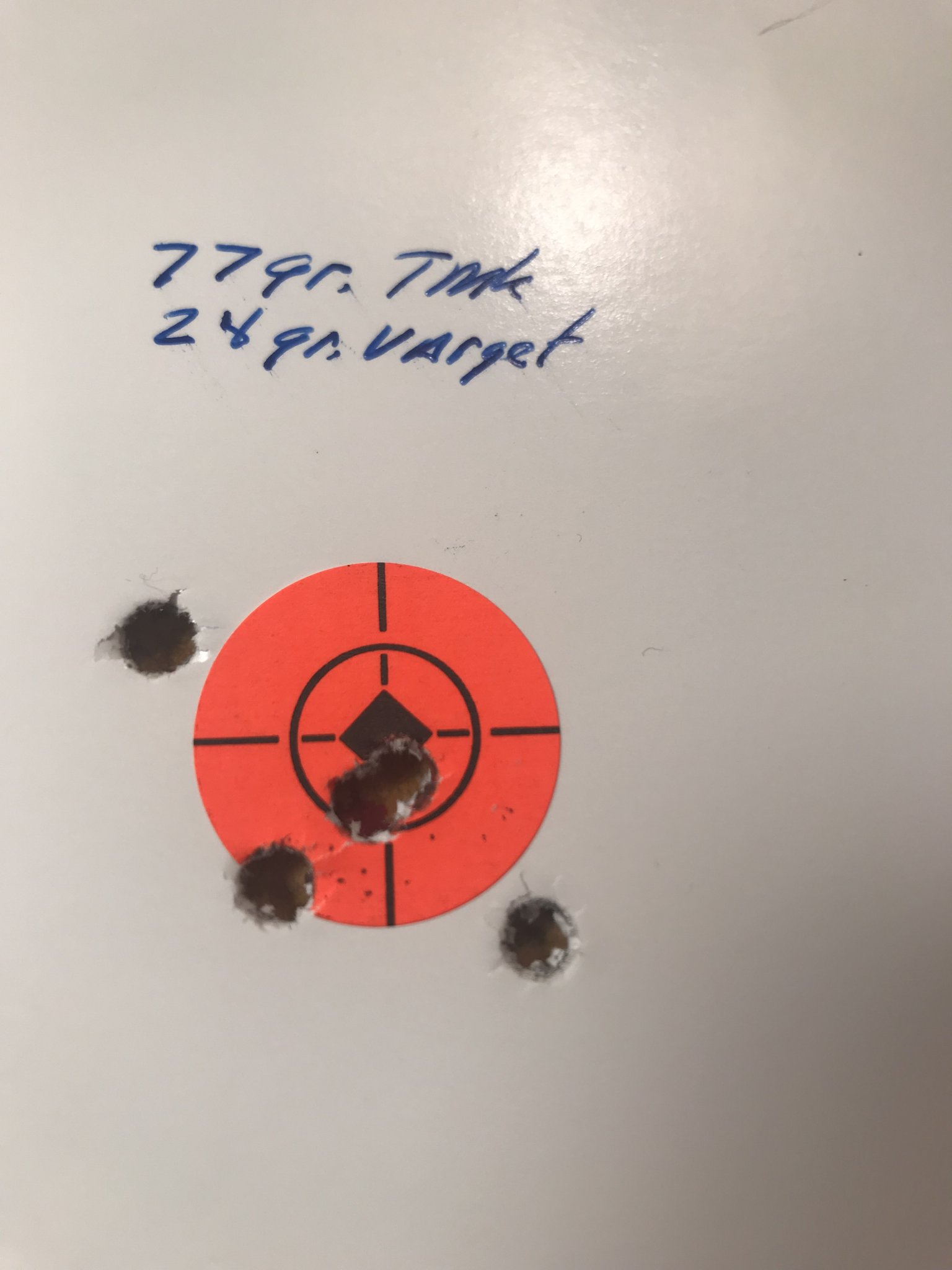

I finally had a chance to get it out today and fire the first 25 rounds through it. I loaded Winchester brass, Rem 7.5 primers and used the 77 gr. Smk's. All were seated to the same depth. The only variable was powder, which is identified in the pics. image.jpegimage.jpegimage.jpegimage.jpeg

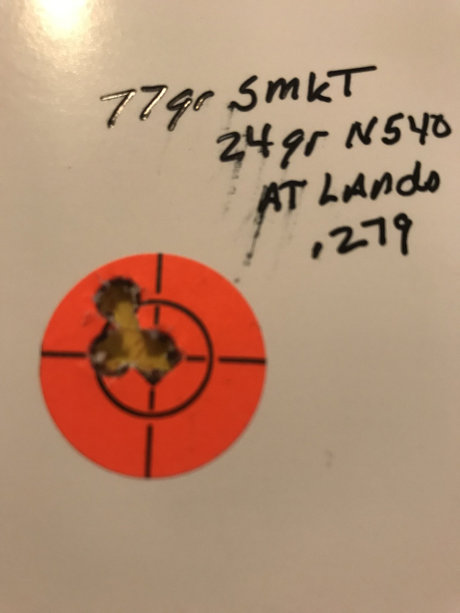

Was back out yesterday with it and here are some pics of the combinations I'll be spending more time with. I tried the 69 gr smk's and they are not as tight as the 77's for me. The 55 gr sierras show some promise. That group of those is the lightest weight I've tried.

I do not have a chronograph so until I'm able to hook up with my buddy who has one, I won't be able to give data on velocity. The barrel on mine is 20". So far what I'm seeing is that it likes the heavier bullets close to the lands. N540 & TAC seem to provide the most consistent groups with the 77 grain tipped match King heads.

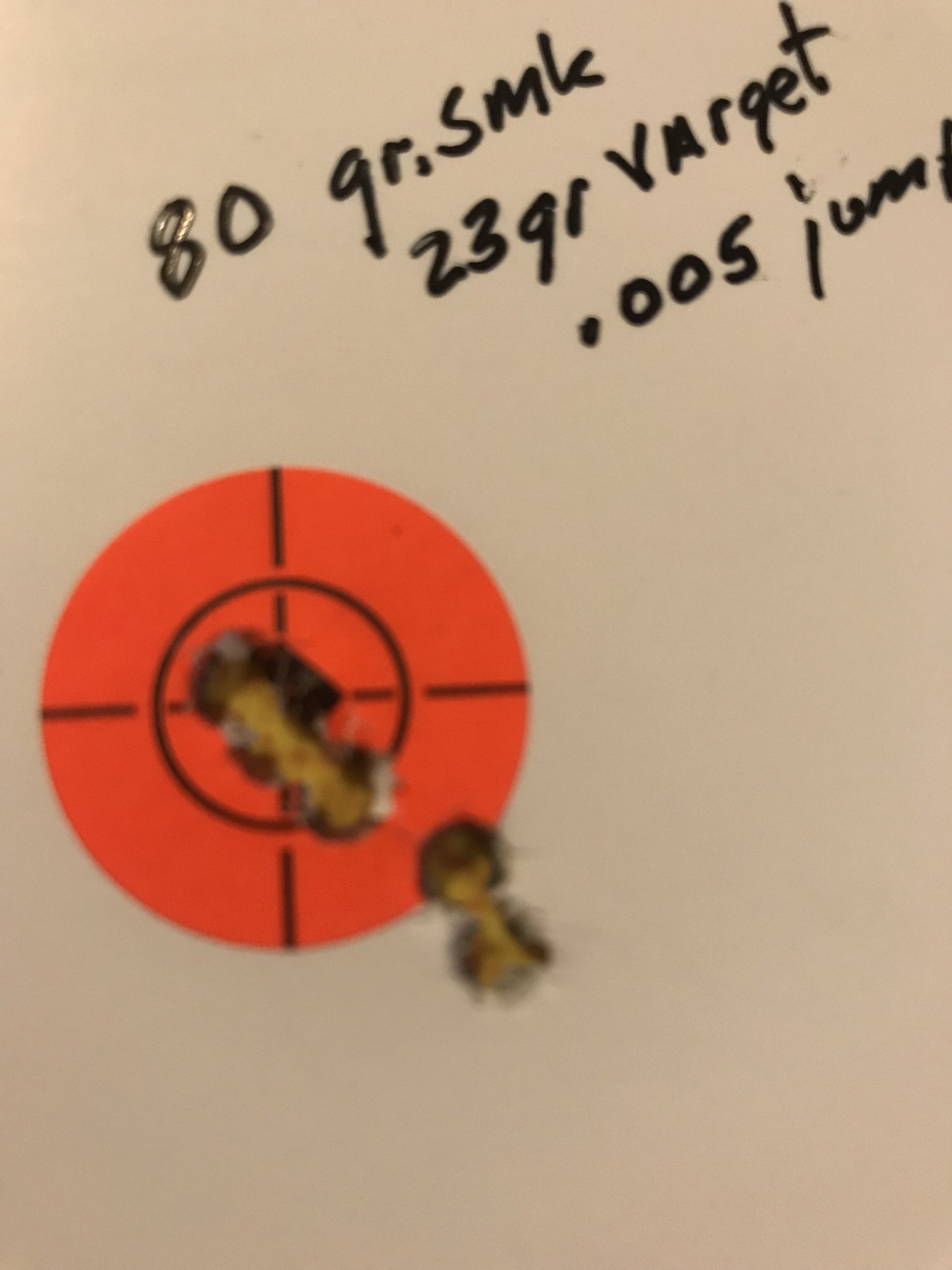

I did load 5 of the 80 gr. Smk's with 23 grains of Varget. The pic of that group is posted below and I only jumped them .005. I intentionally went with a light charge of Varget as the COAL measurement was 2.371 to the lands, which is a fair amount shorter that the COAL of 2.550 that Sierra recommends in the manual I'm using. There were no pressure signs with this combination so I've got room to work if I continue to test those. My total round count in my Tikka is 85 so far, so I'm still getting used to it and am very pleased with what the Tikka is showing me. I was able to get my hands on some Lapua brass and am going to see how it fares as compared to the Winchester brass I've been using. That all being said, I've got a lot of the 77 gr tipped match kings on the way and am going to do some 300 yard ladder tests off the bench when the weather improves.

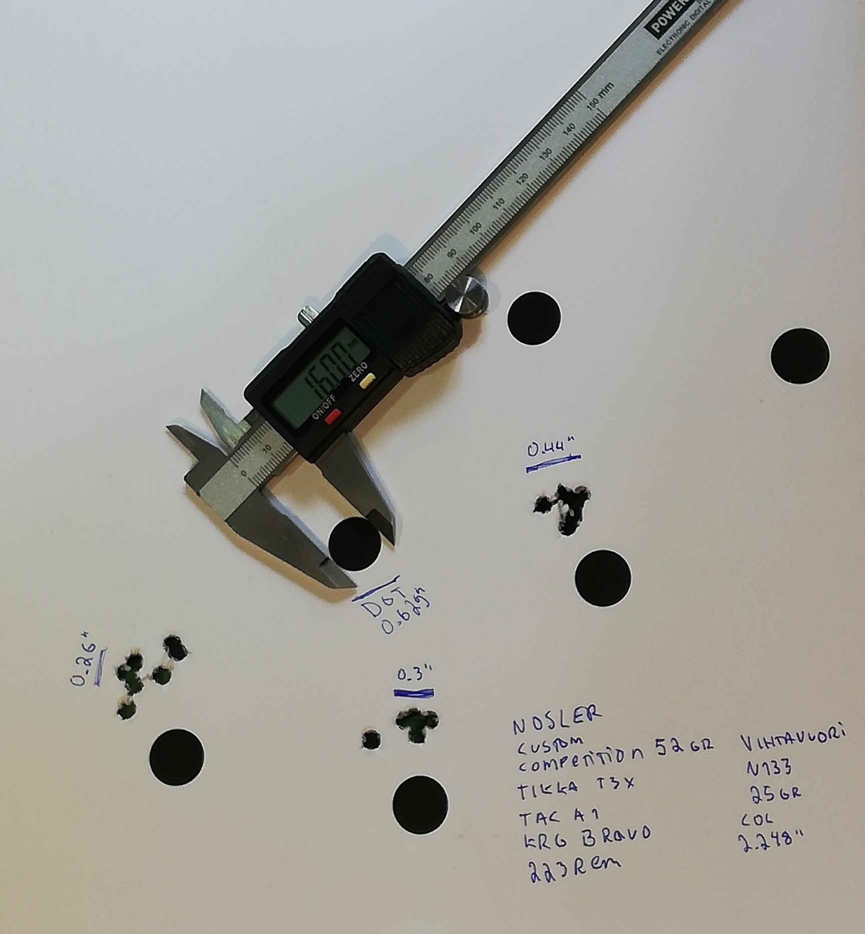

A friend told me to try Nosler Custom Competition 52gr bullet, hi told me that his varmint Tikka likes it a lot.
So i bought a hundred of these pills and loaded some of these yesterday.
I used Vihtavuori N133 powder.
Sweet jesus, this bullet is accuracy.
5-shots at 100-meters.
On the left dot i shot 10 rounds.
7053310

I have N135 too, but though that the faster burning N133 would be better.
This was the first test load with the 52gr Nosler and straight to the goal :)
Now i try Sierra matchking 52gr bullet with N133.

52gr Nosler custom competition Vihtavuori N133 25gr COL 57,19
Same for the Sierra Match King
Hornady ELD match 52gr N133 25gr COL 57,40mm
I did cut the barrel to 18", so im not sure how does these loads work on my rifle now :)
