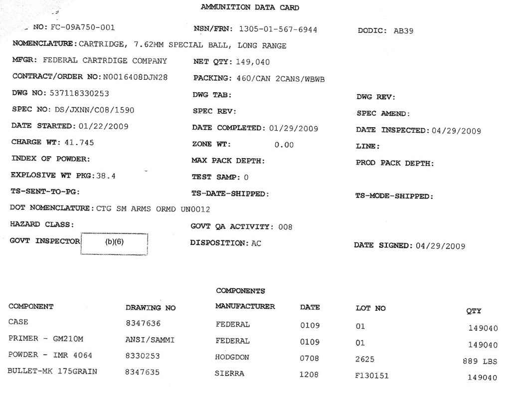

<div class="ubbcode-block"><div class="ubbcode-header">Originally Posted By: jeepnjc</div><div class="ubbcode-body">thanks to everyone that posted, some where spot on, others where on the old recipe.</div></div>
The "old" recipe?
The Reloader 15 load is still current for M118-LR.
The "New" recipe that uses IMR 4064 is MK316 MOD0 and it also has a crimped primer.
The reason for the crimp is to decrease the likely hood of a primer becoming dislodged and causing a stoppage in "Gas Guns" such as the M110 & SR25 SWS.
MK316 MOD0
Brass: MILSPEC version of Federal Match Brass with a crimped in primer (Head Stamp is FC + Year of Manufacture.)
Primer: Federal GM210
Charge: 42.7 grains of IMR 4064
Projectile: 175 Grain SMK
Target Velocity: 2650 fps
MK316 MOD0 is the heir apparent to M118-LR
The purpose of this cartridge is to create a round that has more consistent lot to lot accuracy,
be less affected by temperature than current M118-LR ammunition that is in service,
have a low flash signature, and be compatible with gas operated sniper weapon systems.
NOTE:
If one was to try to clone the MK316 MOD0 load, the charge weight would likely need to be adjusted to account for case volume.
This would not be an issue is one were to use actual MK316 MOD0 brass however.

M118lr
I came up with this some where, it speaks for its self.
I pulled down some M118LR ammo I had to check out this very thing.....can't guarantee its reloader 15 but it does look like it. Out of 10 rounds pulled down the powder charge varied from 42.3 to 43.2 gr.
Seriously? I wouldn't think you'd find near a full grain of variance in the same lot of ammo. Or are you talking different lots? Or is that a typo?
Dan
It was not all the same lot....there were at least 3 different lots which was the whole point....I suppose I should have added that in there to avoid confusion.
