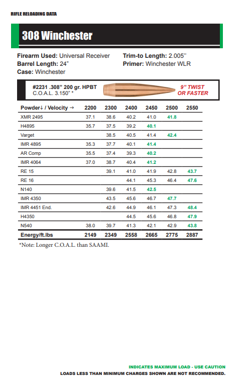

Sierra 200GR BTHP MatchKing
Hornady 220GR ELD-X
Hornady 225GR ELD-Match (Concerned that I need a faster twist rate.)

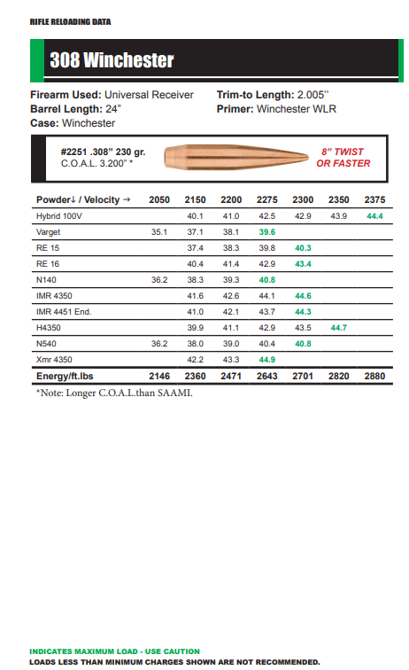

Sierra 230GR BTHP MatchKing (Concerned that I need a faster twist rate.)
For the two Sierra rounds above, Sierra's load data is suggesting a 3.150" and 3.200" C.O.L., wont know what I can get til I check the max seating depth for my rifle.
Anyway bellow is the Sierra load data.

I would bump down to the 195gr ELD max for your application. You should be able to get good speed out of it if your rifle likes to shoot them. I wouldn't bother with the very heavy bullets. You'll need a throat cut longer to fit the bullet in with with as much powder in the case to push it at a decent speed. The guys in the U.S. have purpose built barrels that are 30 in long with a 1-9 twist with longer than normal throats for the heavier 308 bullets. They are single feeding them.
I would load the 178 ELD match bullet or the 178 ELD x and be happy with it. They can get to 1000yds and beyond with no issues.
If you want to shoot the heavier bullet in the future buy a 300 Mag then.
Keep us posted on your reloading ventures
