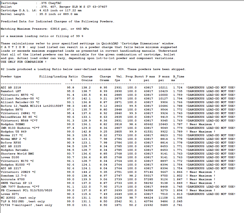

.50BMG-specific powders like Reloader 50 and Hodgdon 50BMG look promising
You could also email Berger and ask them for load data for that bullet/cartridge combo.
