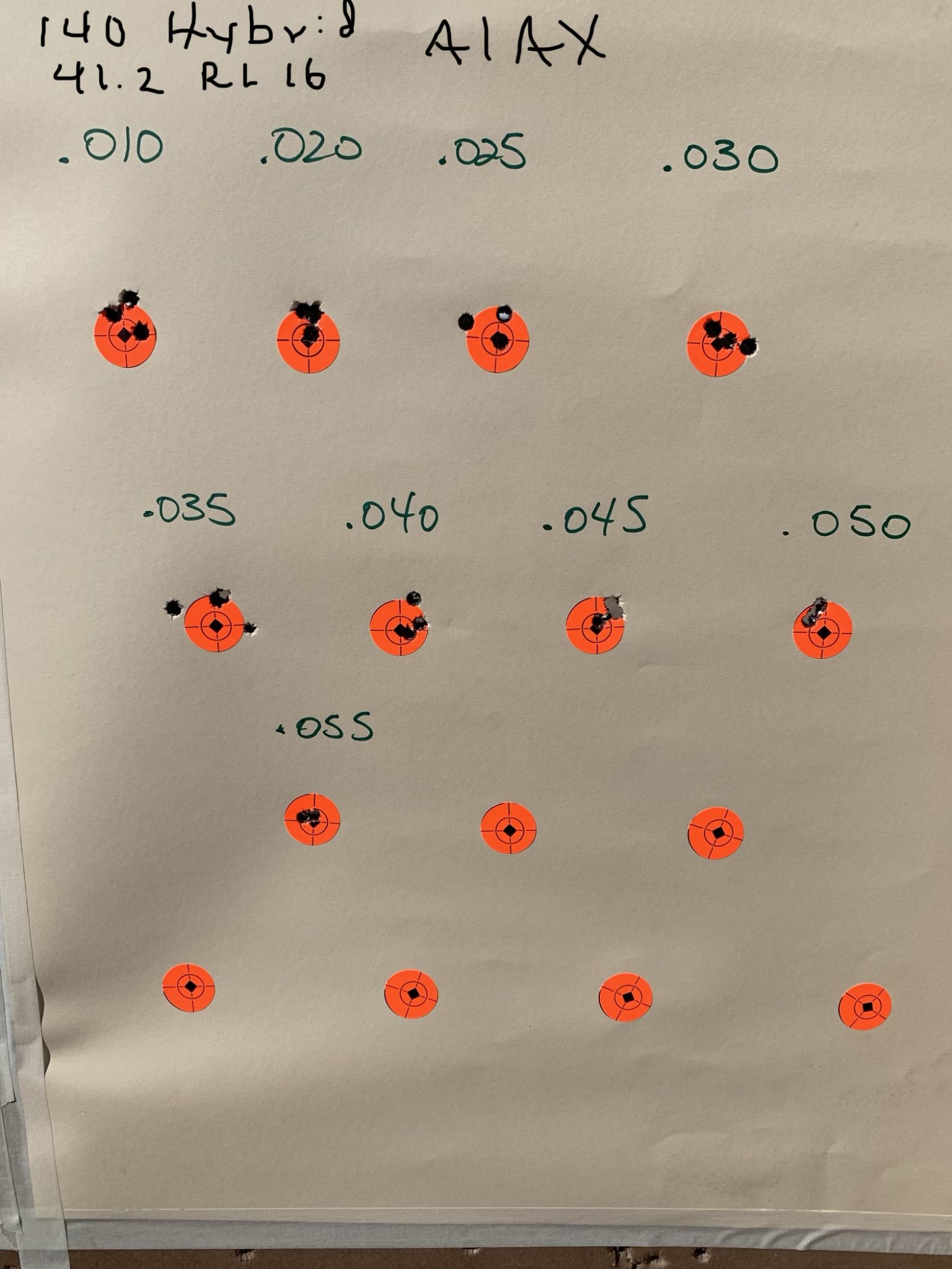

I'm loading these Berger 140's and I'm wondering how much you are jumping this bullet off the lands? They are pretty long and I tried jumping them .020 off the lands, but they do not fit in my magazine. I ended up jumping them .070 to get them to fit in the magazine. I've yet to be able to test them for accuracy other than using them in a match.
I just wanted to see what everyone else's results were.
Thank you,
I've worked up loads for about 8 different 6.5 Creedmoors over the last few years, all shooting 140 hybrids, and all have shot best with the bullet jumping from .040" to .080". Most of those rifles were capable of being mag fed with the bullets seated to the lands. If memory serves me correctly, two had mag length restrictions that required a jump of about .020" to feed consistently, but they also shot best with some jump.
From everything that I've seen, they are very jump tolerant. The pic below is a seating depth test I did with my AIAX 6.5 CM and 140 Hybrids a couple weeks ago. You can see how the groups start to tighten up past .040" jump.
(Disregard the small hole at 3 o'clock on the .035" target. The was a ricochet from someone shooting one the lane beside me.)
