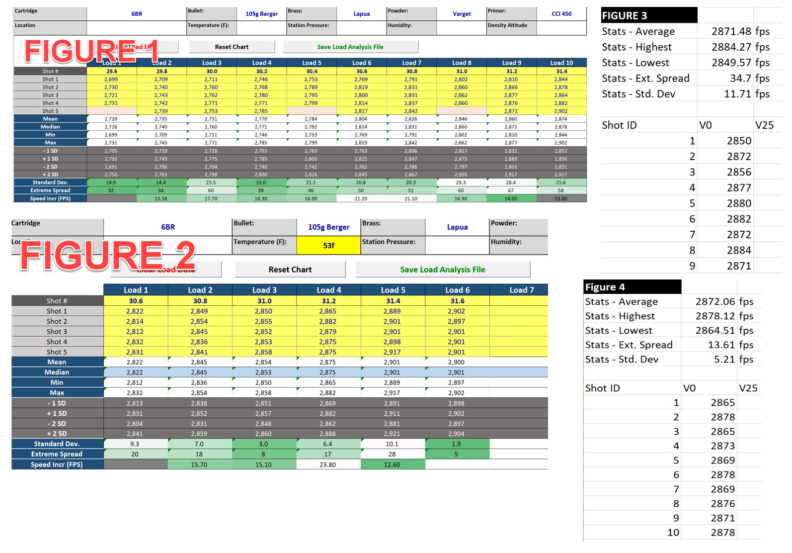

So here’s what happened. I was replacing a burned-out barrel (Brux). Breakin process; ran 200 rounds through it, cleaned it at the range, ran 20 more rounds through it, then did my load devolvement (Figure 1). The results were much slower than the previous two brux barrels. So, I did another load development test (Figure 2). This was better (SD/Spread), but the MV speeds were higher than normal or what I was expecting. Later that day, I ran more rounds past my lab radar, and it was different again (figure 3). Finally, the next day at 300+ rounds I clocked ten more rounds and it seemed to normalize for a BR/Brux (figure 4). The SD/EX Spd at 31.6 (fig 2) is really good but I heard that crunch noise and that concerned me a lot, so I backed down to 31g. Im guessing it took more than 200 rounds to break in the barrel. My last Brux was 30g varget at 2,830. At this point, I'm not doing another load dev, I'm going to stick with 31g @2,870 as long as another labradar shows consistent results.
That’s more varget than I put in my dasher and faster…
Crunching by itself doesn’t hurt but that much powder in that case might.
I did load about 10-15rounds at 31.6. I just want to fire them off w/out doing any damage to the rifle (or me), so I can reload them next time around with 31g. Sounds like that is okay at this point.
Dont quote me when you say it sounds okay. Thats certainly not what Im saying but you do you.
Reactions: Drewdemon
31.6 is of varget is close to my Dasher load (31.8.) I'd probably pull the bullets and work up a BR load closer to 30gr and 2750-2800fps myself. Better to be safe and not trash your brass.
I concur with tyler. I know probably 30 or more people that shoot br and none of them are over 30.5g. Its your rifle but youre probably pushing your luck
