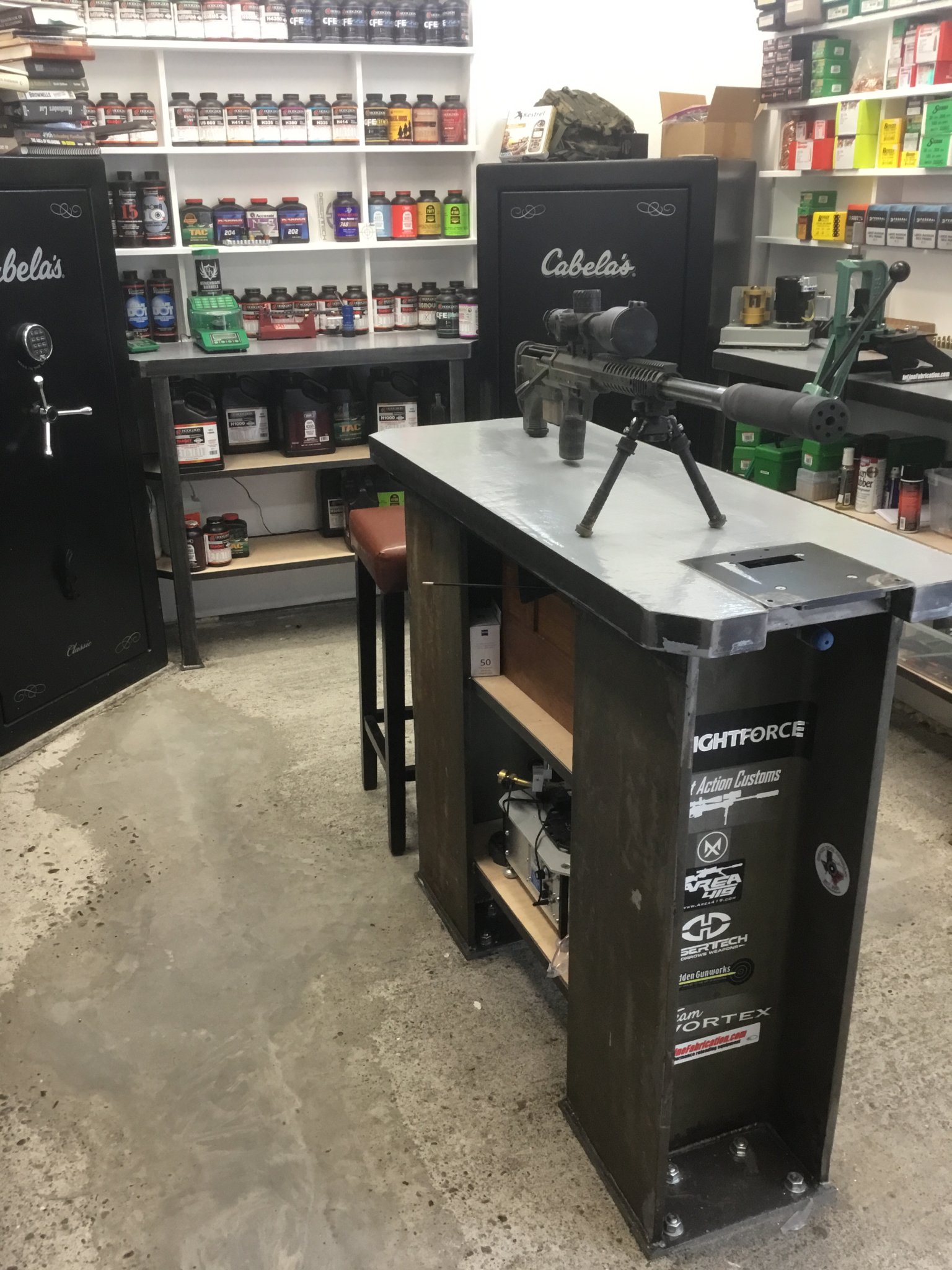

Ok. Just had a chance to look at all of this. I have been through the reloading room thread. Not too many ideas that got me excited. I do like the idea of the resin top with some incra rails embedded for quick detach. Currently I am thinking of an island that is 3' x 7'. I have always had a super robust counter to mount to, so never had to worry about it moving. How much weight to keep it steady on locked casters? The room has plenty of storage (15' of tall lockers and a gallowtech system for guns). I like the pic below, but don't want it bolted to floor.

How come every time I see pics of other peoples reloading setups...they have plenty of powder and bullets and I can't find Retumbo/Reloader26/H1000 in stock anywhere to save my life.
Are these bottles full?....or are they all empty and just for show?
Also...those I-Beams mounted to the floor....dang you put some serious weight on that...probably put both of those safes and my ex-GF on there and still be able to throw a car or truck on there to work on.
I can always use more bullets , powder, primers. Lol.I have plenty of h1000 but am down to some 1lb bottles of retumbo. Full or empty, come on, really? A friend brought a rem of a soldier Pyle/steel I-beam over on a car trailer. Made up two post out of it , I welded some base plates and anchor bolted it to the slab. I fabbed the island/benches with mostly 2x2 and 1 1/2 x 1 1/2 angle. Slapped some pan in it , pored concrete , applied the garage floor epoxy on top to seal it. So far it hasn’t pealed ect from gun oil solvents ect. It took me a long time to build this reloading room , still a few small things to do. I out grew my really small old reloading room . It would get messy easy, just to much stuff in a small spot. The old room had barely room for two single stage presses.
